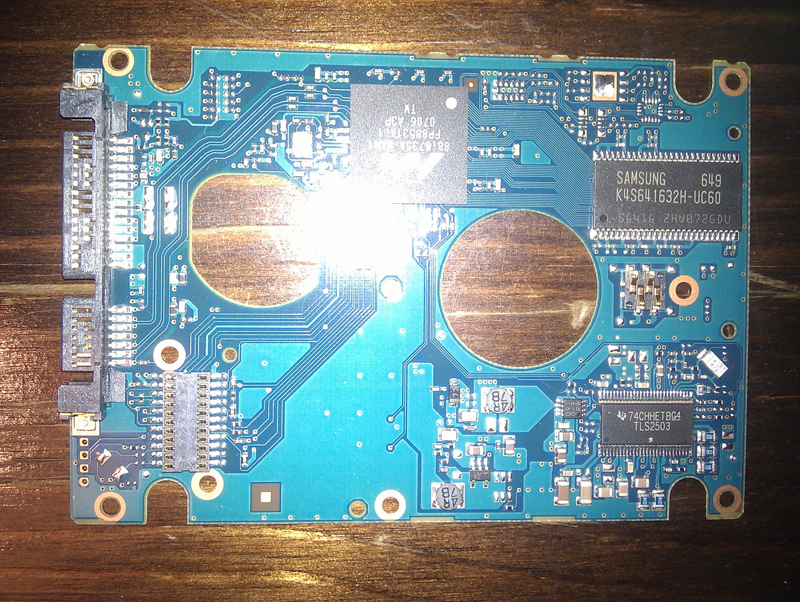

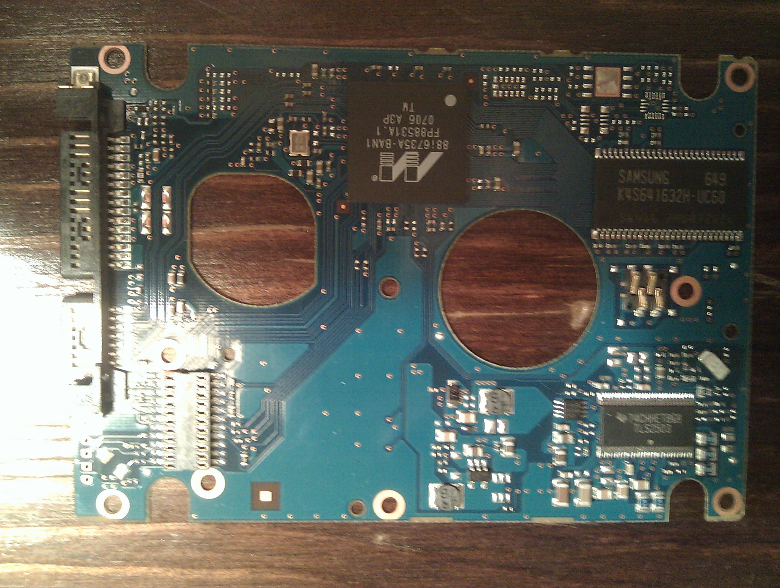

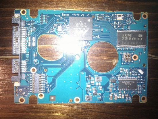

Sorry I didn't post details earlier.
No software will detect drive, including Disk Utility.
It powers on, spins fine, just doesn't mount. No clicking, weird noises, heat, etc. Everything appears normal.
Here are pics of board. Sorry couldn't get 1 good one.

I don't think it's a PCB problem. I think it is bad heads w/ possible media damage.
http://www.datasaversllc.com
 Post subject: Re: Corrupt Fujitsu Firmware :(
PostPosted: February 4th, 2011, 11:36
Posts: 1419
Agree, its not a PCB problem.
www.datarecoveryne.com

I'm guessing it is because we see drives like this often and the symptoms you describe typically (read: not always) have the causes that I describe . . .
Passport info on these are stored on the platters. No read = no I.D.

rtech wrote:
Bios won't recognize the drive so I didn't think the issue was bad heads.
The drive needs to retrieve the bulk of its firmware from the platters. A bad head may prevent it from doing that.
