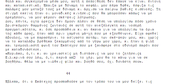

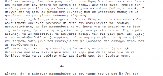

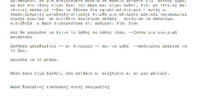

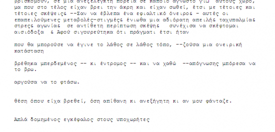

I have recovered the file for you. It looks like it is a book written in Russian, starting from page 44 of the book. See the attachment. The data has been scrambled by some other files and all the OLE2 data streams are disordered.
But I think the full text content of the file are still intact.
I don't think you can use any WORD repair software to fix it because I did it manually. The size of the file has 122 pages in Word.
If you are still interested in this file, please message me. See the attached picture to confirm the content. The first pic is the last page , the second pic is the first page of the content.

tckin wrote:
I have recovered the file for you. It looks like it is a book written in Russian.
FYI it is greek.
I disagree, there are several large gaps in the page numbers and multiple locations where the "GV110105" header & data and other data have overwritten portions of the file
Having said that, there is a large amount of data still present.

drc wrote:
The original Word file is a fragmented file. The reason of ''several gaps'' is because there is more than one Word document in this damaged file, if you can figure it out...
The file header in this damaged file is NOT important at all. The first sector can be rebuilt according to the MSAT, SSAT, SAT, DIR.
DR Research Engineer
 Post subject: Re: repairing a word document
PostPosted: February 2nd, 2011, 10:17
Posts: 3235
Location: USA
Ok. I would not personally have called a document that starts at page 44, is missing pages 47-56, 84, etc. complete... but I guess that is only for the OP to say.
