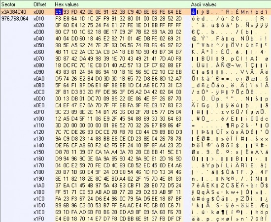

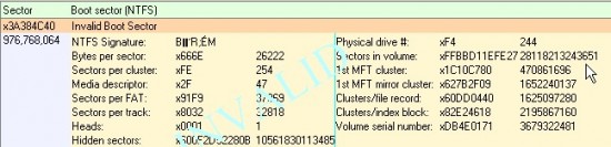

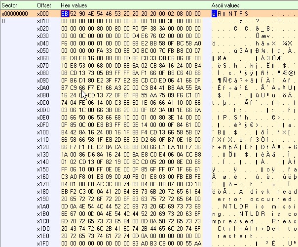

Update:

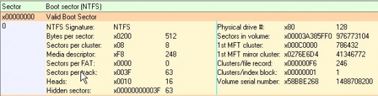

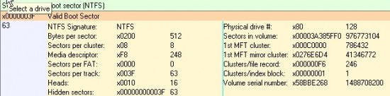

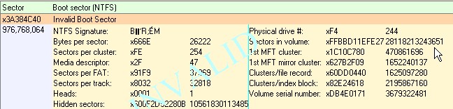

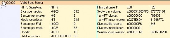

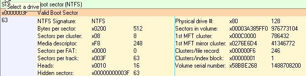

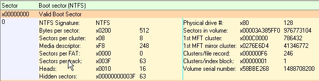

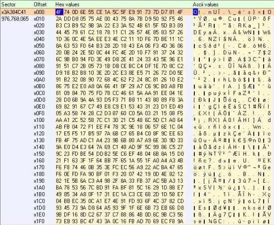

Here are some screen shots of Sectors 0, 63 and 976768064. Still doesn't appear to be correct and I am still at a loss as to what to do next. Bare in mind that I am working from a 466GB image because the victim drive is FUBAR with a burnt up PCB. If I could locate a valid replacement and swap the MCU to get the drive up and spinning my testing would be more productive...Happy New Year everyone!!!!!!!

 Post subject: Re: WD5000AAKS-00TMA0 Caviar SE16

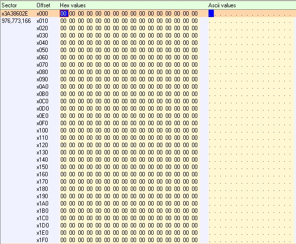

PostPosted: January 8th, 2011, 17:15
Posts: 17232
Sector 63 is an NTFS boot sector. Sector 976768064 is a copy of sector 63, as expected. Therefore, it appears that the "sectors in volume" figure of 976773104 doesn't match the actual sectors in volume, which appears to be 976768002 (= 976768064 - 63 + 1). I would check sector 976773166 (= 976773104 + 63 -1) to confirm that it does not have a boot sector structure. I suspect that sector 976768065 would be the boot sector of the second primary partition, or the EBR of an extended partition. Could we see a hex dump of its contents?
If the above checks out OK, then you would need to edit sectors 63 and 976768064 so that they reflect the correct volume size.
We would also need to see sector 0 displayed as an MBR and partition table, not as a boot sector. Better still, can we see a hex dump of sector 0? I suspect that FIXMBR may have corrupted the partition table.

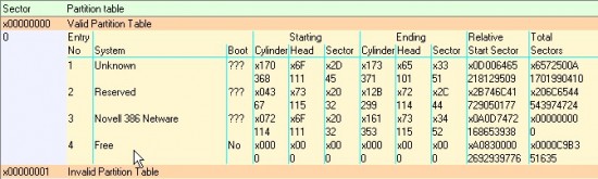

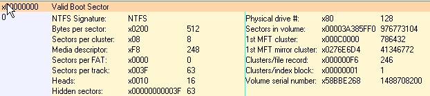

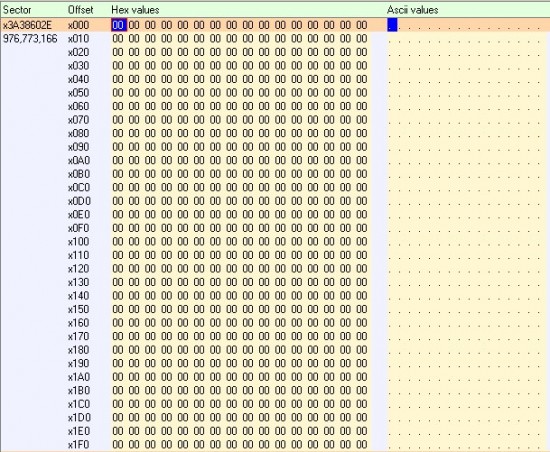

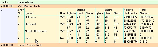

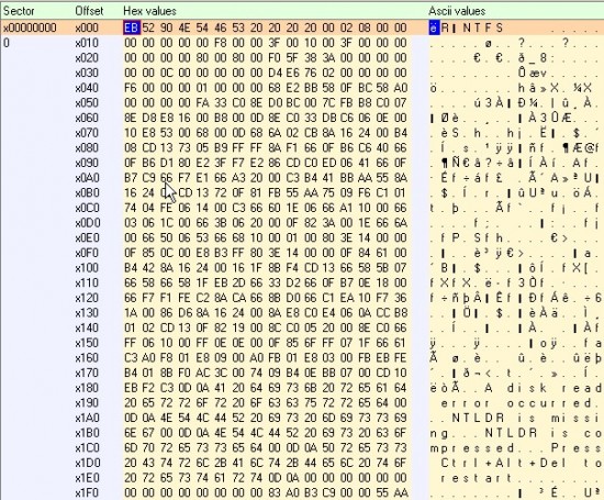

Thank you! I have enclosed screen shots of the sectors and views you requested and you could be right about FixMBR jacking things up. I will continue working on this as long as you are willing to assist me. This whole mess is my fault and can be attributed to "dumb" operator error!
Thanks again for your dedication...

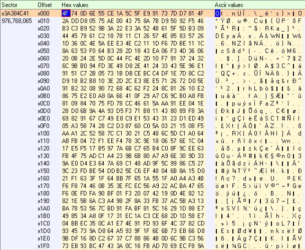

PostPosted: January 9th, 2011, 16:45
Posts: 17232
Sorry, I've had a massive brain fart. I have misinterpreted your sector numbers. Your first screen shots display sectors 0, 63, and 976768064 in reverse order. I have interpreted them in numerical order, as in your text.
Let me get my brain back into gear and I'll get back to you.
PostPosted: January 10th, 2011, 6:06
Posts: 17232
I'm confused as to why sectors 0 and 63 are both boot sectors.
You say you imaged drive G:.
If the image file is an image of a physical drive, then sector 0 would contain an MBR and partition table. Sector 63 would be the boot sector of volume G:, ie logical sector 0.
If, OTOH, the file is an image of a logical volume, then sector 0 would be the boot sector of volume G:, ie logical sector 0. In this case logical sector 63 should contain some other data, unless I'm mistaken. Furthermore, if there are 976773104 sectors in the volume, then sector 976773104 (or 976773103?) should be the backup boot sector. You may like to examine both sectors.
In any case, I believe you should follow drc's advice and search for the backup boot sector in your image file. Work backwards from the end of the file and look for an "NTFS" text string or, better still, search for the hexadecimal sequence that marks the beginning of an NTFS boot sector, ie ...
EB 52 90 4E 54 46 53

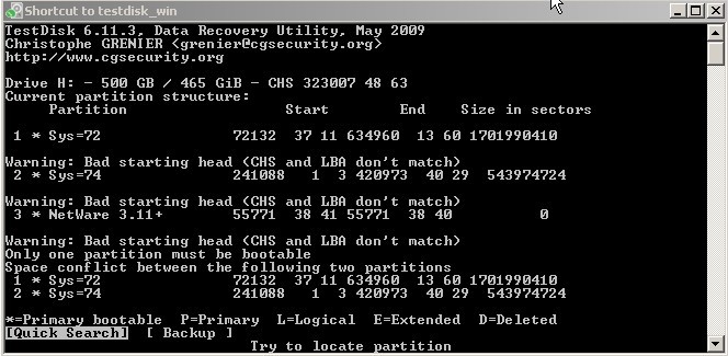

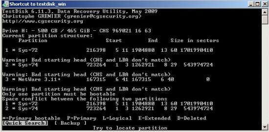

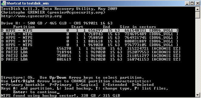

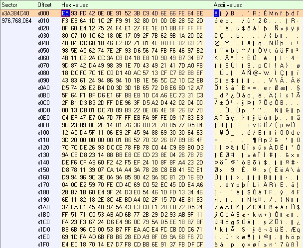

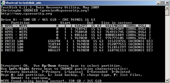

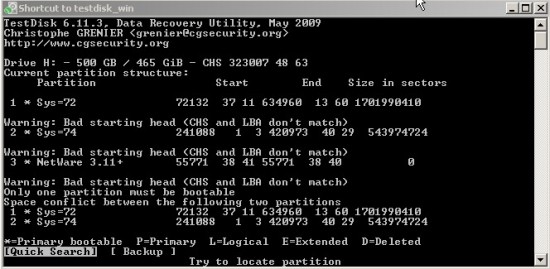

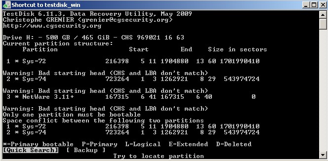

OK Guys...Been away awhile but a lot has come to light on this recovery process. Long Story Short- I sent the drive to Gxxxware on the assumption that they could retrofit a working PCB to get the drive spinning again. Meanwhile I ran PhotoRec on the image file and found almost 90% of my files. Every file on the disk was in .RAR format. The directory structure was not available so I spent several days sorting through triple or quadruple copies of each file. Needless to say this was very time consuming because there were hundreds of thousands of files. While doing this I heard back from Gxxxware and they stated that my drive would need to be opened up in clean room due to platter damage at the cost of $1200 plus. I declined of course and asked that they return my drive. Back to the recovery...since I only recovered about 90% of my files I ran TestDisk (TD) on the image to try to salvage the directory structure and have hit a brick wall again. It seems that TD has found multiple instances of my partition and says I have a "Bad Root Cluster" on the partition. I have attached a few screen shots for everyone to look at in hopes of a finding the next direction to head. The image is scanning as I write this. Thanks everyone.
