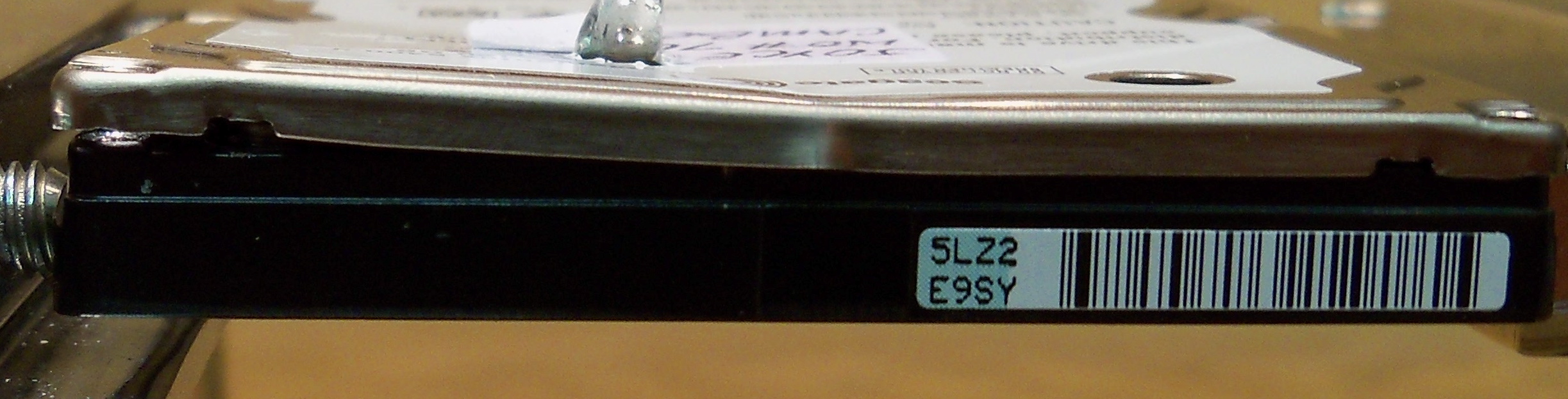

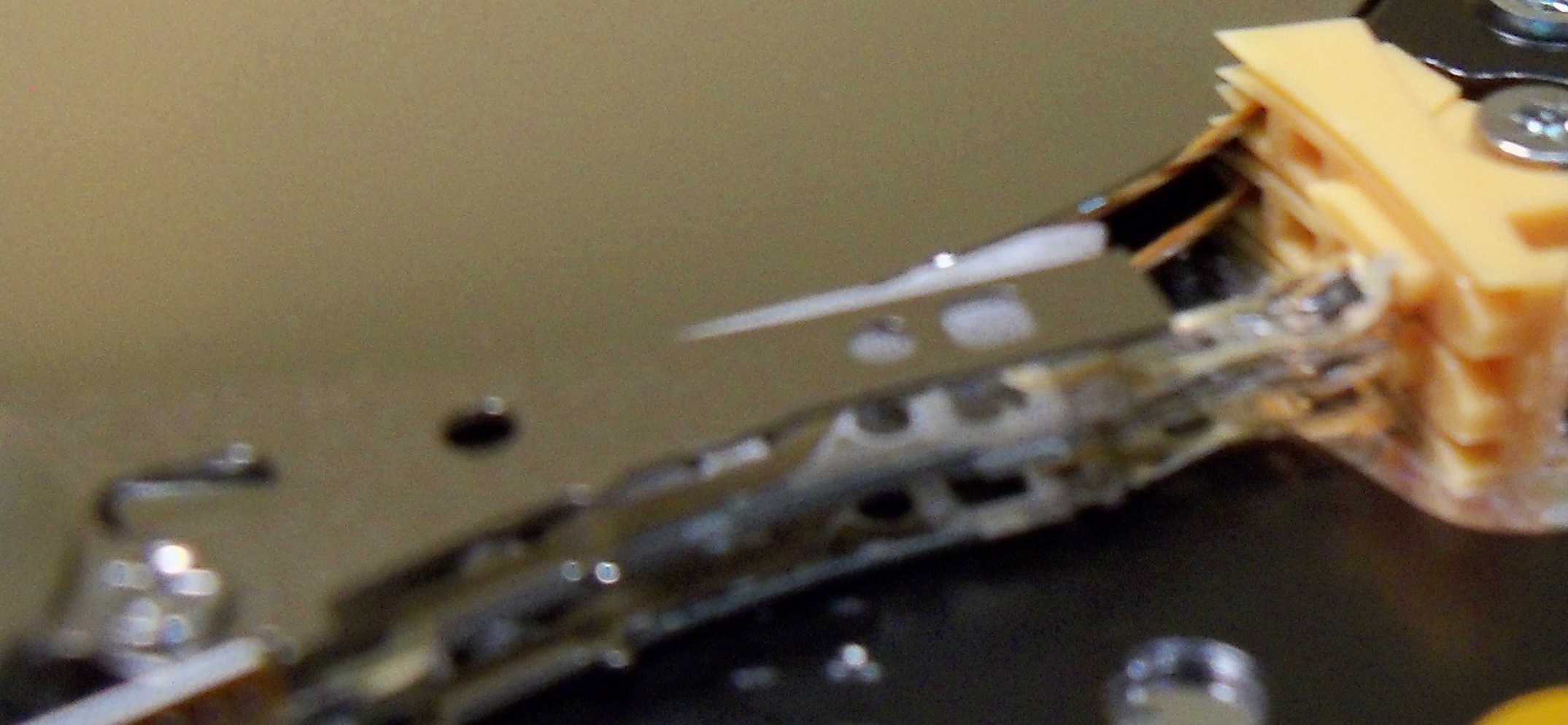

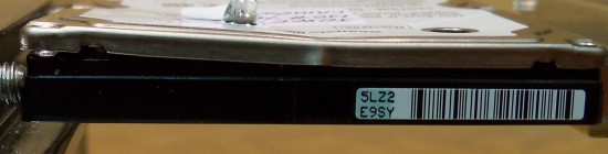

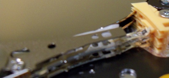

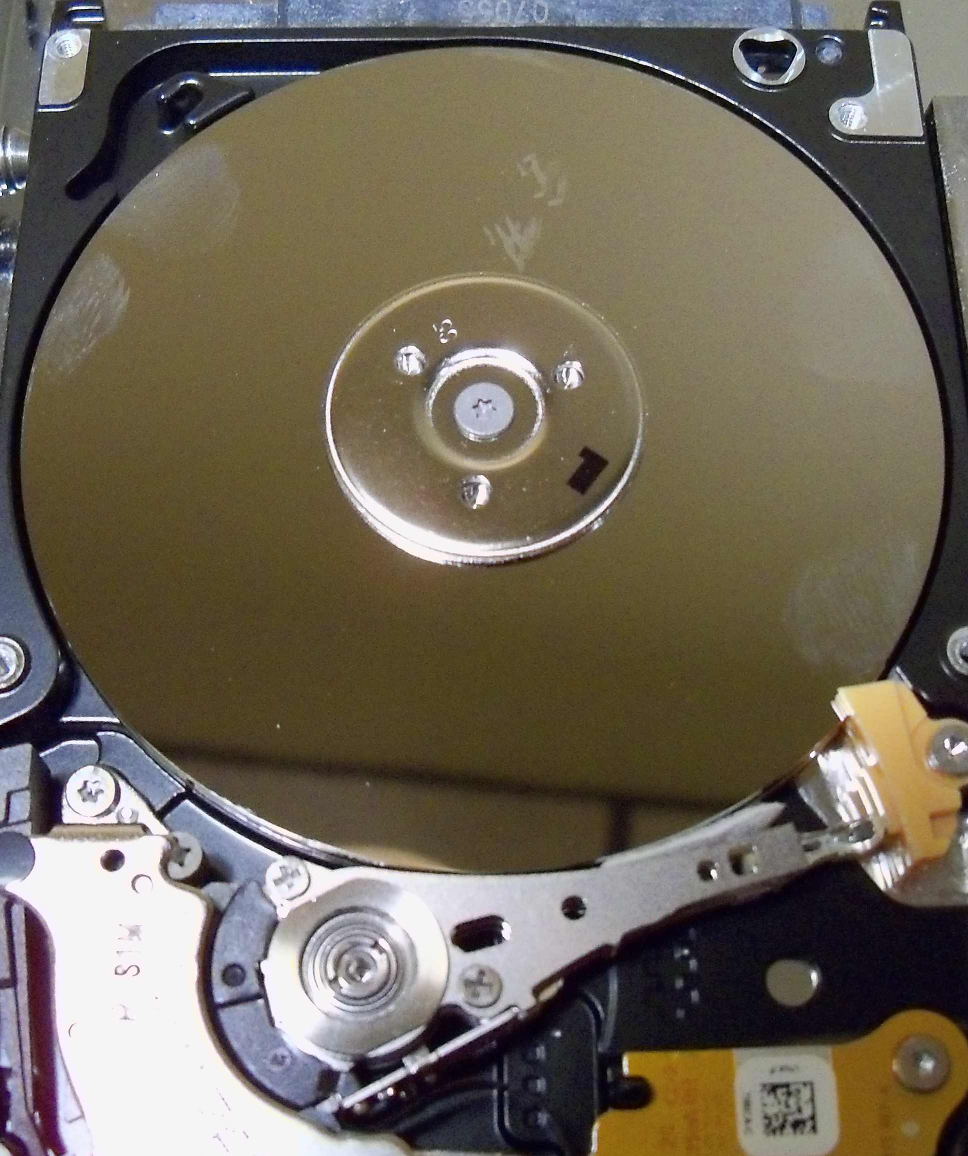

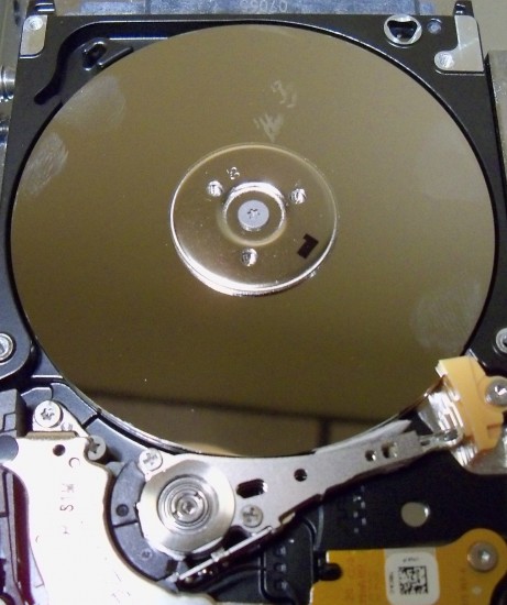

It kills me to see a drive come in like this. If only we had first kick at the can. Now I cannot even guess what the original problem was...I don't even know if the platters are in the right order. (I suppose I could check and see if there are prints on other surfaces, but that really doesn't matter too much at this point.)
Notice where the filter is located between the heads and the platters:
Gotta like the nice curve on the cover, which was pushing down on the platters when it arrived:
I guess it is safe to say that it was opened in an unclean environment:
For those of you who recommend DIY, if you cannot afford it. It is always best to get the free assessment first...'cause there isn't any going back after this.
