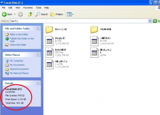

On my external hard disk the files name is changed to bad characters.
See the image in attachments.
I used chkdsk /r but now all files disappeared.
When I see disk properties the disk space is right free space and used space, but cannot see any file on hard disk.
Only there is hidden folder name Found.*
Help pleases..

You probably have a hardware problem (e.g. bad data line). Running chkdsk was a very bad idea.
You have to diagnose and fix the underlying hardware problem (if any) before you address the software issues.

Clone your drive and use data recovery software on the clone. If it's a logical problem, then you won't need professional recovery services.
OTOH, if your drive has bad sectors, then use a cloning tool (eg ddrescue, dd_rescue) that understands how to work around them.
BTW, it doesn't sound like a hardware fault. A "bad data line" would prevent you from seeing the drive. In your case you can see the MBR and boot sector.
