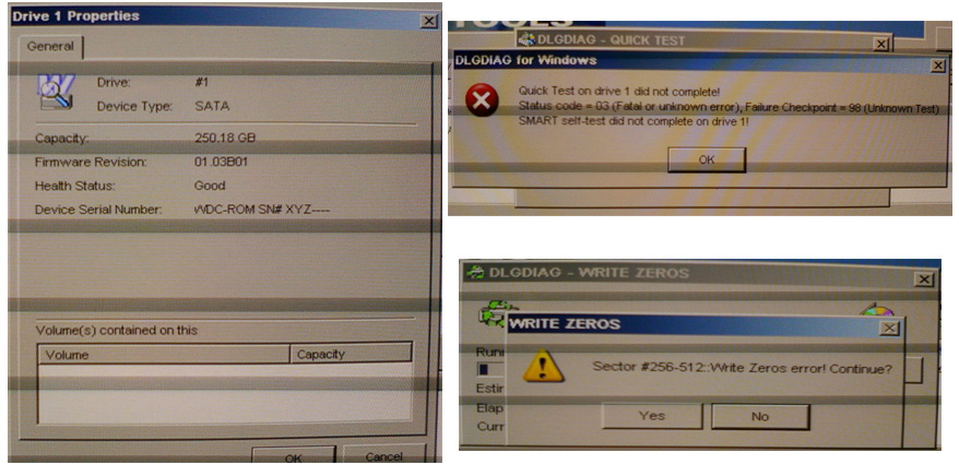

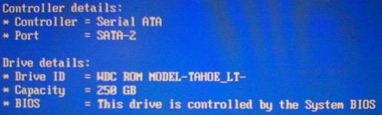

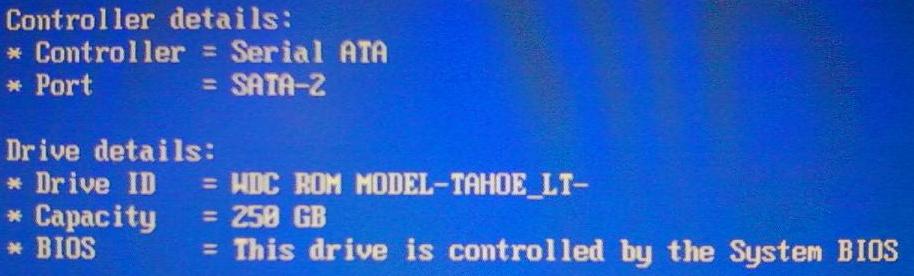

The situation is worst, yesterday I connected the drive and recognized only the half of the capacity of the unit. I attach you images with the different tools that I used.
In the BIOS show the same. Only the half of the capacity.
File comment: In BIOS

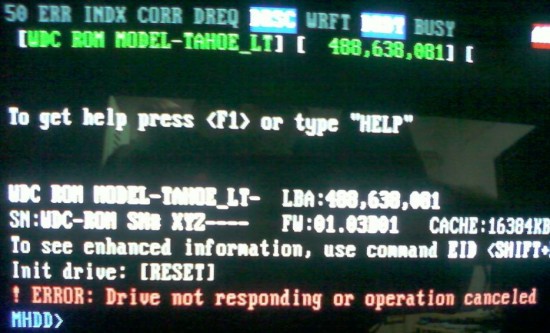

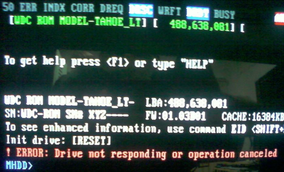

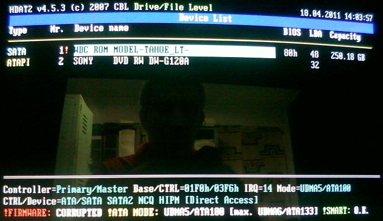

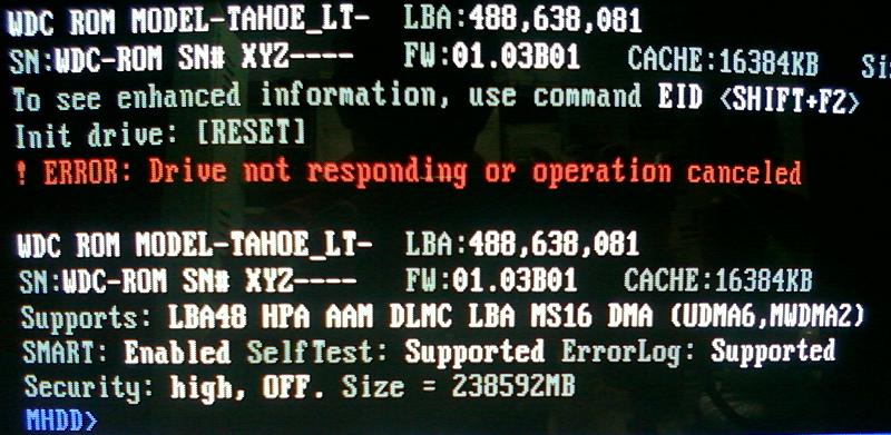

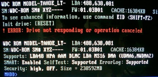

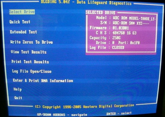

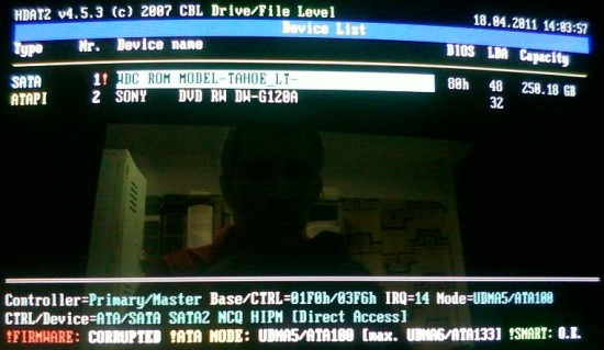

I used HDD tools that are contained in the "Hiren´s BootCD 10.2", mainly "MHDD 4.6", "HDAT2 V4.5.3", and the "Western Digital" tool what the CD brings.
File comment: MHDD 4.6, selecting the drive unit
File comment: MHDD 4.6, reseting

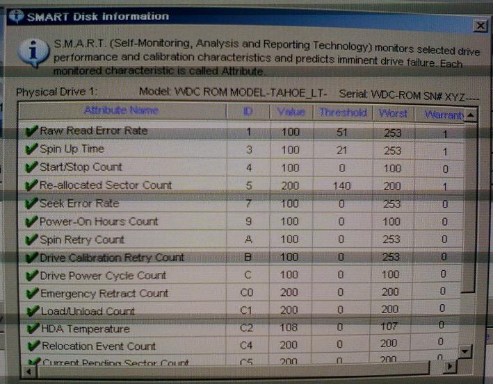

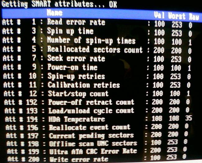

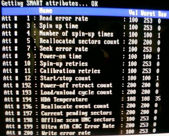

File comment: MHDD 4.6, getting SMART
File comment: HDAT2 V4.5.3, searching unit

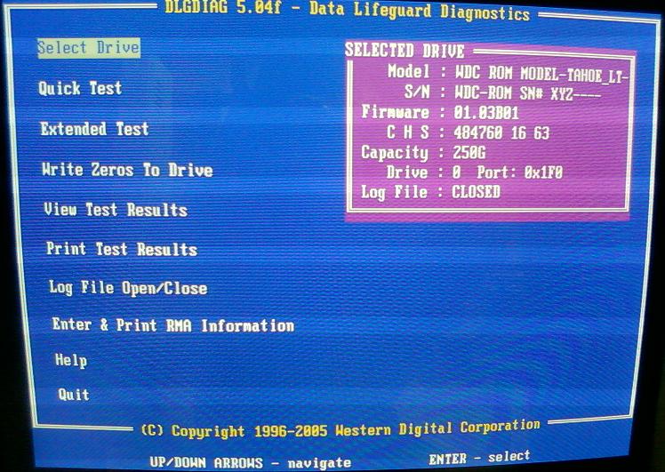

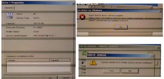

File comment: Dlgdiag

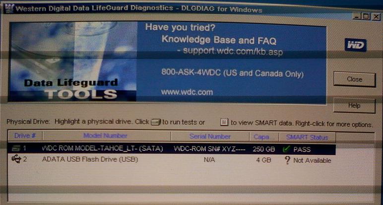

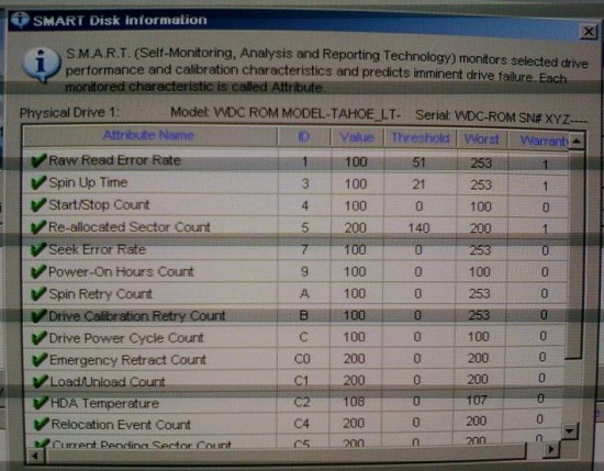

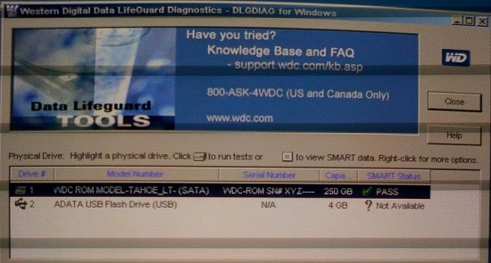

Besides I downloaded from the WD site, the last version of Western Digital Data LifeGuard Diagnostics for Windows and I attach you the results obtained with the tool.
File comment: WD tool in windows
File comment: WD_WINDOWS-SMART Test
File comment: colage with various options and errors in WD for windows

The drive is not initializing fully. Assuming it has not been tampered with, there is a fault with some aspect of the drive. Could be pcb, firmware, heads, etc. You need a real diagnosis.
On a different note, this drive is basically brand new and should be covered under warranty.

@pilloypf: Thanks for getting the info that I requested. As drc has kindly already replied, these do not prove that there is a f/w problem - that is just one possibility for the drive not fully initialising. But whatever the true problem is, it is not a DIY fix for you. :( If you want a full diagnosis, you will need to take it (or ship it) to someone with the skills & equipment to diagnose it - that may cost more (including shipping/travel) than buying a new drive.
Out of interest, how long has this drive been in use already?
@drc: You mentioned: "this drive is basically brand new". I expect you're (very understandably) getting that view from the MHDD reported SMART values - e.g. power-on time showing a raw value of 1, start/stop count showing raw value of 1 - yes? However, I bet those values are erroneous and are due to the values from the SA (i.e. the real values) not being read - I've seen a similar situation before, where the SMART values reset every power-cycle. Considering that the OP has already done previous tests on this drive and has been using it for some time (see the OP's second post), I just don't believe those SMART values e.g. the drive has already been power-cycled more than once, so the SMART info cannot be correct. Do you see what I mean, or did I miss something else that makes it certain that this is a new drive? Thanks. :)

@drc & DR-Kiev: Many thanks for your info, and I'm sorry that my question seems to have been ambiguous. :( I didn't mean the family of drive - I was concerned about the assessment that this specific drive was "brand new".
The OP has now confirmed it is 3-4 months old, and was previously in a media player. Therefore the SMART data shown by MHDD in image MHDD-SMART.JPG from the OP must be wrong since the raw value reported shows only 1 power-cycle since new! The drive must have had at least 3 power cycles, based on what the OP has said (first in a media player; second in a PC running the original tests before the OP posted the question; third, when the OP connected it again (so he says) and noticed it was only showing half the expected capacity). Even if we ignored that the OP says he connected the drive again, the drive must have had 2 power-cycles (media player & PC).
The same sanity check of the reported SMART data fails for the power-on hours raw value of 1 shown by MHDD, since it can't be sensibly used as a media player "playing movies" for 3-4 months, and have tests run on it in a PC, and still only show 1 POH.
That is my point - the SMART data shown by MHDD does not pass a sanity check - these counter values are as if the drive has not read its SMART history from the SA, as I mentioned before. That also fits with your analysis of SA issues.
