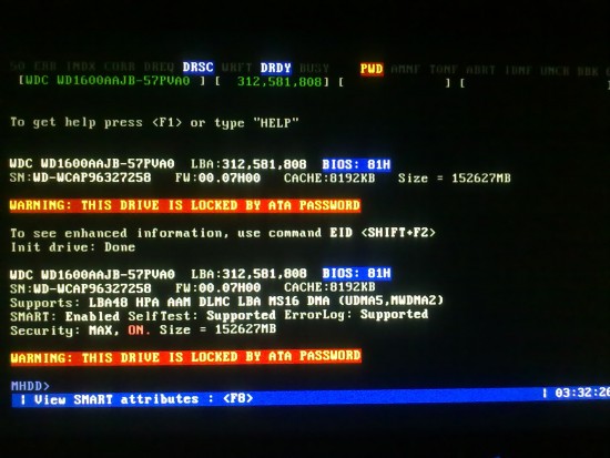

I did not know how I set the password. I was trying to give a zero-fill using wd utilities from Hiren boot cd. At one point I created a partition using the WD utilities setup and it creates me a 137GB partitionsetting LBA to 24(I think). After some struggle I managed to set the lba to 48 I set after I did it (I donțt remember what program I used) with MHDD I discovered that the HDD is password protected.
Currently WD utiities I do not work anymore, when I try to start it, I see the pointer for about 2 seconds and it closes.
Also my(gigabyte) motherboard may saved a copy of bios on it.
Searching on internet I discovered that a rewrite of the firmware may resolve the problem.
Help pls.
sry for my english.

You can unlock it in Windows. Use Victoria for Windows.
