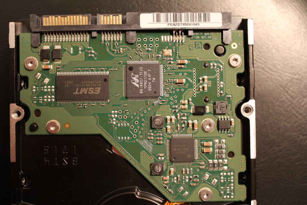

It seems that i need the precious help of this forum. I am new over here so be kind hehe. As the topic says i have a samsung 1.5TB hard disk and since yesterday its dead hehe.
I cant hear the disk spin up so there is something wrong with it. I thought that it could be some diode that died so I used a multimeter to test the Ohm resistance and it was 1 in both directions. I should mention that i am not an expert so i might not be doing something right but on the other hand its not that hard to measure the resistance ! The only thing that i could say that is weird is that I can hear the platters spinning if i rotate the hard disk which does not sounds all right does it? Could it be a motor issue ?
I dont know where to go on from here so let me know what you think!
Thank you in advance

I already measured the diodes as I said in my post above. Attaching an image of the board since it might help !
By "1", do you mean that the meter was indicating overrange?
Would you be prepared to measure some voltages? If so, upload a detailed photo of your PCB.

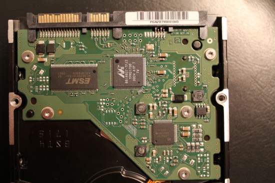

I have upload an image but it has to be accepted by the moderators !
Lets confirm that i did this right ! i used the multimeter, set it to 200 Ohm and checked the 2 diodes on the top corner both directions (meaning swaping the +,- right ?). The reading of the multimeter did not change a bit, it was 1.
As for the second question if i jiggle the hard disk i can hear a rattle even in OK hard disk but in this one i can here something rotating inside the hard disk.

I guess i should not have added an external image but instead use the features of the forums.
File comment: pcb board

Measure the resistance of the zero ohm link ("5V fuse"):
http://www.users.on.net/~fzabkar/HDD/HD103UJ_TVS.jpg
We are testing for short circuits, so stick with the 200 ohms range.
Now, with the board powered up, measure the voltages between ground and the load sides each of the two 4R7 coils. The relevant pins appear to be the top pin of the middle coil and the left pin of the bottom coil.
Also measure the voltage at the left pin of the black diode located to the left of the 1R2 coil.

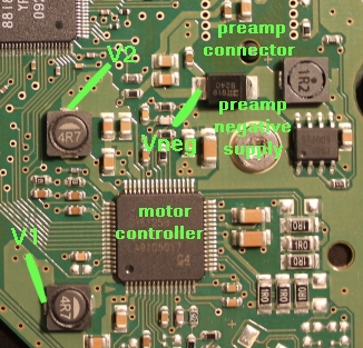

Measure the voltages at V1, V2, and Vneg.
Vneg is the negative supply for the preamp.
V1 and V2 are the Vcore and Vio supplies for the MCU and SDRAM.
File comment: HD154UI_voltage_test_points

The voltage at V1 is 0.47 while for the V2 and and Vneg is 0. Thanks for the schematic you are a legend !
Now it all makes sense hehe I can see the 4R7 and 1R2 stuff :)
What does these measurement tell us though ? That zero thing does not sound good something is not getting power right ? Can check or continuity for that cases. Will wait for your answer first though cause i am probably not saying anything useful here.
Thanks once more for your help
 Post subject: Re: Samsung HD154UI
PostPosted: February 22nd, 2011, 4:35
Posts: 17323
The combo motor controller IC (SH6125B) controls the spindle motor and voice coil. It also controls the three DC-DC converters that generate the V1, V2, and Vneg supplies. The fact that none of the supplies are functional would suggest that either the motor controller is dead, or one of its 12V or 5V supplies is missing.
I would measure the resistance between ground and each of the 3 supplies to confirm that there are no shorted loads.
Would it be possible for you to zoom up on the area in my photo clip? It may help me if I could see the underside of the PCB as well.
BTW, I believe Vneg = -5V, Vio = +2.5V, and Vcore is probably in the range of 1.2V - 2.1V.
