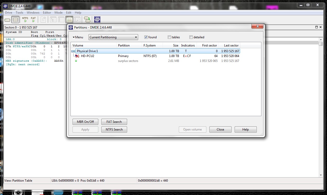

Hi, thank you very much!
I follow the thread, but i'm stuck in this situation... :(
What i should?
Thanks!!!

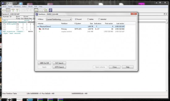

It's not clear to me what you've done.
Could we see the information behind the Partitions window?
Could we also see the contents of sector 64?

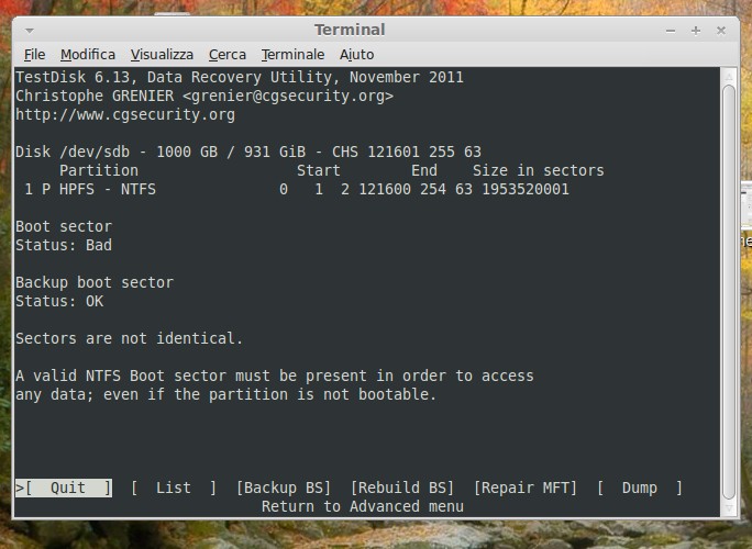

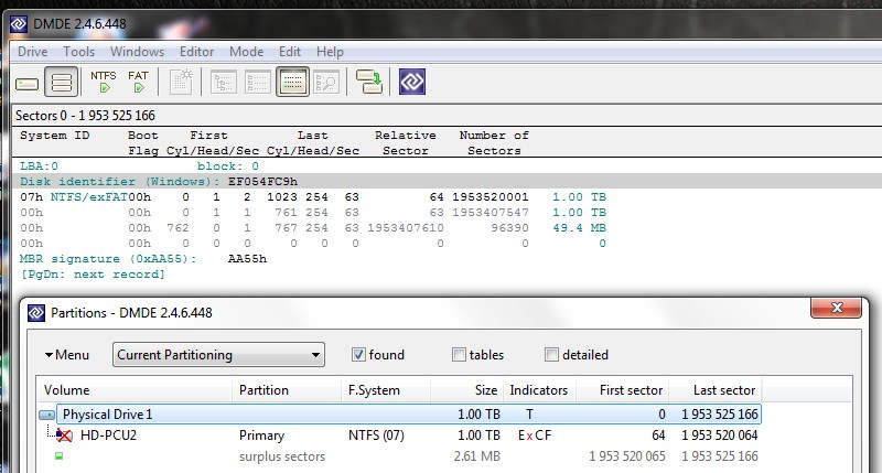

If i enter in the NTFS partition, i can see files and directory and recover one by one... :(

DMDE is a freeware editor. The data recovery part of it is not free and is limited to one file at a time.
In any case you should now be able to mount your repaired NTFS volume in Windows and access the files in the normal way.

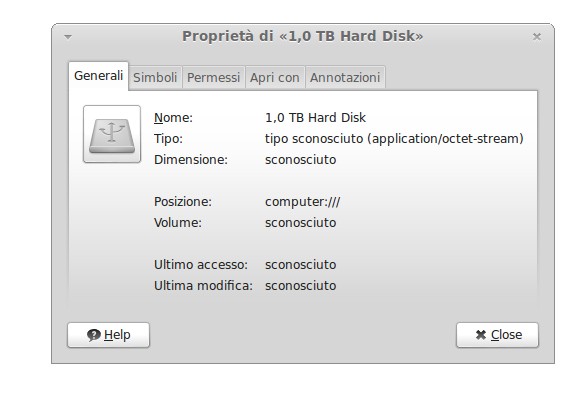

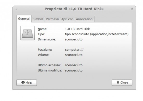

The problem is this: Windows see the HD as not formatted... :(

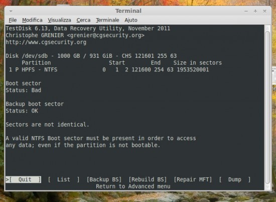

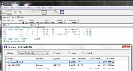

This is the result under Linux...
Probably, before use DMDE, with TestDisk i change partition Table from A2 to 07, before erase 49MB partition, so maybe there are two MBR, one made with TestDisk ( 1000GB - 49MB) and the last made with DMDE after cancelling A2 49MB partition...
How i can solve this??? :(

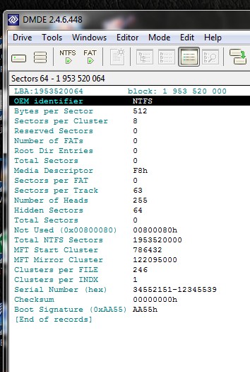

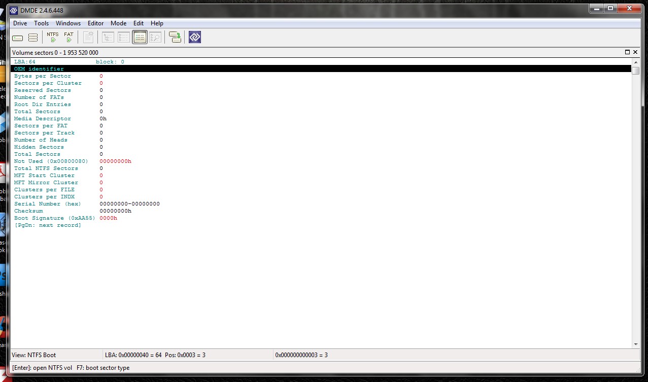

I now suspect that TestDisk is responsible for creating the boot sector at sector 64. I mistakenly (?) assumed that it was the original boot sector. In the Tom's Hardware case the OP's original boot sector was at sector 2048. That's the default for Vista and Windows 7 & 8. Maybe your original boot sector was at sector 63 (the default for Windows XP), and perhaps the TV overwrote this sector.
If it were my drive, I would examine the contents of sectors 63, 64, and 2048. Select Mode -> Hexadecimal. I would also examine the backup boot sector at the end of the drive. It should be located at or near sector 1953520064. You could select Tools -> Search For Special Sector -> Boot Sector.
The backup boot sector will tell us where the original boot sector was located. This will in turn give us a much better understanding of what happened.
Note that I'm not asking you to write anything to your drive at this stage.

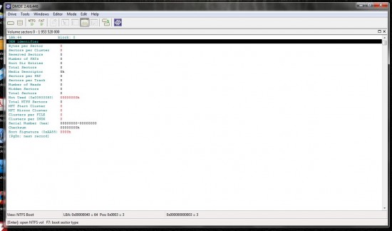

How can i do with DMDE?
This is sector 64...
