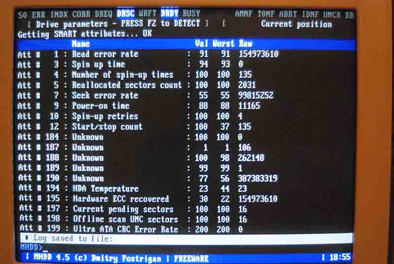

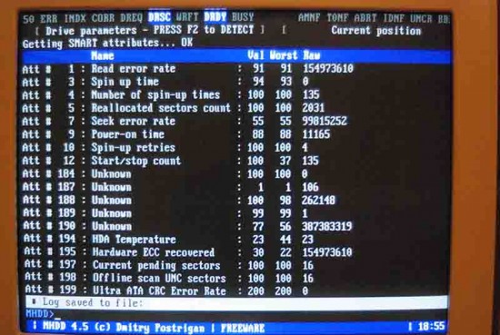

Here is the SMART for the drive from MHDD
Let me know if there is anything else I should check.
RecoverSoft Media Tools was use for cloning and gave this error CloneDisk
The error message was:
"Failed to read sector 6360320"
I've ran the clone several times and it seems to always report the same location. Once the error occurs the drive seems to be inaccessible and the computer needs to be rebooted to bring it back.
Thanks for the help

As for your SMART report, attributes 5, 187 (Reported Uncorrectable Errors), 197, and 198 are indicating that your drive has a serious problem with bad sectors.
Furthermore, in addition to the BSY bug, your drive has other SMART bugs. For example, your drive has 2031 reallocated sectors, yet the normalised value of attribute #5 remains at 100. Attribute #5 should really have lost about 50 points (1 point per 40 reallocations).
You are wrong (again) but still making statements from assumptions
The reason why raw is not 0 but value is still 100 is because SMART has been cleared recently (topicstarter just didn't tell you that). And this is not supposed to be done by a person who don't understand internals of this procedure

ID 5 may suggest that the original defect limit for G-List entries is circa 2030, which would keep the drive at 100 :roll:
If more defects are found and appended to the g-list you will see the value reduce

@belshawm: I see that things have moved on in this thread overnight (UK time). I don't want to get into the middle of this argument :( but since I asked for the SMART data which you've now kindly supplied, the least I can do is to reply - but it's not good news.
Thanks for supplying that and, unfortunately, it shows what I have seen before on this model of drive. As you've already been told, that drive is very sick, and the behaviour you are seeing (where the drive will "disappear" from the OS after cloning reaches the same place on the disk each time) is what I would expect, based on some specific parts of that SMART data which you supplied.
However most OSs (due to HBA f/w and/or driver limitations) do a poor job of reporting exactly what is happening. Which leads on to...

FYI, those weren't CRC errors that the drive was reporting, leading to that "Failed to read" error message by Media Tools (or at least not after the first message), but as you see, the error message doesn't give that level of detail - hence why the problem isn't easy to identify. Seeing the same location reported each time for the "start of the problem", is expected behaviour.
So at one level, from that SMART data you've now supplied and knowledge of what that drive is likely to be reporting via SATA, I understand why you're seeing the specific "drive disappearing from the OS and BIOS" behaviour. However as I said before, with the drive having reached this state, IMHO it would be very difficult, perhaps impossible (and high risk, due to how long it would take to even try) to attempt to clone it using software only.
My suggestion is that, if the data is important to you, you use the services of a DR professional - specifically one who is experienced with these Seagate 7200.11 drives (since this is not an uncommon behaviour with those drives) and who has hardware-assisted drive imaging equipment, in order to try to image your drive. If you say where you are in the world, you may get some recommendations of nearby board members who could assist.
If you choose not to take the drive to a pro, and decide to accept the risks of DIY (which have been explained elsewhere on this forum), then reverse imaging the disk might be able to clone some more data - or you might just kill the drive a little more. :( There are also other DIY approaches, but as I said, DIY carries a significant risk in this specific situation, seeing how much the drive has already deteriorated IMHO. The more DIY you attempt now, could significantly increase the cost (and decrease your chances of successful data recovery) if you later decide to take the drive to a pro - all depending on what is actually happening inside the disk.
It's your data, so it's your choice as to how important it is to you, and therefore what risks you want to take. Good luck!
(Just for full disclosure - I work in a different part of the electronics & data storage industry, so although I deal directly with engineers from several disk manufacturers, I'm not a DR pro. The reason I've been able to identify a little more about the behaviour you are seeing, is that I had to investigate the consequences of this specific behaviour as part of my job.)
