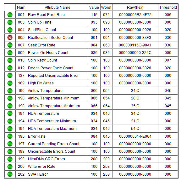

ST3500630AS with F/W 3.AAK
Reallocated Sector Count is at 0000000000-33F3, which when converted to dec gives a value of 13 299. From what I read, this is an absurdly large amount of bad sectors, and it should be immediately visible with a surface scan. However, I did a long scan and zero fill with SeaTools and both completed OK. Drive has not been overtemp, POH is near 13000 hrs. Should I be worried? If not, is there a way to reset the SMART data for this value?
I've attached the HDDScan report.

I would backup and replace the drive. Attribute 5 has dropped well below its threshold.

Problem is, while it's still under warranty, Seagate won't take it unless SeaTools essentially says it's bad (failed long test etc). I'd rather not just consider it dead when I could be getting a replacement drive from Seagate for next-to-nothing, anything I can do about this?

SeaTools should fail with a "SMART fail" error.
The test code will be xxxxxx4x, where the Xs are a unique hexadecimal number related in some way to the drive's serial number.
