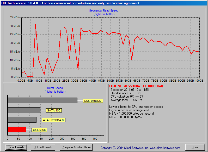

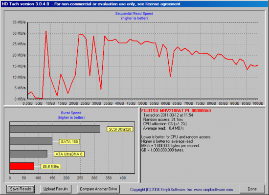

My HDD has been really slow lately,both in Linux and Windows.
Speed tests show that the burst speed is nearly 30 Mb/s,which seems to be ok for this model as far as I know,but the sustained speed barely reaches 2 Mb/s.
The HDD is way slower when I turn off the laptop for a while,not even reaching 500 kb/s,getting faster as time passes,until it reaches those 2 Mb/s.
I've run the Fujitsu diagnostic tool,which doesn't show any errors.
Excuse me if my english isn't correct,it isn't my native language.
I attach all the info I could think of as of now:

My external USB HDD seems to work fine on both Linux and Windows.

Ah,yes,I was in Linux at the time,so,I couldnt upload anything else.
About the SMART data,uh,my mistake,seems I pressed paste twice,external HDD controller
I've also ran SpinRite this night,and no errors have shown up,however,after the restart,hdparm benchmark returned 17 Mb/s.
For some reason,it seems the more I use the HDD,the faster it gets,until I turn the laptop off,then,it slows down again.
About the HD Tach picture I've attached,I must say that older benchmarks also showed those spikes after the 25 Gb mark,but the 0-25 Gb area wasn't like that before.
I've already done a full backup of the HDD,as I already planned to do a zero-fill,but I wanted to know if there was any other choice,although,what should I use for the zero-fill? Fujitsu doesn't have any utility for that.
File comment: HD Tach benchmark
 Post subject: Re: Slow HDD
PostPosted: March 12th, 2011, 8:46
Joined: May 6th, 2008, 22:53
Posts: 2138
Hardware behaviour that is related to temperature (e.g. bearings), is quite common - again, this just shows the drive has a problem.
Note that this drive appears to have been very hot at some point in the past - 72 deg C - and at the time the SMART data was collected, it was at 54 deg C, which is also not good IMHO. Are you sure that the fan(s) / heatsinks / etc. in your laptop are working correctly?
If that graph shape is consistent when the test is repeated (i.e. not due to influence from elsewhere in that system), then again, that just confirms the drive has a problem reading large parts of the media.
From the shape of that graph, I think you're wasting your time - it looks very sick. :( It doesn't have to be a zero-fill, if that is difficult for you. The idea in this case is just to rewrite all sectors (and also forcing any pending reallocation sectors to be tested, but in your case there are none). You could just use something like this: "dd if=/dev/zero of=/dev/--- bs=1m" (where --- is the device node for that disk, which depends on your system configuration)
