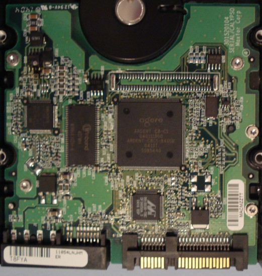

hi i had a issue with my drive which had a blown motor driver
so bought another board correct information etc
Agere IC chip Main Controller IC: 040111300 match but the bottom row two don't match
(should these be the same)
allso the white label do not match which i see now
the new board is
0708308CMY
old board number 11054LNJHM
the five number on the white lable
old one is T8FYA
the new board
R5FYA
i unsolder the flash memory chip 8 pin
solder flash memory to the new board
it is now seen in the bios but not in windows or any recovery devices
the qeastion is what im i doing wrong
do i have to swap over the sdram chip allso
which im not to sure

Which chip did you transfer?
 Post subject: Re: Maxtor Diamond Max + 9 HDD 250GB sata version
PostPosted: March 25th, 2011, 3:35
Posts: 505
Location: Bulgaria, Sofia
I think he is talking for the 8 leg IC near the top right.
Have you try the new PCB without moving it?
What you see in BIOS as drive name, f/w, capacity?

Yeah, I know that's the CORRECT one, just he'd moved the right one! ;-)
Not always necessary to move this chip, a lot of PCB's don't have one at all. As far as I know it's inter-release ROM fw modifications to the masked ROM in the MCU.
Like Samo says, is it seen PROPERLY in the BIOS?

hi yep it the 8 leg IC near the top right 25P10
the hard drive is seen in the boot up screen.
yep tried the new board with out removing the rom
but did not see it in windows or bios
but dont see the drive in windows
which is very weird
could it possible be a damaged headstack
as the motor driver chip was damaged :(

Wrong. Turn on your PC3000.

Agree. Looks like a FW corruption.

try write 38,39,4f with checksum:6CCD

hi not sure why it would be firmware damaged
as the only thing was at fault was the smooth chip
if it was firmware damaged then the drive in the bios would not show up correct
the board is new and all i swap was the rom over
if the hard drive had firmware issue the data compass would still pickup the drive
which its good for.
