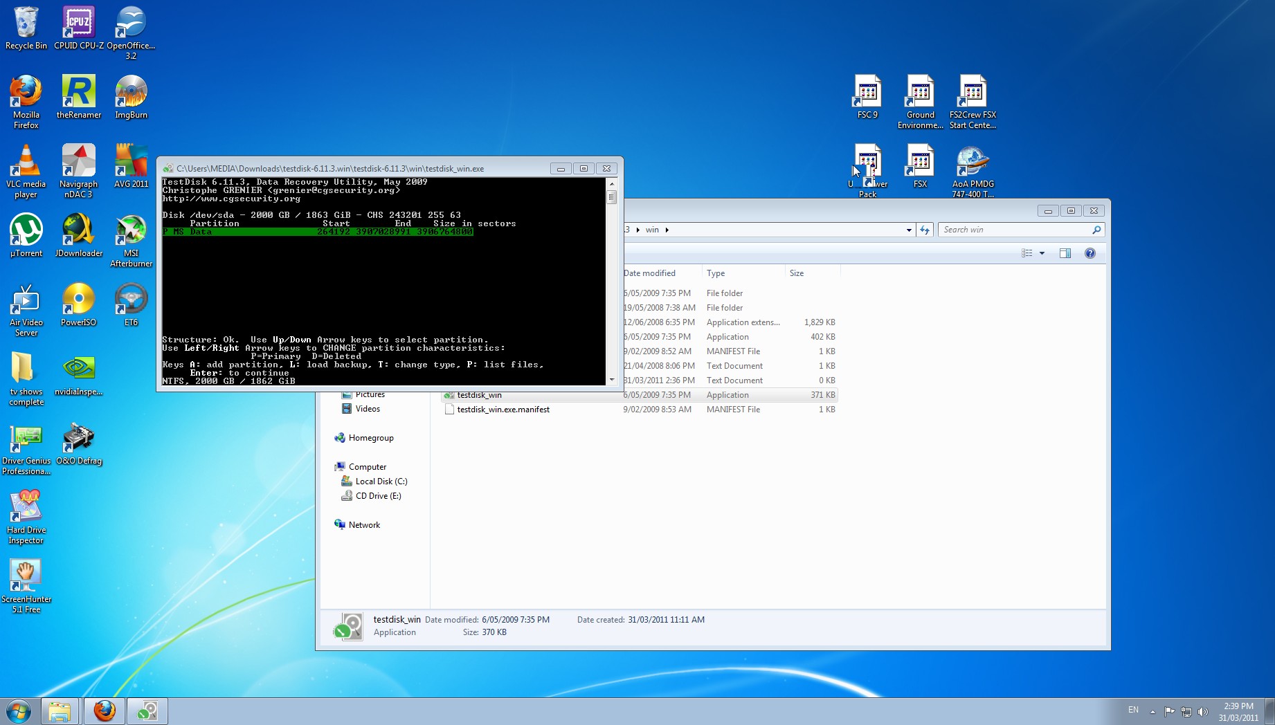

Hi guys I am using testdisk thanks, I need a walkthru please if anyone can.
PC
WIN 7
x58 ud5r mobo
i7930 CPU
2 x Western Digital storage drives being I drive and F drive allocated (now unallocated)
Op system on 60GB SSD
The above WD drives last night disappeared from my computer however i have hard drive inspector which displays then as 100% ok and they are also displayed as unallocated in Disk management. I want to recover the data from these drives as they have family pics and media on them.
The drives are spinning and sound normal ie no clicking etc.
Could someone guide me through recovering media from them i would very much appreciate it. I can also skype someone if that helps.
So far I have scanned drive with testdisk and it tells me HD is ok Wayne. the screenshot posted is where I am at with Test Disk I have only analysed and the drive shows as you can see as 200gb correct, and 1863gb used which would be correct. If someone can just advise me what to do next as I dont want to stuff this up. Thanks in advance wayne
File comment: this is where i am at and wont go any further until i hopefully receive some guidance thanks

If the file system is undamaged, you could use PF&M to mount the partition and view your files.
Partition Find and Mount:
http://findandmount.com/download/
If you can see your files, then I would back them up. Afterwards you could use TestDisk to make the changes to your drive.

"Unallocated" means that the partition table is missing.
PF&M (freeware) will not write on your drive, so give it a go.

Stop - if you want your data image it first. Then you can try any software on it you want. The best one for you might be get data back NTSF on this one. But before you go much further on this one I would image it to another HDD first. It is not a good practice to run any softare on a failing drive or a drive with problems on it. You can also try R-Studio on this one too.
