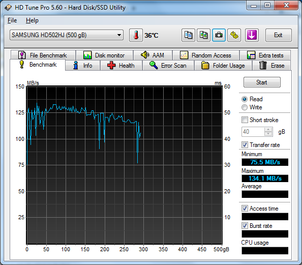

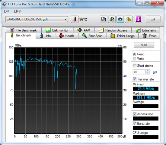

Well, it didn't take long to get the verdict. I installed Windows 7 on the hdd today. Partitioned the disk and checked SMART. It was okay till then.
Then I ran read benchmark test in HDTune Pro. It failed the test with a read error at the middle of the disk. Also, current pending sector value is now 1.
File comment: It looks like it's that 57% mark where the long test failed previously. There are probably some damaged areas after that portion.

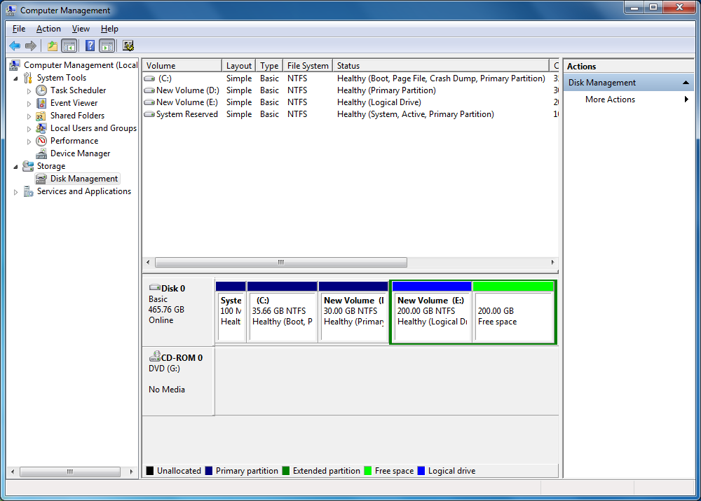

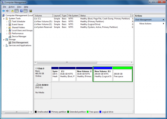

I'm now thinking to use the first half of the drive and keep the last half unused. I have partitioned the drive like this -
I guess I'll have to buy a new hdd after all. I haven't bought any disk in the recent time. Since there are currently three manufacturers in the market, and Seagate drives aren't quite available in my country, which drive will be best - Western Digital or Toshiba?
