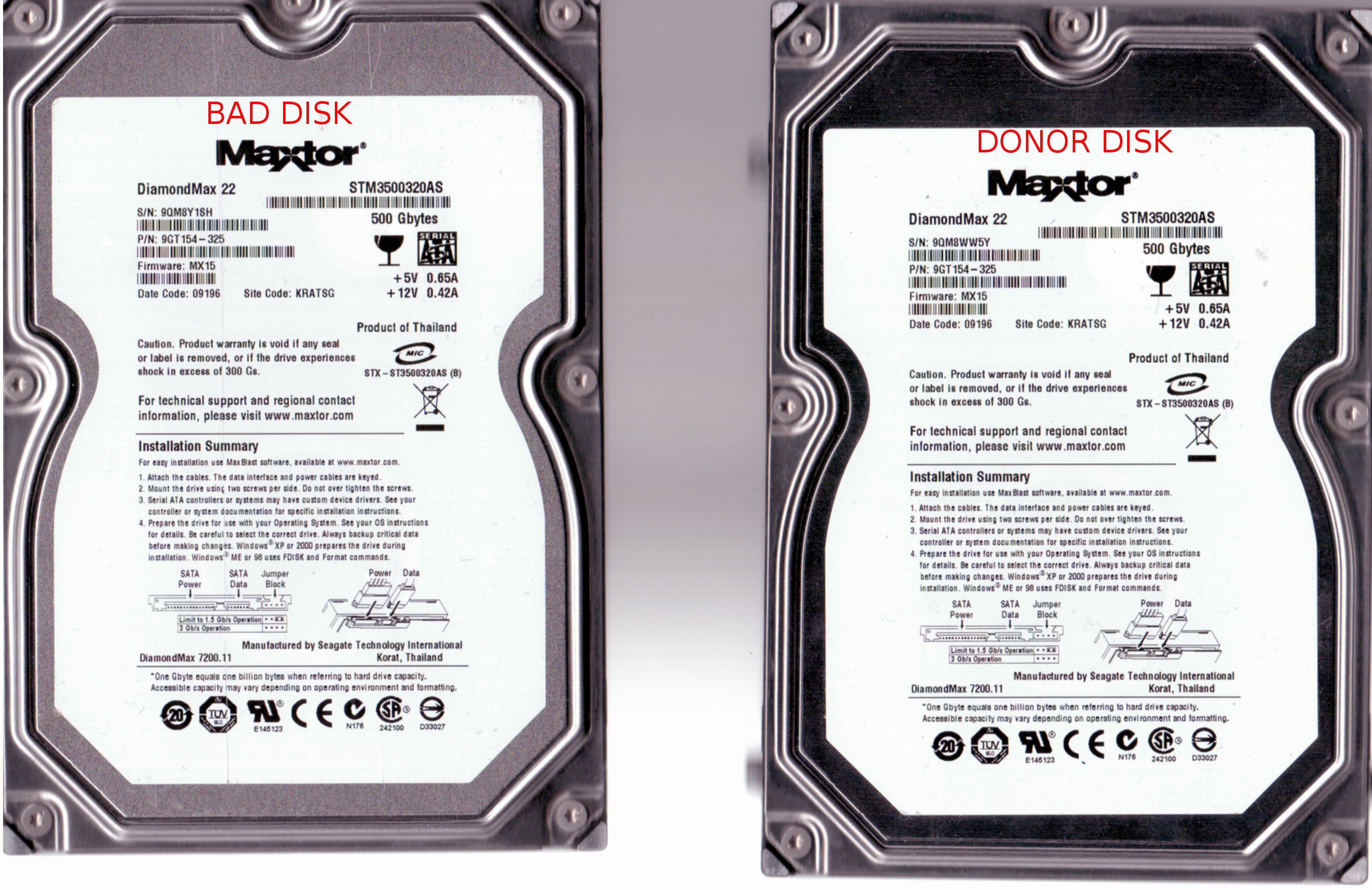

Hi
Today I get this disk, that's not recognized by BIOS or Maxtor SD Doctor.
The client also have the exactly same disk, to use as donor.
Tried to swap PCB, but the donor PCB on the bad drive, it starts clicking and a bunch of noises.
Tried to read FW from Donor Drive, I get errors from Doctor, but it's recognized ok and works OK on the PC.
Just by swapping the PCB, shouldn't work? Or need to exchange ROM's?
PS: here's the picture of them.

You should be using different utility
Like what?

Look at the drive. Does it look like any other drive/s?

Looks like a Seagate. Shit... Is that it??

Bingo

MX15 firmware was affected by Seagate's 7200.11 BSY bug. The same fix applies.
http://forums.seagate.com/stx/board/mes ... 467#M18467

Thanks Guys. Problem Solved with the right tool.

I have a same problem, please HELP... i have a donor HDD too... THANKS

Put the original PCB back on ur drive and read the link Fzabkar provided in this topic.

Thanks to all, I solve the problem... I used infinity box (my friend have a mobile repair shop and I take it from him) and I get your links... step by step and I'm done, all data is recovered... Thanks to all again :mrgreen:
