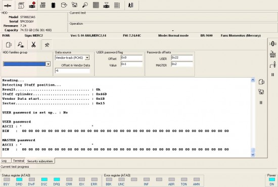

I have a seagate 80GB
model ST98823AS Momentus 5400.2
Its Password protected. can someone guide me how can i remove the password

 Post subject: Re: ST98823AS Momentus 5400.2 PASSWORD UNLOCK
PostPosted: April 6th, 2011, 9:33
Joined: May 21st, 2007, 16:10
Posts: 1592
Location: Gothenburg/ Sweden
Hi, if you have a legal copy of pc3000 you can read it in the manual.
Bosse
http://www.rescue-it.se
PostPosted: April 6th, 2011, 13:10
Posts: 1721
Yah UDMA should have a script for you on this one and if not there like Mr Spokk said the answer in the manual of ACE to do this one.

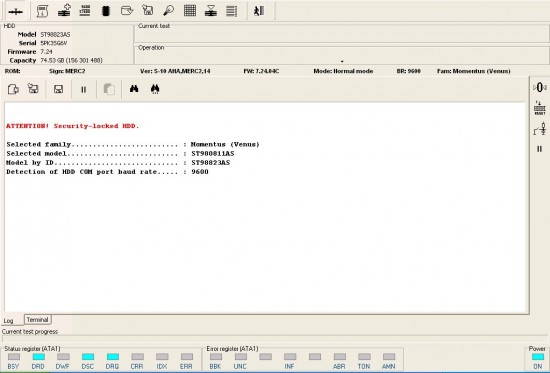

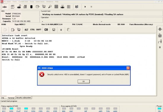

Tried these two options and these are the results.
Any suggestions ????
Thanks guys
PostPosted: April 13th, 2011, 15:26
Posts: 505
Location: Bulgaria, Sofia
Rewrite stuff with one from not locked, but same model and capacity.
The thing that bother me is the error you got after reset. You should take proper action to get around it if you need the data.
P.s. Why you select family Venus, as your drive is MERC2?
