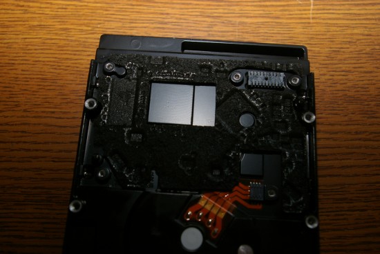

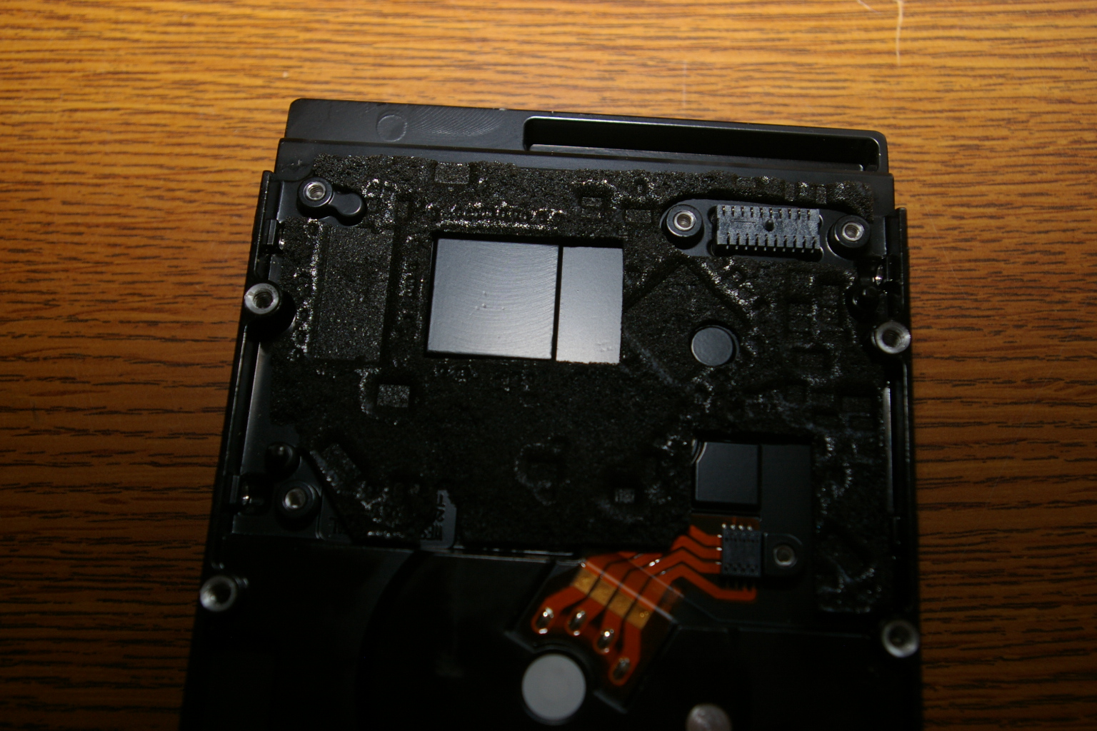

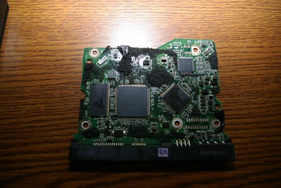

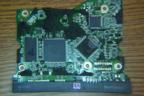

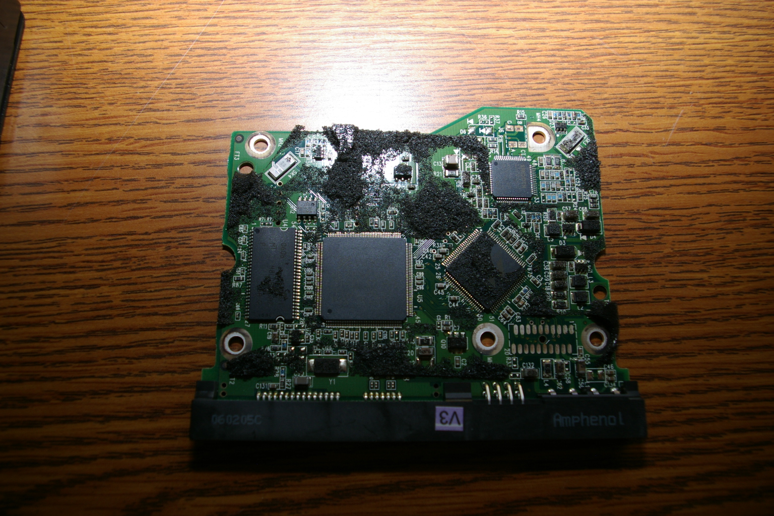

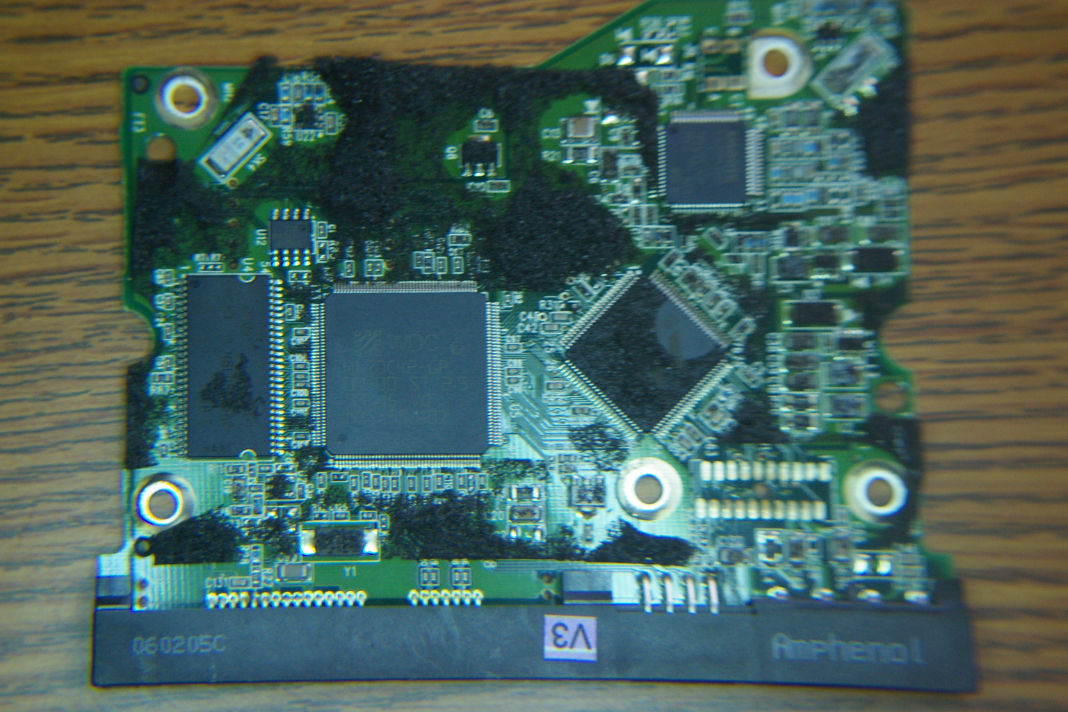

OK, I finally got a chance to get this apart and take pictures. There was some kind of foam sort of melted between the PCB and the drive. Not sure if this is normal. Regarding the post about the bad heads, wouldn't a PCB swap be worth a shot considering the drive was working until it literally went totally dead? Again, it doesn't appear to want to power on anymore.
As far as what caused this outside of normal wear/tear, I'm still not sure yet. I haven't finished checking out the computer it was in. However, this machine is one I use as a "media center" of sorts and it has an outside aerial TV antenna attached that I have on my roof. I haven't figured out a way to protect it from any static/surges so I just connect it directly. I've been doing this for several years on this machine and two others without any noticeable problems, however maybe the machine got hit with some sort of static/surge this time? I'm not sure. Nothing else in the closet was damaged that I had plugged into the house current.
Again, thanks for any help on this. I'd really like to save this drive. Also, please tell me what "TVS" is? Also, I'm assuming I would need "adaptive" information if I'm going to swap with my other drive. What would be the best way to do this? I have moderate soldering skills and equipment.

If the drive is making noises as if it is trying to spin up, then you may have a stiction fault.
Otherwise, check TVS diodes D4 and D3, and zero-ohm resistors R64 and R67 near the SATA power connector.
If you decide to replace the board, then be aware that you will most probably need to move the serial flash memory chip at U12 to your donor PCB. Some board suppliers offer such a transfer service for US$10.
