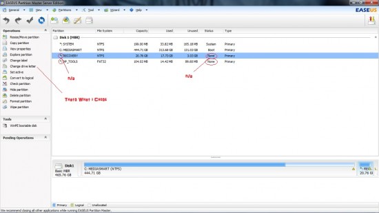

Hi All !
I am a newbie actually i tried solving my problem at hp support because my laptop is in warranty but no solution
so i found this website best for my problem
In Case if you didnt knew
Actually Hp's notebook with Oem O.S comes with recovery partition for incase of data recovery and you can also backup on dvd's
How i Got Stuck
I was installing hp's bios webos which is faster on boot to watch movies than window 7 so it asked for another partition for boot

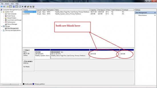

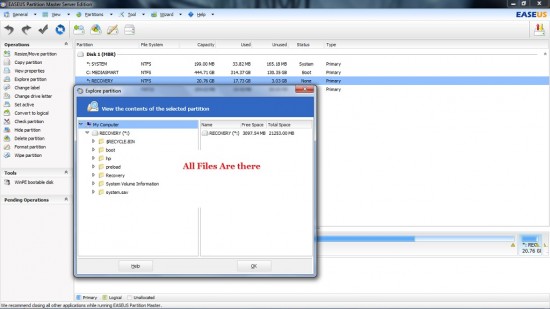

it required 399mb of space but there was only 104mb of unallocated space(now there where three drives 1)Windows2)Recovery3)Hp_tool[104mb created by that software]) so i downloaded Norton Partition Magic to extend the third drive for about 450mb for that software but when i installed it ,while first startup it asked some thing related to space or sector which is'nt fixed with yes/no option (like 45307 was not 45356) i clicked yes but it failed to start i removed it but after restarting my laptop other day i saw only my windows drive and other 2 were gone ?

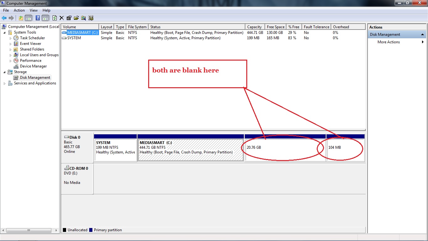

i checked disk mangement drives were there but with no details,no letters,no characterstics
then i downladed easeus to check those drives and it showed them with their labels but no letters,and files were there

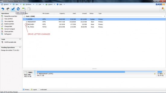

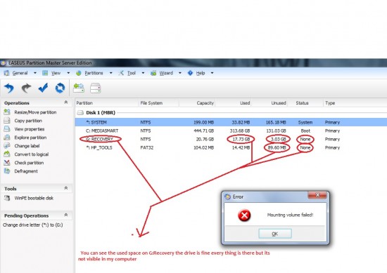

now i only need your help to make them visible to my computer please help me out with this when i try to mount drive letters it gives error
Helpppp :( :?:

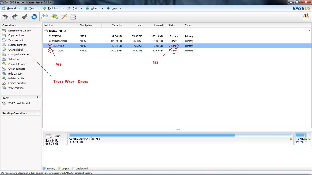

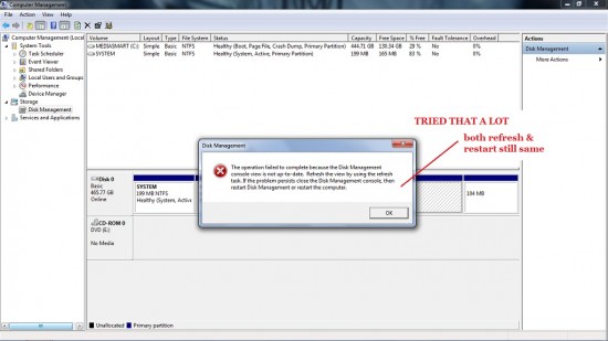

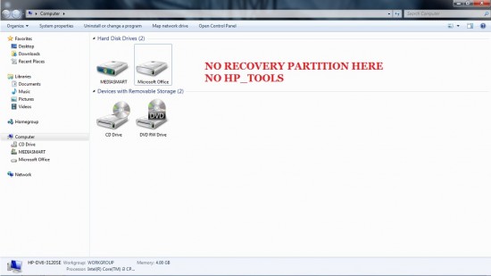

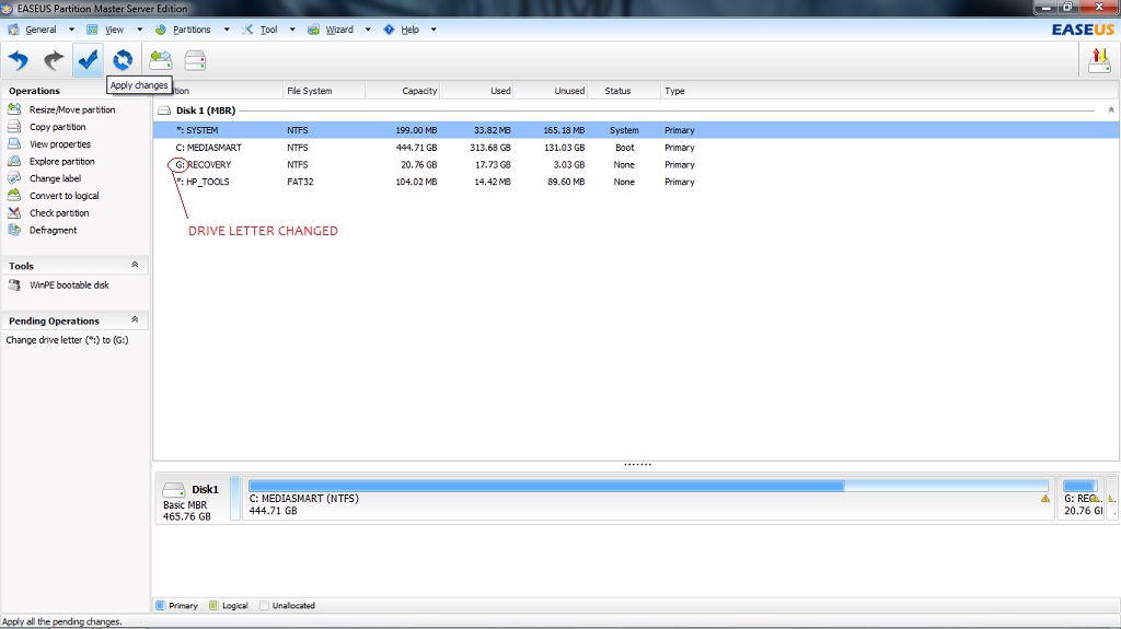

CHECK THOSE IMAGES MIGHT HELP YOU UNDERSTAND ,I CAN CLONE THAT DRIVE BUT RECOVERY PARTITION WONT WORK THAT WAY,
I MENTIONED BEFORE I HAVE BACKUP DVD'S I JUST WANT RECOVERY DRIVE BACK ITS BEST WAY OF RECOVERY PLZ HELP
watch them from below from image 1 to 6

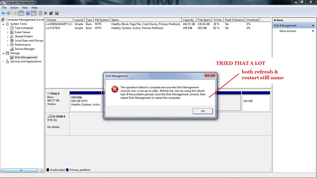

File comment: disk managment also cant mount or change drive letters nor can check its properties

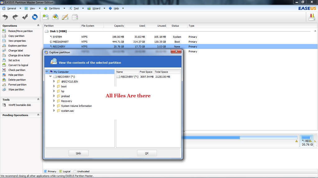

File comment: check what disk managment shows as compared to EASEUS

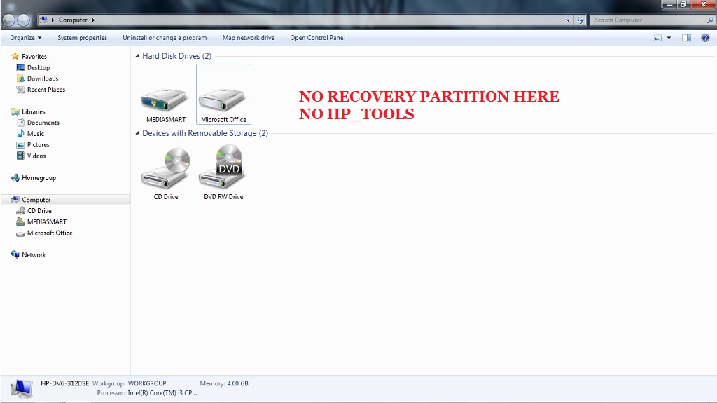

File comment: but cant find them on my computer

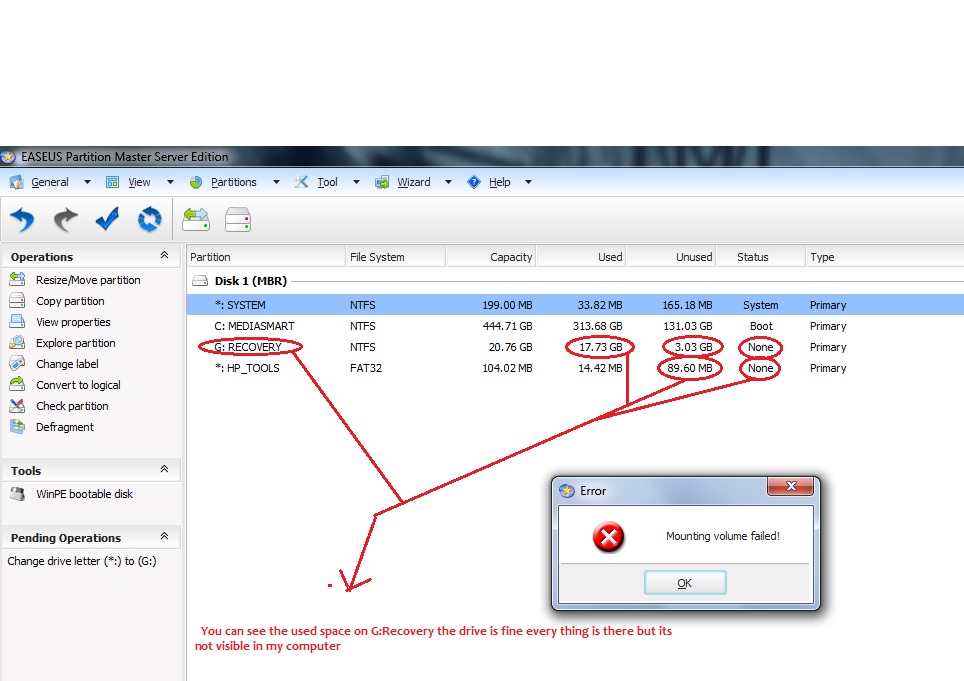

File comment: Mounting drive letter failed after applying changes
File comment: Files on my drive r still there
File comment: DRIVE LETTER THAT I TRIED TO CHANGE
File comment: EASEUS DETAILS OF MY DRIVE

The good news for you, is that EASUS seems able to read the filesystem in your recovery partition (see 3.1.jpg which you included). Therefore after you have cloned the disk, to create the backup copy as I explained, then you can either use a local expert who has access to your PC who can examine the partition table & filesystem directly; or you can try tools like Partition Find & Mount, TestDisk etc. if you do not have the skills for direct disk editing yourself.
