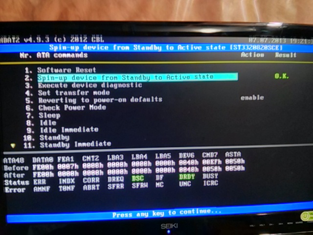

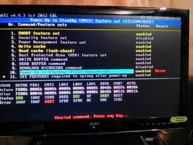

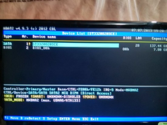

1. Connect HDD - Reboot computer.
2. Run HDAT2
3. HDD detected in HDAT2 (see IMG_1) as actual size of HDD is 320GB.
4. SPIN-UP HDD (see IMG_2) - status OK (Now, HDD SPINNING).
5. Trying to DISABLE "PUIS" (see IMG_3) but got error.
6. HDD still spinning.
7. Now, I'm disconnecting HDD and reconnect to computer.
8. HDD stopped spinning.
9. When you check in HDAT2 its show same as before (IMG_1).
Please let me know what should I do to disable PUIS feature.
Thank you all again.
