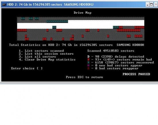

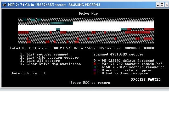

I wrote in haste. After I read myself, and did not understand, sorry. I enclose a picture. The disc is full of bad sectors. ~ 4 days and I've improved a little more behind. I do not know whether the sectors will be lost or come back?
File comment: Prior to the restoration of 15% for 20-30 thousand a bad sectors. Now it is 37% at 6 thousand Bad Sector. Will restore disk and I can use?

If this was my drive and I didn't know much about data recovery, I would download a hirens bootcd and scan with mhdd in DOS.

Useless. The problem is elsewhere.

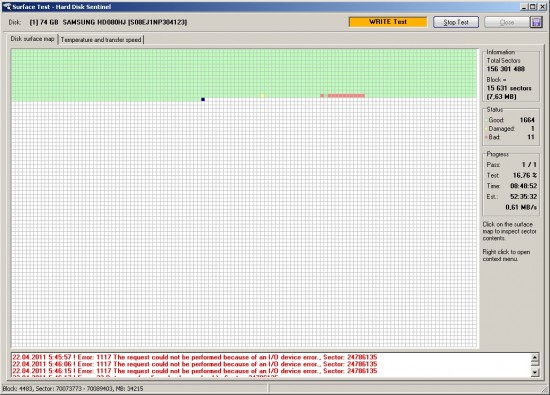

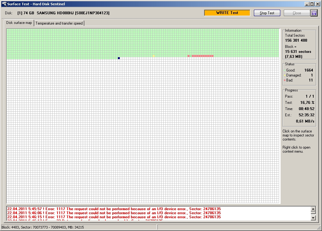

I guess I'll buy you a new one.
SAMSUNG_HD080HJ_S08EJ1NP304123_ZH100-47-surface-full.jpg [ 670.24 KiB | Viewed 7678 times ]

P.S. either the explanations are not clear or what you hear is not what you want to hear . Once for all :
1) The drive may have a surface problem (degradation) and you need specific knowhow AND/OR equipment and resources to perform technical procedures to fix it (if possible, and depending what happened eithere these procedures will fail and the drive has to be discarded). I CAN'T TELL NEITHER GIVE YOU ANYTHING.
2) You can also have another problem and in this case the drive has reached EOL.
3) The drive is a small, old (>5 years old most probably) drive that has a value of 10$ or less. Instead of trying to repair itand use it = make a time bomb of it as it will fail soon due to mechanical EOL, get a new drive.
