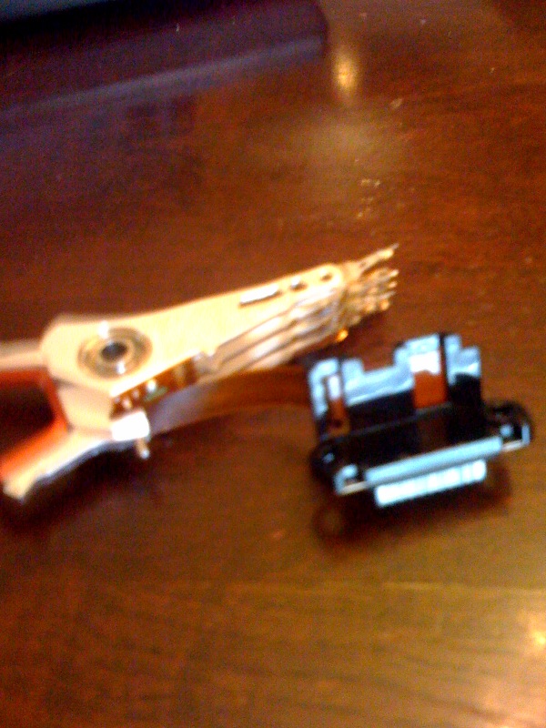

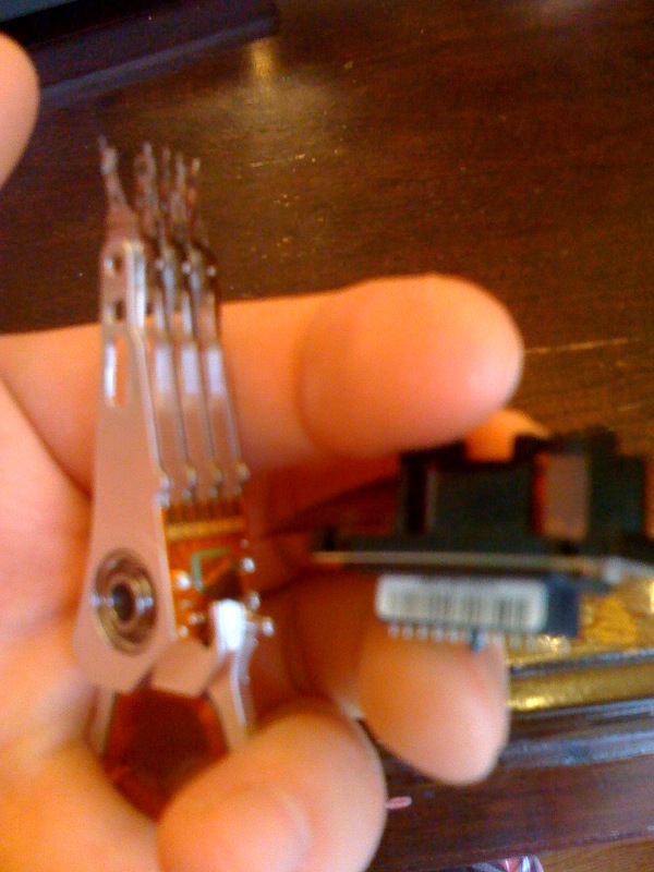

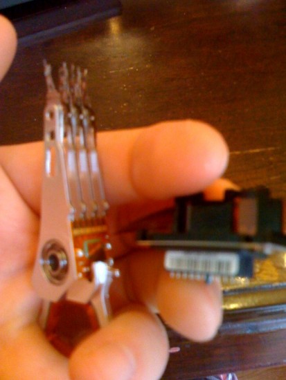

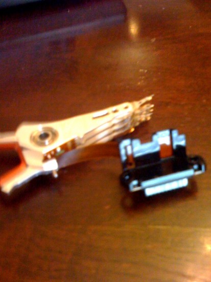

I'm needing a head replacement or equiv of the Western Digital Model # WD10EAVS-00D7B0
Western Digital My Book Caviar GP
1TB
3 Platter
Can anyone help or point me in the right direction?
Only doing a data recovery, no restoration or refurb.

for some reason, i'm unable to reply on firefox. Yes i have once in the past with great success. This one crashed, but i was fortunate it didn't scratch the platters. Everything appears to be intact and good shape minus the head and I'm working in my home built clean room, hepa filters etc while working on the drive (Garages are good for something :P). I've got all the tools i need, just needing a new head. Apparently this exact model is rare and expensive ($200)...but if I can find one close to it or exactly (a lot cheaper) i'd be a happy camper :)
I've got 1TB of data i'd like to recover (personal hard drive)
Otherwise i may have to bite the dust and get one on ebay... :(

well the drive was knocked over followed by the usual head crashing on the platters. After powering down the drive and powering it back up once to check the drive, the usual clicking noise took over. After opening the drive i was not only able to see the head failing to read, but the obvious was before me. A bent and missing head. Good news it threw it out of the way...bad news the head is gone. I examined the platters and there appears to be no apparent damage...but i'll know that later when reading it. I'll be most likely throwing it into a kernal mode and read by sector or other HD tools, pc3000 or ontracks recovery tools to extract what I can. So just crossing my fingers and hoping for the best, if not, i can live with the fact the data is gone...but can't hurt to try. Just needing to get a head.

access yes, joke no, and with one of the heads off, it won't do me much good for recovery without a new one. I'm not looking for a professional job...data isn't that important...just looking to find a head replacement.

Not sure about the first two, but here's what i've got.
July 13, 2008
Model #WD10EAVS-00D7B0
DCM: HHRNHT2MFB
poehere: def looking like the case. I mean i can handle losing it...but would really like to get it back...i can afford a few hundred for another drive...but anything above that is far out of my budget. If I had more to spend i certainly would.
