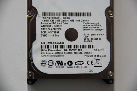

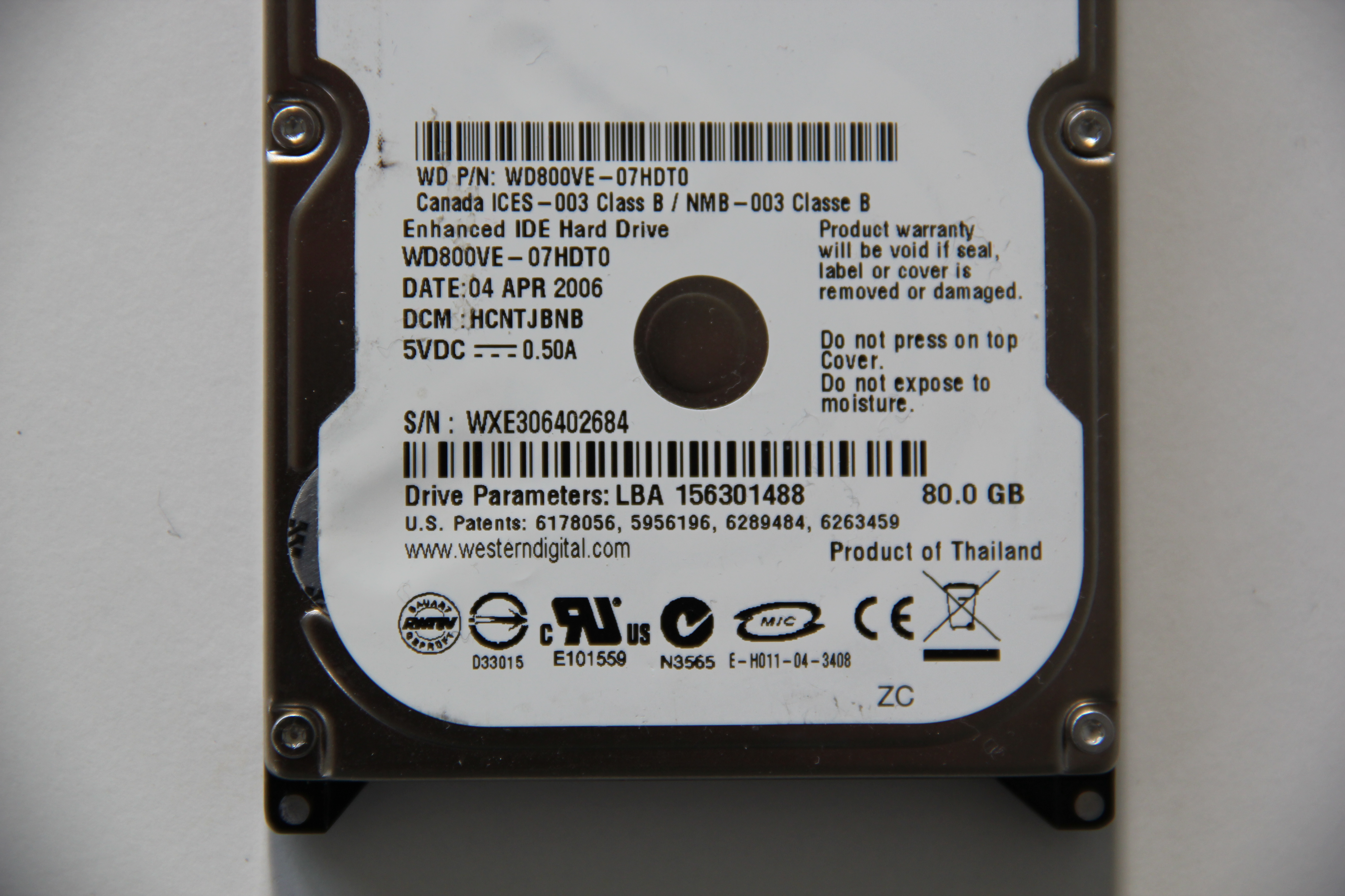

I have a old noteboot hard drive which now is dead, doesn't spin up at all.
Model: Western Digital Scorpio WD800VE
80GB
2.5" PATA
WD P/N: WD800VE-07HDT0
Any "classic" component I could check?
If I can find a donor drive can the PCB be replaced directly on this old model? or do I need to swap some components on the PCB?
Thanks, hope someone can provide some input :)

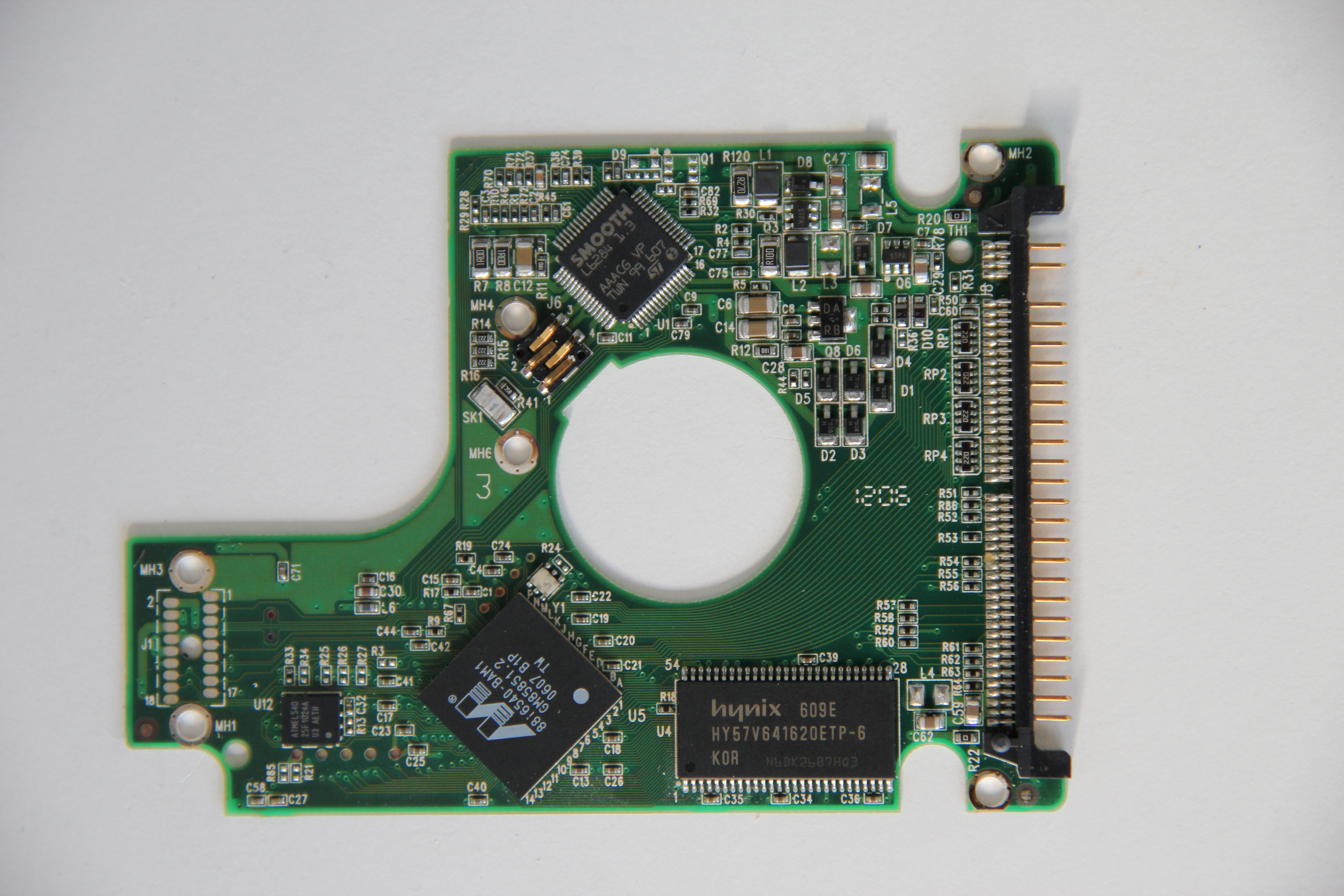

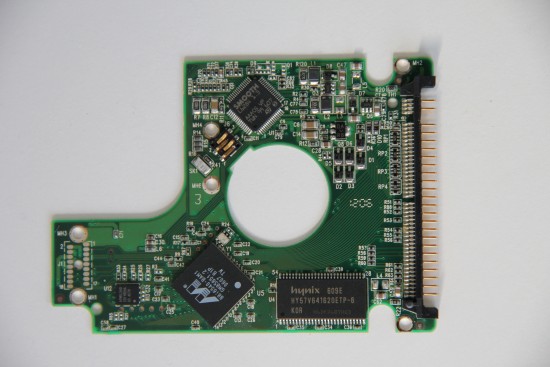

Can you take a picture of the PCB and show it here?
You can buy a new PCB and swap ROM (if external), but that really depends if the problem is really related with PCB or with PCB only.

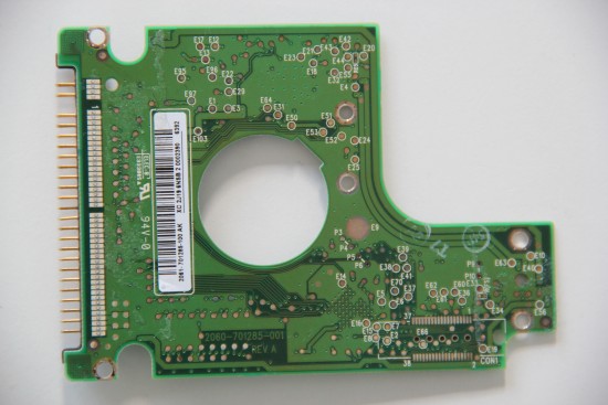

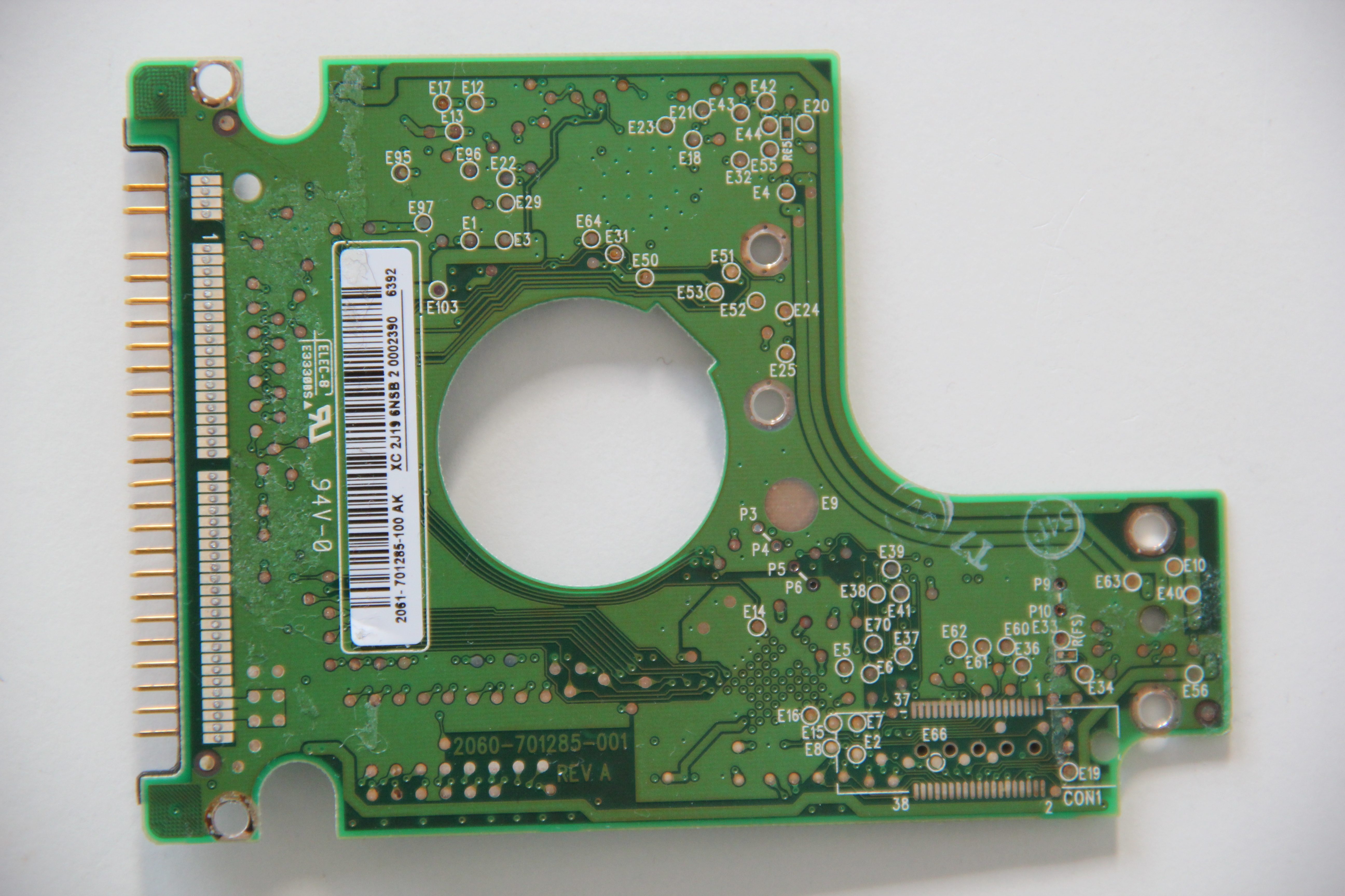

Please see attached pics

You can check diodes to see if any is damaged.
ROM chip is external (U12), but it's not easy to move if you don't have experience and I would not recommend to move it.

Posts: 7864
The ROM is at U12, but it's one of those nasty things with pads on the bottom rather than legs, by the look of it. Quite tricky to remove.

L1 & L2 look like there TVS.
Is there damage on L1 looks like a line on it?

Thanks for your suggestions, will check L1 & L2. What should I measure on these two? any other components I should check?

I don't see any TVS diodes on the PCB.
L1 and L2 are inductors, not TVS diodes. They should measure 0 ohms on a multimeter. Do not remove them.
If you would like to check a few voltages, then you can do so with the board removed from the drive. I'd measure the voltages between ground and L1, L2, D7, D8, Q8 (DA). Be very careful not to slip with your probe, as you will do serious damage.

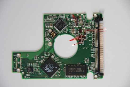

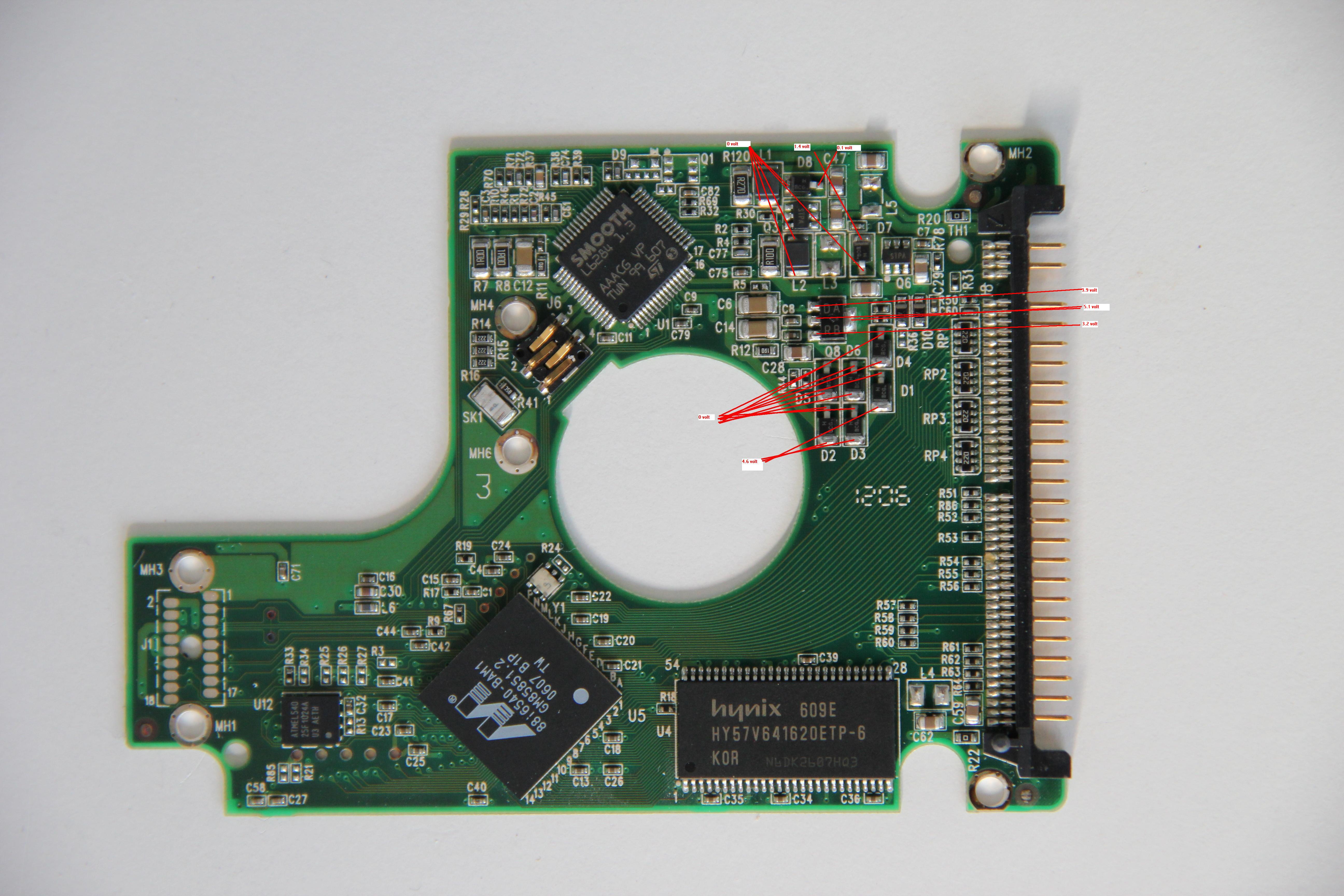

Been doing some measurement of voltages between ground, please see attached picture.
Anything that make sense? Hope someone has a good suggestion or additional measurements:)

Q8 is the pass transistor for the +3.3V linear regulator. It supplies the Vio rail for the Marvell MCU (88i6540-BAM1), and it also powers the hynix SDRAM and Atmel serial flash memory. Its tab is connected to the +5V supply, which is also measuring OK.
Diodes D1-D6 appear to be Schottky rectifiers. I'm not certain, but I believe they rectify the three phases of the spindle motor to provide an emergency retract voltage. When the drive loses power, the motor becomes a generator and supplies a decaying voltage to the SMOOTH controller to allow the heads to be parked in a controlled manner.
Q6, D7, and L2 appear to constitute a 1.4V switchmode DC-DC converter which supplies +1.4V (Vcore) to the MCU. That said, there is an inconsistency in your measurements. AFAICT, the uppermost pin of L2 is connected to the cathode (striped end) of D7, which means that both should measure the same.
Q3, L1, and D8 appear to constitute a negative DC-DC converter. If I'm right, then the anode (non-striped) end of D8 should be the negative supply for the preamp (inside the HDA). It appears that this area of the circuit is faulty.
My next step would be to perform some resistance measurements (in the absence of power). The preamp connector is J1, and is located at the far left side of the PCB. Set your meter on the 200 ohms range and measure the resistances between ground and each of the heavier pads (pins 2,4,6,8,10,12). One or more pins will be connected to ground (0 ohms). Similarly, determine which pin connects to +5V. Finally, determine which pin, if any, connects to the anode of D8. This will be the negative supply pin.
Our next step will depend on what you find.

Here's reference voltages from a working PCB:
L1 0V
L2 1.393
D7 1.4/0.3 (anode/cathode)
D8 0.001/0.123
Q8 4.0/5.06/3.35 (BCE, I think)
Jon

Sorry, your correct that L2 measure 1.4 volt as D7:)
J1 pin:
GND: 1, 8
5v: 6
D8: 10
Repeated jono-ats measurements:
L1 0.0
L2 1.4
D7 1.4 / -0.0006
D8 0.0001/ 0.095
Q8 3.93/5.08/3.23
D7 cathode which is different from your measures? 0volt on my PCB. The resistence between D7 and GND is 0 ohm. D7 cathode is short circuit to GND on my PCB.
Thank you for your big effort so far, really appreciated!

I wouldn't pay much attention to the millivolt readings that I measured. The meter jumped around a bit, and I probably didn't give enough attention to the placement of the decimal point on some of the really low readings.
Insofar as I can see, your measurements don't indicate a major PCB problem.
In my opinion, the lack of an obvious electrical fault strongly suggests that stiction may be the culprit here. It is good to have opinions and to disagree from time to time -- makes for more interesting reading . . . :D
J1 pin:
GND: 1, 8
5v: 6
D8: 10
L1 0.0
L2 1.4
D7 1.4 / -0.0006
D8 0.0001/ 0.095
Q8 3.93/5.08/3.23
D7 is the flywheel diode. It's anode should be grounded, not the cathode.
http://upload.wikimedia.org/wikipedia/c ... fr.svg.png
AFAICT, the Vcore supply is based on a "buck converter" topology:
http://www.daycounter.com/LabBook/BuckC ... ematic.gif
It appears that pins 2 and 4 of J1 may be connected to the voice coil. Pins 6, 8 and 10 are the +5V, ground, and -5v (?) supplies for the preamp.
The fact that the negative supply measures 0V, even on a good board, suggests to me that this particular switchmode supply may not power up correctly without a load (ie the preamp). If the problem is indeed stiction, then you should hear or feel buzzing or vibration as the drive attempts to kickstart the motor. Furthermore, you should be able to detect "voltage activity" at the motor terminals while this is happening.
