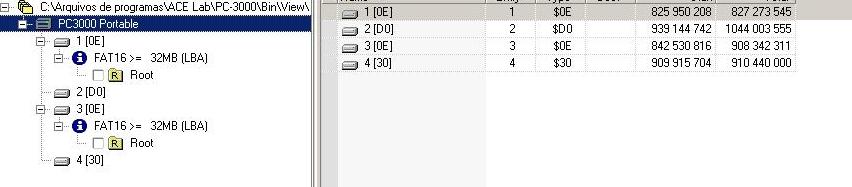

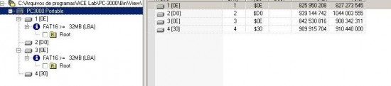

Hi to all!! :mrgreen:
PCB BAD original, pcb good donor.
EDIT id=> sn ok.
No acess data look screens pc3k udma.

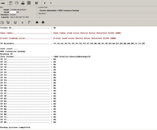

EDIT id=> sn ok.
glist reset error device error detected 51/1c (abr;<bit3> inf)

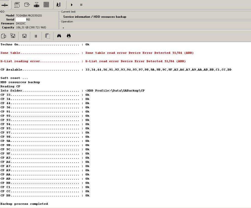

sempre wrote:
EDIT id=> sn ok.
CHECK SA ALL MODULES OK

jono-ats wrote:
Try clearing G-List and SMART? Try hard reset?
Clearing G-LIST ERROR
Clearing SMART ok!
