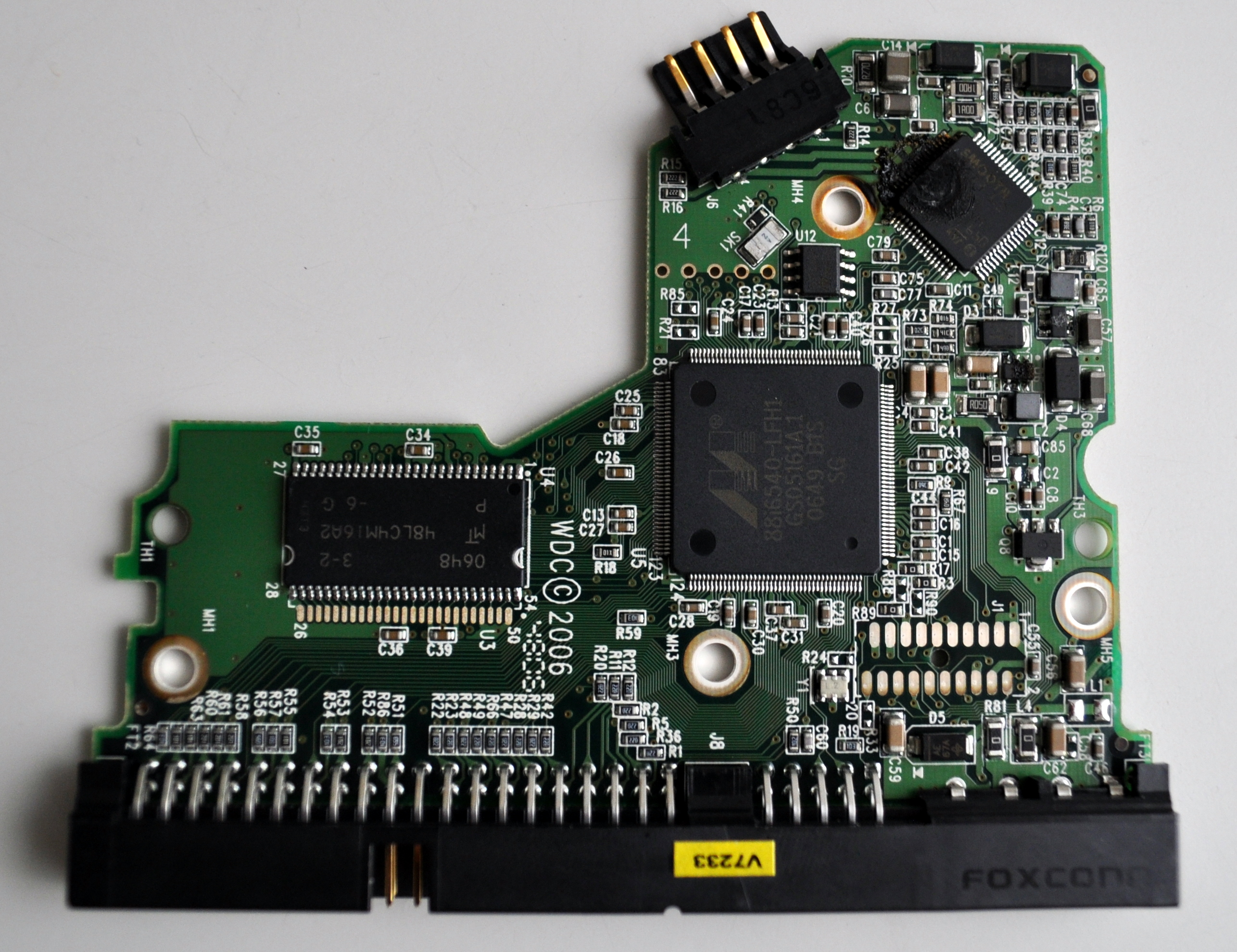

 Post subject: PCB burned on a WD3200JB
PostPosted: May 4th, 2011, 7:40
Posts: 441
Location: italy
on burning the PCB (chip on the picture, not a diode), can happen also some demage to the head' stack or to spindle motor ?
File comment: chip burned
 Post subject: Re: PCB burned on a WD3200JB
PostPosted: May 4th, 2011, 7:44
Posts: 1038
Location: South Africa
This is a common problem, I've had to fix lots of these.
Getting a replacement PCB and swapping the 8-pin chip at U12 should get the drive working again.
Hopefully nothing else is damaged, like the preamp or other components inside the HDA.
PostPosted: May 4th, 2011, 7:47
Posts: 441
Location: italy
exactly, it never happen to you? i am afraid to find it.

All the cases I have had where motor controller is burnt (SMOOTH chip), the preamp has been OK. Just a new PCB and U12 swap and the drive is repaired.
But I have found that when the main controller chip is burnt (Marvell chip) that the preamp is often damaged, so it needs head stack replacement.

the swap of 8 pin chip on U12 for what is needed?

positivebit wrote:
Nick_CT wrote:
positivebit wrote:
Maybe someone else can offer advice....or maybe not. You know, 'trade secrets' etc.
yep, that's sure! :lol:
There are a few options, but I use a heat gun/hot air gun to heat the chip, wait for the solder to turn liquid, then swap it over. Obviously there are risks with heating up the PCB.
Yeah, you might as well replace the PCB anyway, because if you find that the preamp is gone (unlikely) you'll need a working PCB anyway on the road to recovering your data.
