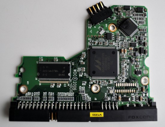

 Post subject: PCB burned on a WD3200JB
PostPosted: May 4th, 2011, 7:40
Posts: 441
Location: italy
on burning the PCB (chip on the picture, not a diode), can happen also some demage to the head' stack or to spindle motor ?
File comment: chip burned

This is a common problem, I've had to fix lots of these.
Getting a replacement PCB and swapping the 8-pin chip at U12 should get the drive working again.
Hopefully nothing else is damaged, like the preamp or other components inside the HDA.
exactly, it never happen to you? i am afraid to find it.
there is a way to test the pins with a tester, by ohm for example ?

All the cases I have had where motor controller is burnt (SMOOTH chip), the preamp has been OK. Just a new PCB and U12 swap and the drive is repaired.
But I have found that when the main controller chip is burnt (Marvell chip) that the preamp is often damaged, so it needs head stack replacement.
I'm sure there is, but I haven't tried that procedure before. I think you'll find that some people say that you can easily damage the preamp by using a multimeter etc, but I'm sure there is a way to do it properly, I just don't know enough about it. I just use a process of elimination, which is normally quite accurate if you have the right tools.

Nick_CT wrote:
positivebit wrote:
Maybe someone else can offer advice....or maybe not. You know, 'trade secrets' etc.
yep, that's sure! :lol:
the swap of 8 pin chip on U12 for what is needed?

positivebit wrote:
Nick_CT wrote:
There are a few options, but I use a heat gun/hot air gun to heat the chip, wait for the solder to turn liquid, then swap it over. Obviously there are risks with heating up the PCB.
Yeah, you might as well replace the PCB anyway, because if you find that the preamp is gone (unlikely) you'll need a working PCB anyway on the road to recovering your data.

thanks to all i will try to swap the chip and pcb.
