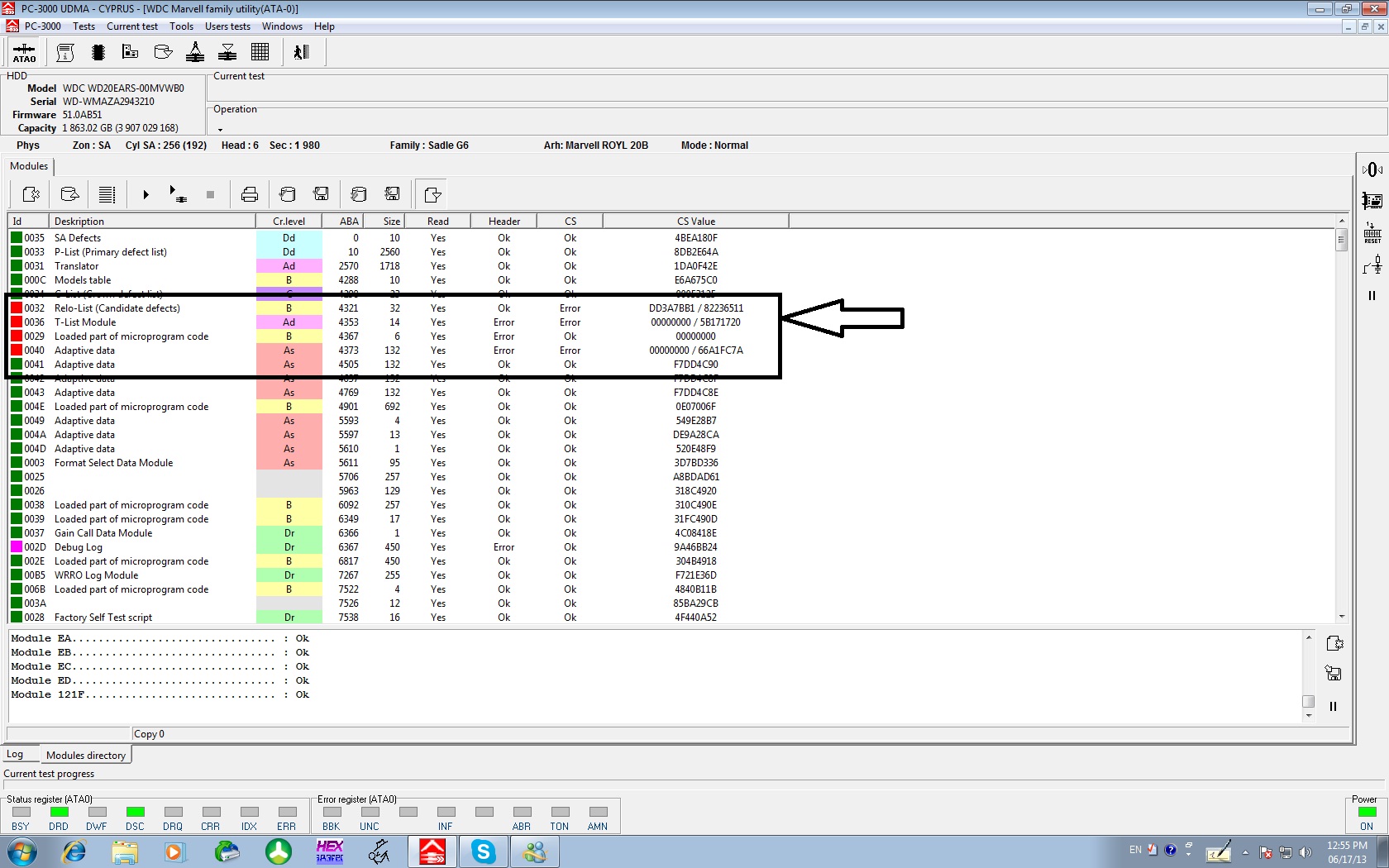

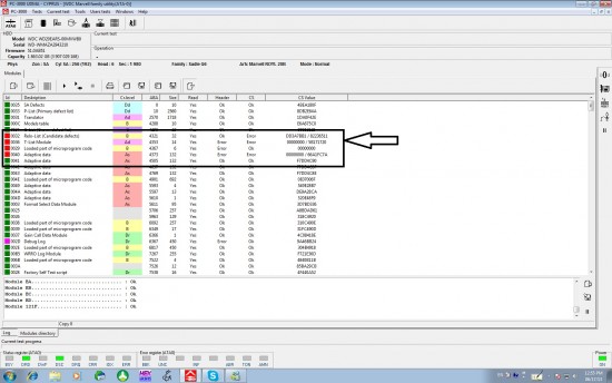

Hi guys,
I have a 2TB WD Elements External Desktop Hard Drive which suddenly stopped being recognized by my computer after it froze when transferring data to it. I took it to a recovery company who attempted logical recovery of my data but told me that the data is unrecoverable as the T-Lists has an error and they sent me the snapshot I attach. The full history of the hard drive is that I dropped it once, though it did not hit the ground, but it worked for 3 months after that without any issues. The recovery company told me that it most likely failed because of the fall. When it stopped being recognized I tried to initialize it under Disk Management in My Computer but that generated an I/O error.
I'm no expert so I wanted to ask you experts out there if there is any hope of recovering my data and also if you have any advice as to what I should do next.
Any help would be greatly appreciated. :D

The T-List can possibly be regenerated from the logs, but it's complicated and beyond the reach of most data recovery firms.
So your question to a prospective data recovery firm is whether or not they have been able to do this procedure.

There are also other strategies... Everything depends on :
- sustained damage
- if the DR firm can do it , also see next point
- budget :mrgreen:

 Post subject: Re: WD Elements
PostPosted: June 25th, 2013, 7:35
Posts: 2984
the damaged modules are marked as read meaning the data within the module is damaged as opposed to the module being unreadable. This makes it slightly more difficult as if modules are corrupt instead of unreadable.
Send to Northwind for a second look, hes very reputable and if your case can be recovered im sure he can get it done for you

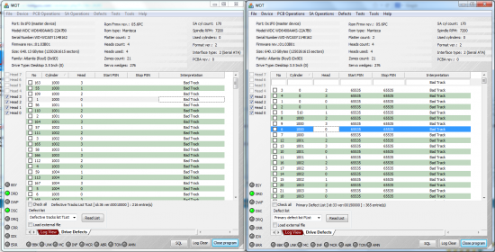

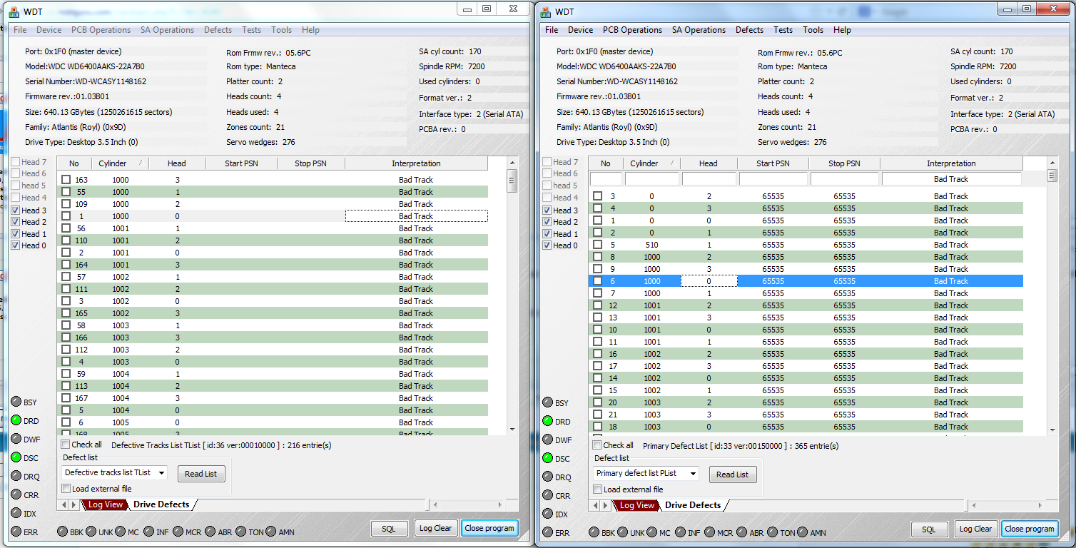

PostPosted: June 25th, 2013, 12:18
Joined: August 22nd, 2011, 15:43
Posts: 209
Location: Romania
the TList seems to be contained by PList.
PostPosted: June 26th, 2013, 11:34
Posts: 2984
Spildit wrote:
All that is needed is module 31 (Translator - Plist)
Your wrong.
You need more than this, even more so on Sadle G6.
Also, 31 is translator, P-List is 33.
PostPosted: June 26th, 2013, 13:23
Posts: 1744
Location: Verona, Italy
Hey Louis, are you the author of WDT?
:D
I like the graphic.
My firmware database:
PostPosted: June 26th, 2013, 14:08
Posts: 209
Location: Romania
hddguy wrote:
Your wrong.
a quick format with P&G list should fix translators.
the problem is with the adaptive mod 40 which is red.
