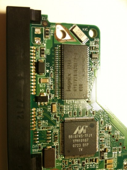

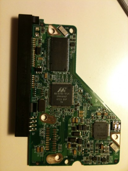

I made a lot of attempts to restore data on my WD5000AAKS-00TMA0 (was broken: not spin). Look at here for the model pictures.
First of all I've tried to change the PCB (I bought another identical HD on ebay) but the moherboard not recognize it (later I read the unique firmware issue).
Then I read the TVS issue. I compared the values with the same TVS in the new one (with Multimeter), I get an error and I removed it (D4). Then HD starts to spin but the motherboard not recognize it. ;-(
Now, which could be the problem?
Thanks a lot!

There is no external ROM on this model. ROM is embedded into MCU and requires specialist tools to resolve this matter.

CK is correct, there is no ROM (see empty space at U12!)
NOTHING can be done DIY on this, needs pro help.
Shouldn't be expensive AT THIS STAGE IF NOT FIDDLED ABOUT WITH.

when it all fails i guess its the Motor chk it, the Motor IC probably
you will need to be more than Pro. to do this task, DIY is not the key here

After removed the TVS the drive start to spin. First it was dead, not spin. Indeed when I tried to connect the drive to the PC the power supply go to protection mode.
So, the drive just spinning but it's not initialized. I can listen a silent constant noise (tic... tic... tic...).
