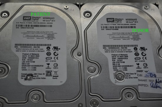

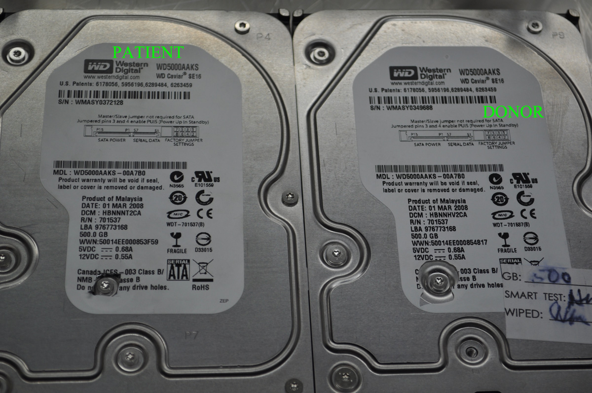

Hi i am not sure about head compatibility, i have got the same model, the same date, same country, but the DCM is slightly different.
about static i was grounded, and i opereted in a clean bench.
i checked the donor, and it had not bed sectors, even if the firmware was not all readable.

hi, i made this test: i put again back the HSA to the donor, and the drive works i can write and read the files and forders by os.
so at this point, i guess, it can be only the compatibility issue..
HBNNNT2CA may be is not compatible with
HBNNHV2CA (patient)

If you have a seach around you'll see that some people say that 6th character of DCM relates to head stack, so in your case they are different. Perhaps that's the problem?
I've had alignment issues with 80GB WDs, and you're working on a 500GB where the density would be higher, so I'm surprised you're not having alignment issues when you put the original heads back. I've heard that only certain families of WDs have this alignment issue, but I don't how know true this is. I think this is something that can only be figured out by practice and trial and error, no one will share this info.
