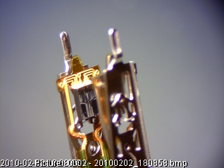

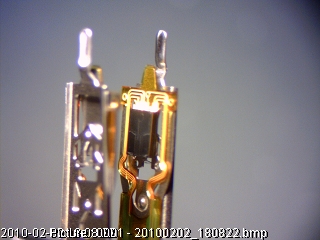

i will open it and look at the platte 0

I do not know witch one are you talking about ;) but anyway here it goes the heads in pictures
Also the Platte 1 have a very small scratch in the park zone
Anyone knows witch head in this model read the SA the H0 or the H1 or both ?
