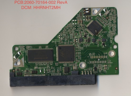

I have three Western Digital WD15EADS. A lighting storm hit and fried my sever and everything in it. I looked at the PCB and the same chip fried on each board.
I found the website hdd-parts.com but they do not carry the board I need. Can anyone help?

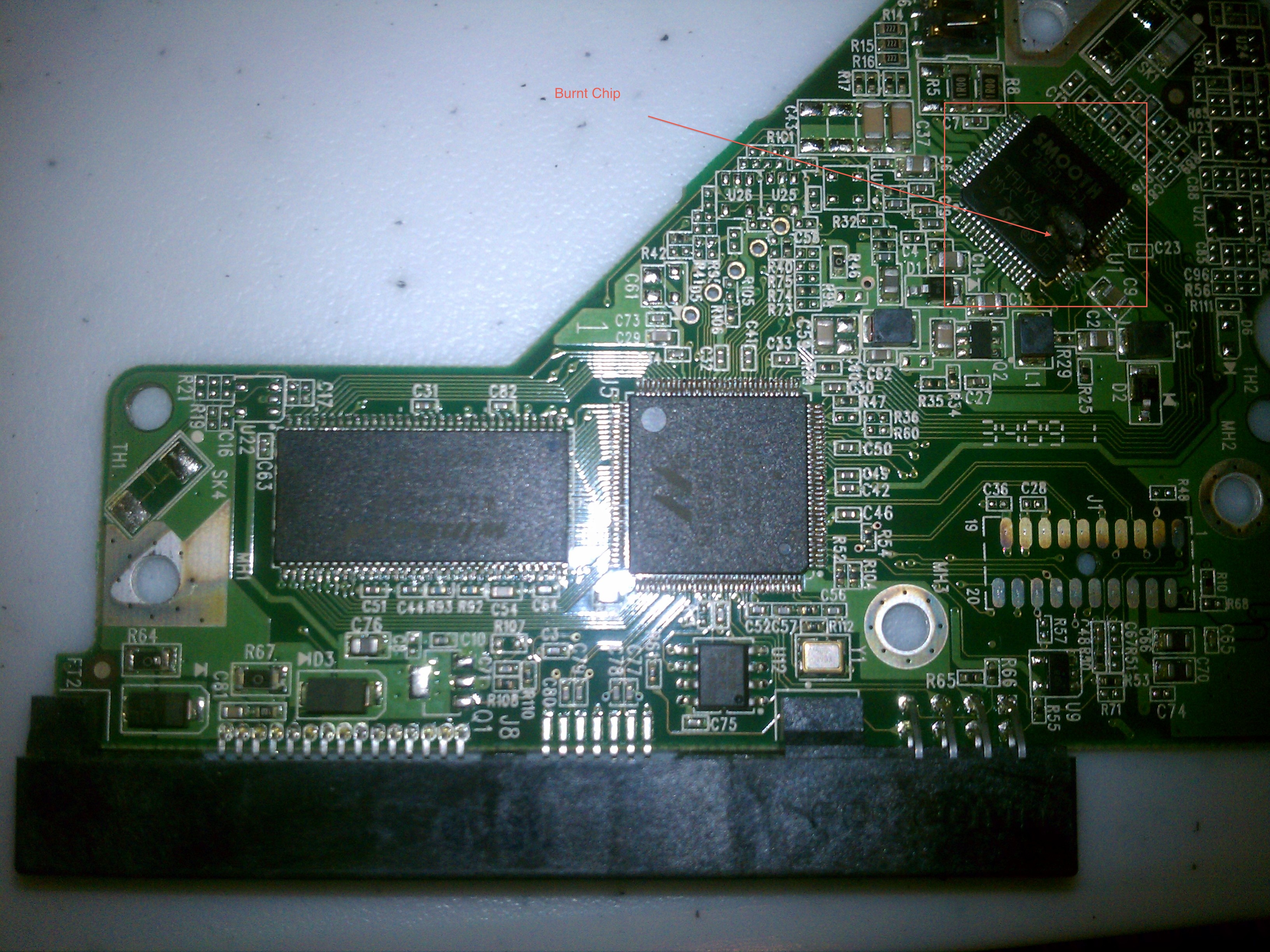

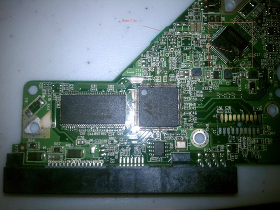

Here is an image of the PCB chip that burnt. It as the same chip on all 3 boards.
File comment: Chip that fried
 Post subject: Re: PCB replacement... Unable to locate PCB!!!!
PostPosted: May 17th, 2011, 9:13
Posts: 17352
You are lucky in that your board has an 8-pin serial flash memory IC at location U12. This chip, or its contents, needs to be transferred to your replacement board. Your local TV/AV repair shop should be able to do this for you. Otherwise some PCB suppliers will include a firmware/ROM transfer for US$10-$20, or even for free.

Move the U12 to Donor PCB and ur done
thats all
and plug and pray , nothing else is defected :wink:

If your data is valuable, I think you should go into a pro, as any other actions could result also in further damage.
If it's not too valuable, you can try to find a donor PCB and swap ROM chip (U12).

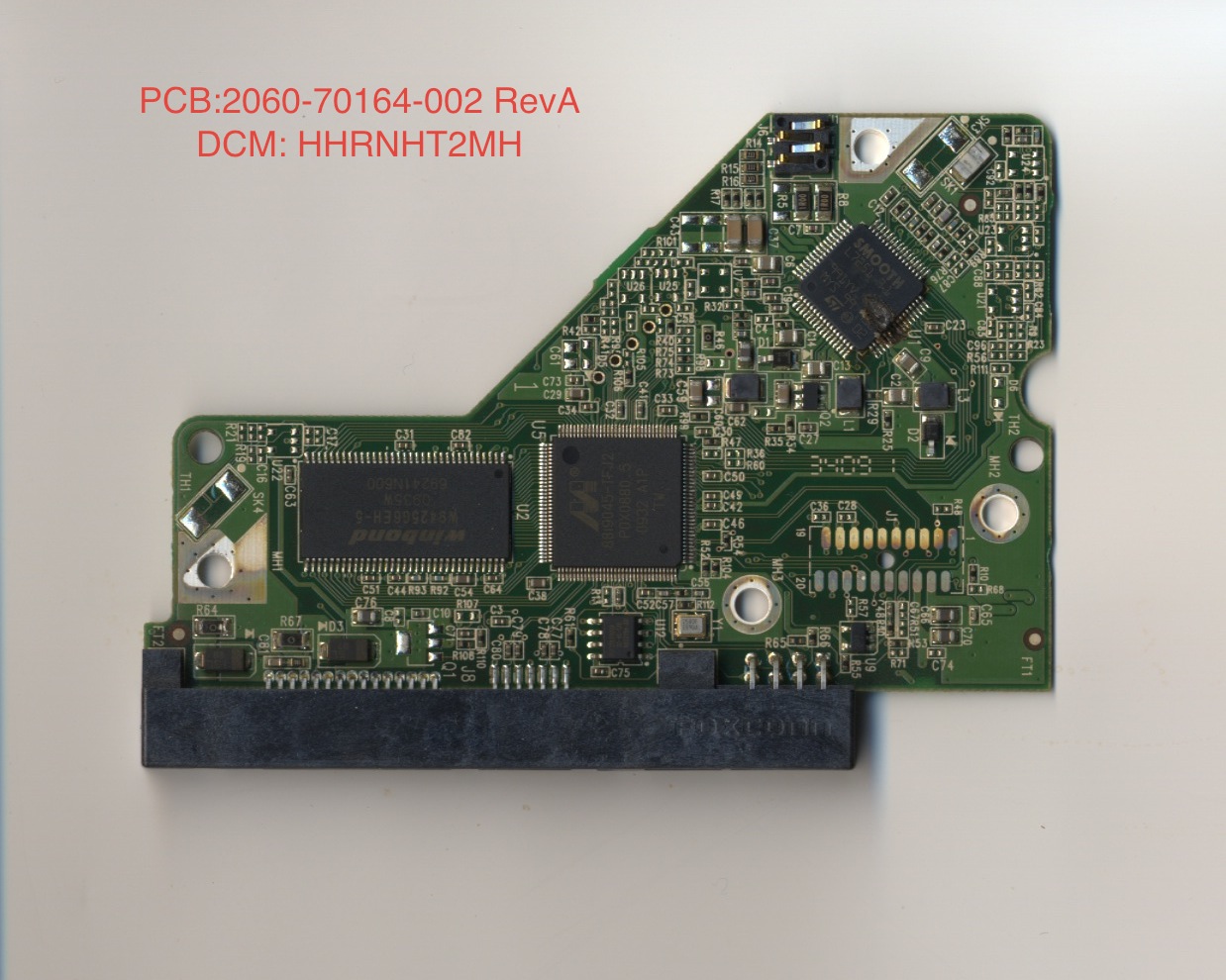

Yes, you'll need to match the PCB number as well as swapping the 8-pin U12 chip.

AIUI, the DCM number is important when matching the internal parts, but not when matching the PCB.
BTW, your problem really only requires a simple board swap and chip swap (or reprogramming in situ), not a "data recovery". If the DR centres are gouging you for this trivial service, then look elsewhere. If you take hdd-parts.com as your guide, then you shouldn't need to pay more than $70 per board. In fact you should be able to use the one board for all three drives (with three chip transfers).

without checking preamps u put your data to risk if u just replace PCB even with ROM transfer
Find some literature here
look and decide. I must add that not all DR firms begin lightning shot drives with checking preamp, so u cannot be sure anyway :(

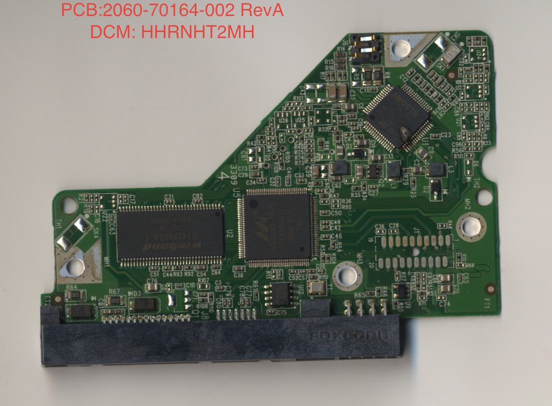

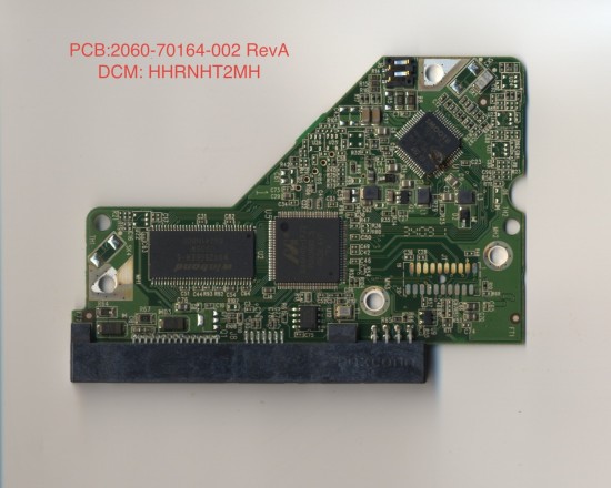

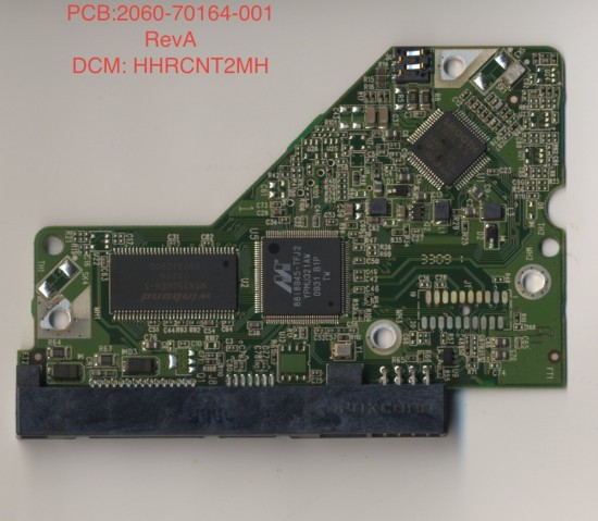

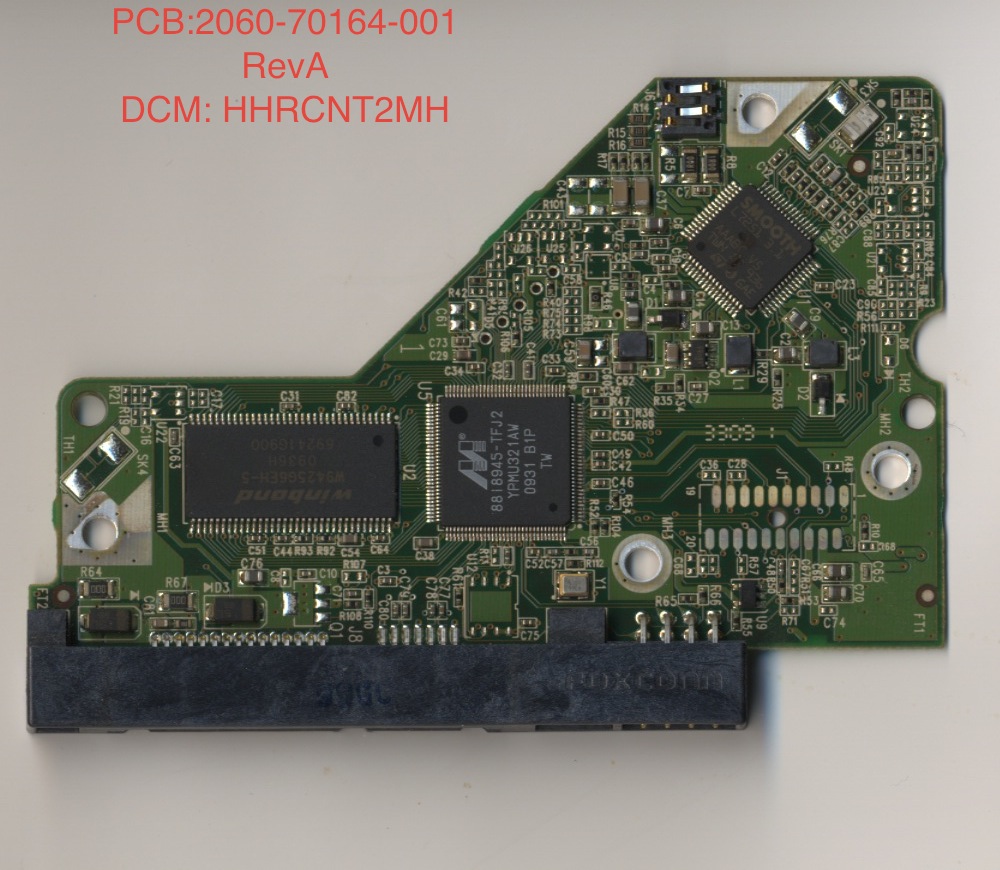

Because I have gotten many request for all the board pics. Please see the attached.
File comment: 1st
File comment: 2nd Board same numbers
File comment: 3rd

pepe wrote:
Hi
I would place a warning here.
regards,
While that Post makes sense, is there a guide anywhere to help with checking?
