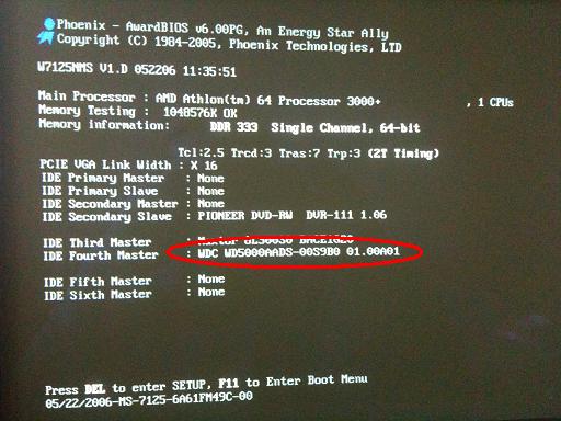

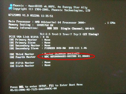

I have 2 Western Digital 500GB HDDs, one of them works just as should, and looks like this in my systems boot screen:
download/file.php?mode=view&id=3592

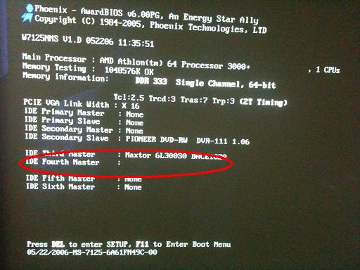

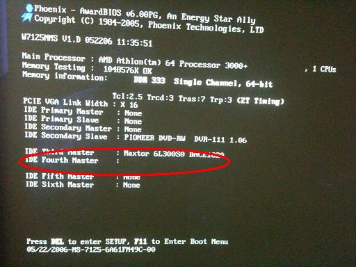

but the second one stopped working some days ago, I started the system & it restarts every time after showing a fast Blue Screen of Death for half a second, right when windows logo with it's loading bar is showing
and the HDD shows up in boot screen like this:
download/file.php?mode=view&id=3593

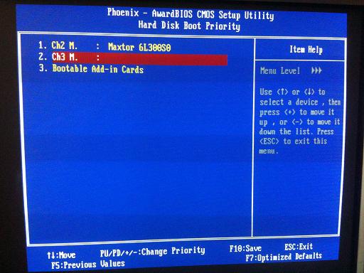

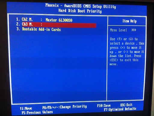

and the same, in BIOS boot priority settings screen:
download/file.php?mode=view&id=3594

There is little chance of you fixing this yourself, and you are likely to need the services of a DR company - but just to gather some more background info:
- the "problem" drive was inside your system when it failed - is that correct? (I mean, this was not an external drive which failed, and then you moved it into your PC.)
- listen carefully compare the noises between the "problem" WD drive and the "good" WD drive, when power is applied. Does the "problem" WD drive make the same noises, as the "good" WD drive? Or is it completely silent (no spin-up)? Or is it making some repeated "click click" noises? Or something different?
FYI, since the "problem" drive is not responding properly to Identify Device command (that is what the BIOS uses to provide the information which should be shown there), then it cannot be used with Linux either, which is why you did not succeed with that. :(

Well, I guess you're getting "BLANK" instead "none", but clearly the disk is unable to communicate basic information about itself to the computer. Probably an SA issue. Time to look up some DR companies.
