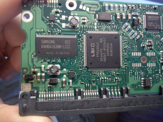

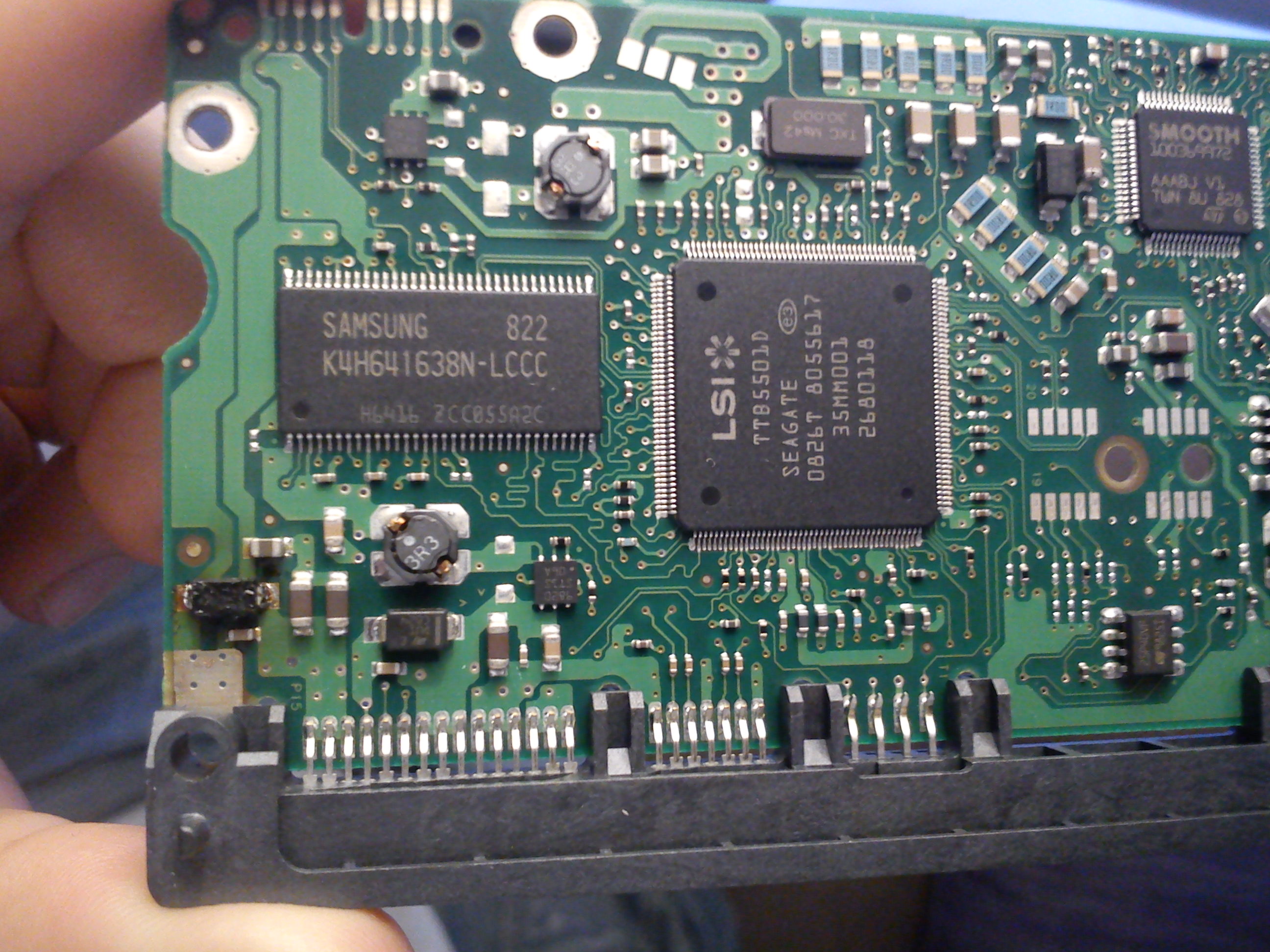

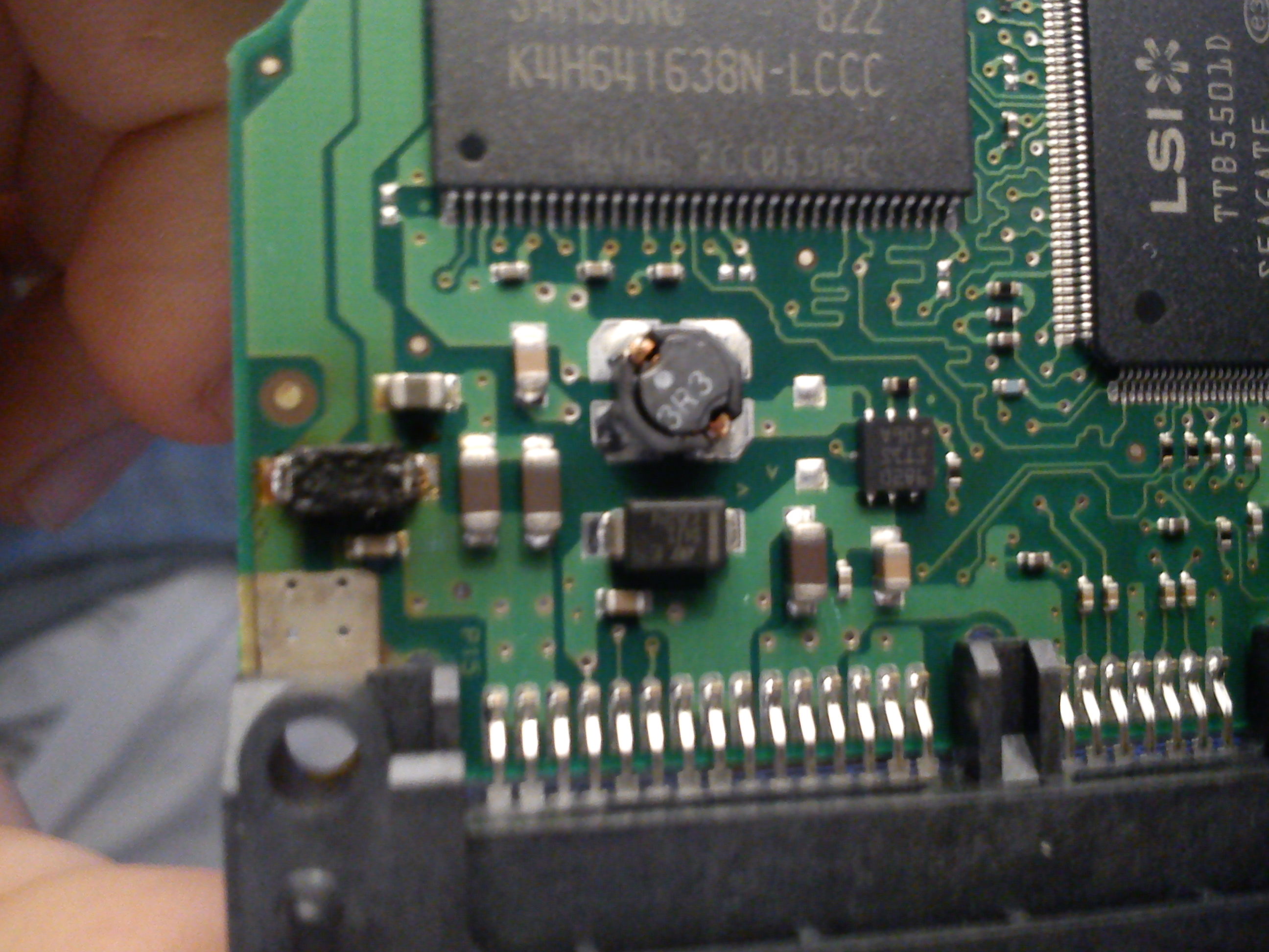

A friend of mine plugged in the wrong adapter and fried her external drive. I opened the case, took out the HDD and checked the PCB. I know of the D3 and D4 5V712V diodes but here there isnt anything printed on the PCB!
There are 2 components that look like TVS diodes near the power connector on the PCB. One is marked something like DUI C824 and the other one is burnt but I can make out KVD at least.
Anyone familiar with these PCBs?

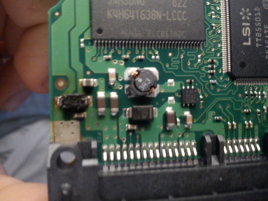

Here are a couple of pics. The burnt component is to the bottom left. If this is like the D3/D4 on other PCBs, can I replace it with a VISHAY SMBJ12A/SMBJ5.0A?

It is indeed a TVS diode and removing it should solve the problem, unless other components are also damaged. If you try and power it up after removing it make sure that your power supply is 100% as you have removed the protection from the PCB. Just be careful.

Ok, well can't I replace it with a VISHAY SMBJ12A or SMBJ5.0A? Can you see which one is burnt (5V or 12V)?
 Post subject: Re: Burnt Seagate disk - Need help identifying burnt components
PostPosted: May 23rd, 2011, 6:25
From the picture the left one is KO for sure.
The concern is the rest of the circuit (to be tested) but don't want to say nothing about it :roll: . Just be aware that if you fry preamp or ROM what it was let's say "100" becomes "500".

Anon wrote:
Yea, I mean if you can see if the left one is 5V or 12V.
To answer your question, it's the 12V TVS (you can use the SATA power pinout, if you want to confirm this answer).
IMHO it would make sense to use a multimeter to check the 5V TVS while you have the PCB removed.
Note the risks mentioned too, and take all possible ESD precautions.
