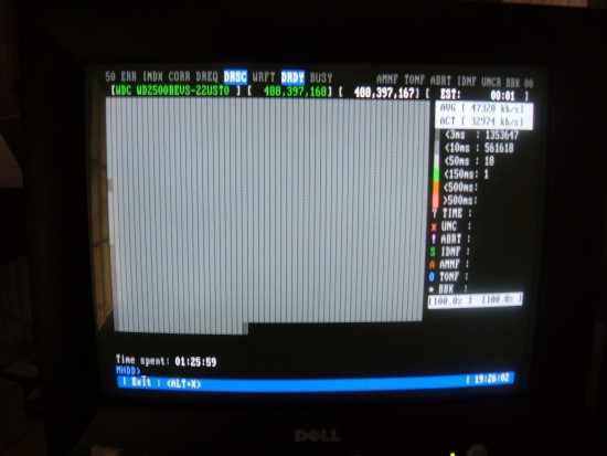

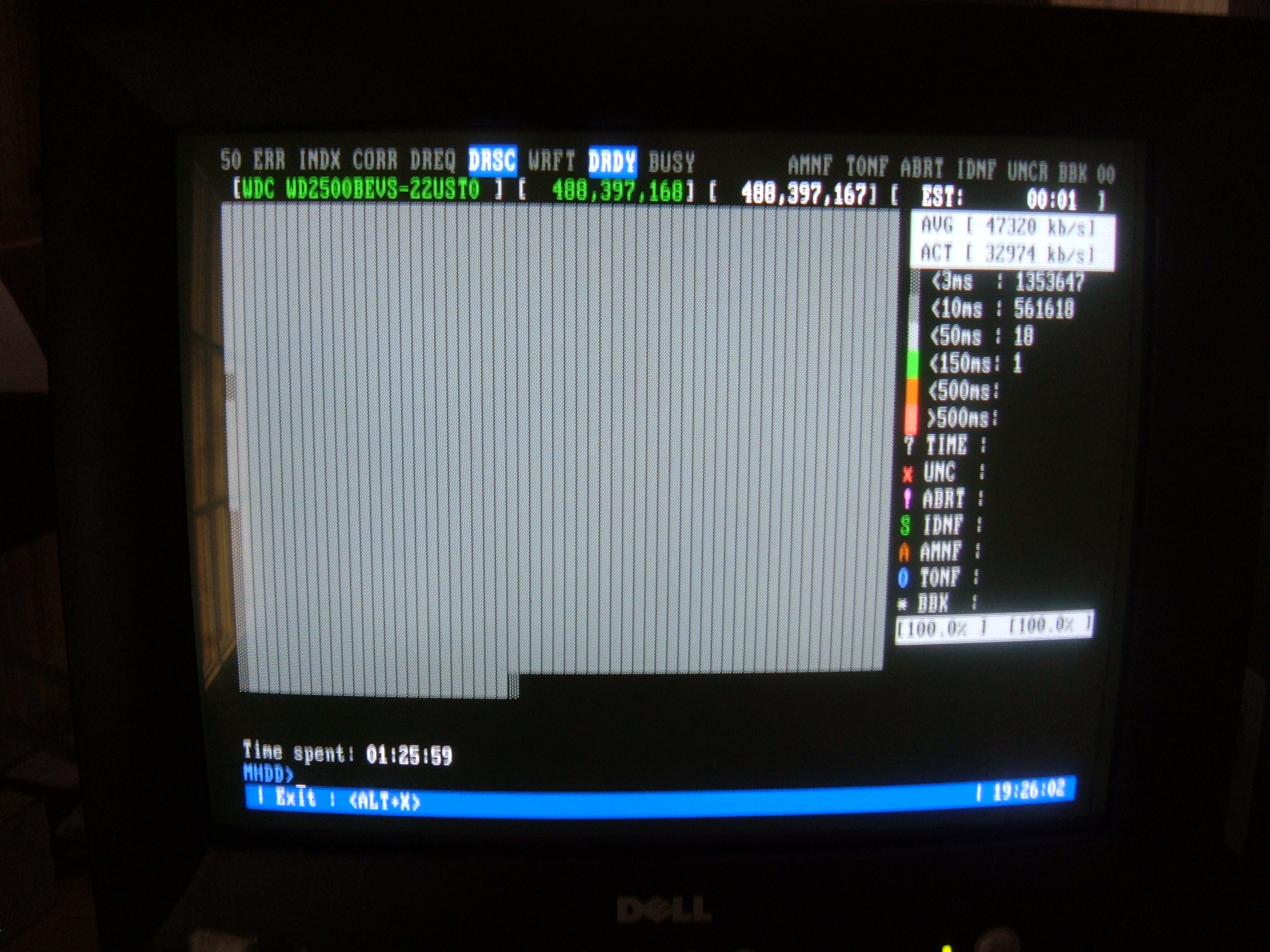

This drive came out of a laptop that would post and then leave me with a cursor and that is it. I pulled it and was able to back up users just fine, no issues at all. Below is the MHDD report I got. The one 150 ms block that came up was right at the beginning of the readout, like the first page. I don't know if that caused windows not to boot or what.
Attached is a photo of the report screen. What I'm looking for is to know whether or not to reuse this drive or not being that there was only one colored block in the whole report.
If I should run some other tests on it, let me know what to run.

use erase waits command. drive looks to be fine.

I agree with HDD Spaz that there is no obvious problem shown in that MHDD scan output.
There is one other thing I would do to increase confidence in the drive, which is to read and review the drive's SMART data.

This drive is fine.
I think some virus or other problem caused the OS die.

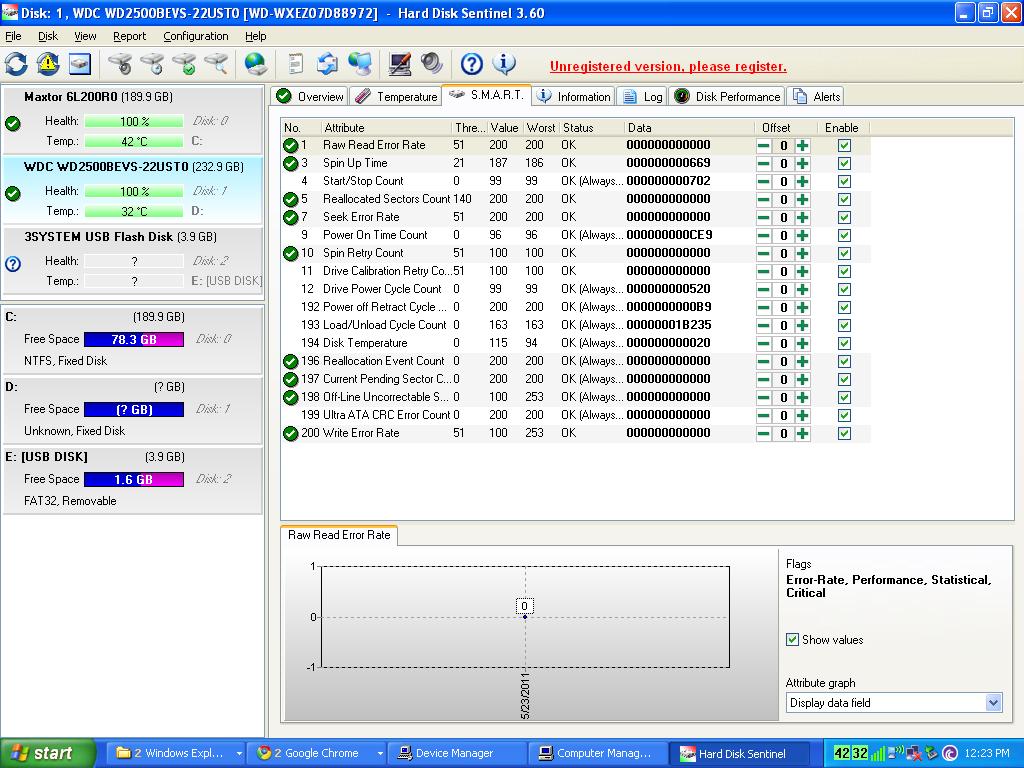

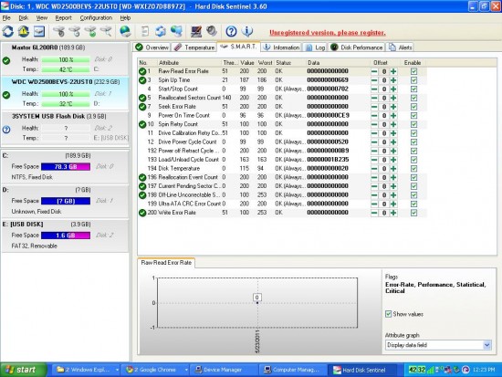

Vulcan asked about SMART, I have attached a jpg of that as well.
everything is showing healthy, so why am I having problems formatting?
I agree that there is no obvious concern with that SMART data (although as with any "good" test result, this result does not prove that no problem exists :) ).
