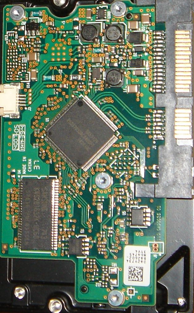

Hello, I have a Hitachi HDP725050GLA360 500Gb hard drive that stopped working. I'm trying to find a pcb for it, but without much success. If anyone has a pcb, or knows of a place I might be able to find one I'd really appreciate it. Thanks

Stopped as in it was running fine, then quit, the system bios doesn't see it anymore nothing. The drive doesn't power on at all. I have looked on ebay, and i can't find one with the same pcb, I have seen a dozen or so with the same model number, but the pcb is different.

would you like to post pics of your PCB here?

I've looked the board over and don't see anything wrong with it, so I'm really just guessing that it's the problem. The drive made no clicking or other odd noises it just stopped like the power was turned off. Before anyone asks yes I did check and make sure it was getting power, the sata cable, ect.

Check the larger two black TVS components at D2 & D3, then should be open and not short.

no no, the owner didn't sad, the pc won't powerup when connected, or burned/smoked, and this model don't have fuse in the pcb.
The problem must be the NVRAM as usually or another but non-serious problem.
If the PC was normally shotdown, the heads must be in the right place, but if not, like bluescreen happened or freezed or similar, than the head stucking can be, but i don't think this have too much chance.
Anyway DON'T OPEN THE DRIVE if you want to get your data back without paying 2000$ or more for recovery.
In this case, the price can be much more cheaper until you opening it.

Not ALWAYS true, I've come across cases where one of the TVS's have been triggered and prevented the drive from spinning up. No sign of burning or preventing the PC from starting.
It wouldn't "hurt" to check would it?

Very true,
I had exact same problem with a drive yesterday. Client opened disk so theres a lot of bad sectors but removing TVS got it working.

If the TVS shorted, there is 2(+1) case:
1a. have fuse, still good, and the PC will not power up, or will smoke.
1b, have fuse, fuse blown, the PC will start up, the drive not spinning.
2. have no fuse (like this one), TVS short: PC will NOT poweron, or will smoke definitely.
There is no other options, or if you have any, please post a picture from pcb!

I had the same issue until I tested the large TVS and found a short.
I desoldered the faulty component and got my data back.
