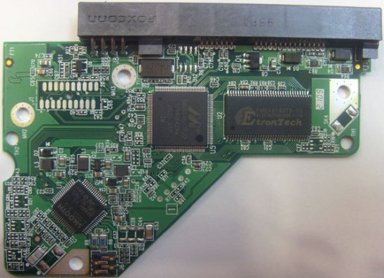

hello
please reply
U12, is this ROM ic, if yes, we have to swap u12 if we are replacing pcb,
thanks
 Post subject: Re: PCB#2060-701590-000 REV A
PostPosted: June 2nd, 2011, 16:42
Posts: 2288
Location: In ur HDD !
There is no U12 in this pcb in this pcb mostly ROM in the MCU .
