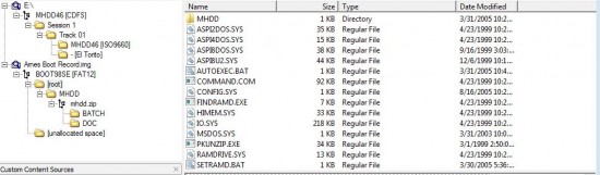

I downloaded the MHDD iso file mounted it with magiciso utility then used another program to extract files from the ISO and see whats there. See image below the iso is booting up with Windows98SE and running in DOS mode which is understandable. I don't see the mhdd.cfg file in the dir structure anywhere. Maybe there is a way to add that at the mhdd command prompt ?

Yes you are absolutely right. At the MHDD command prompt if you type in DIR the next tree shows CFG <DIR>. I'm sure it is in that directory, but I can't find (don't know) the next DOS command to open up that directory. The CFG file is made after the first (initial) run of the program. I looked at a forum post from a few years ago how-create-the-mhdd-cfg-file-1870.html and it actually shows the wording of the .cfg file and the one change I need is False to true and bingo

OK why not download the floppy image version of MHDD create the floppy then run MHDD exit then cd\cfg dir then change the config file and re-launch MHDD. It seems the cfg dir is created at first launch. I am getting the idea now your running it from Hirens and the dir goes away each time you exit which changes on the fly as it runs etc.
