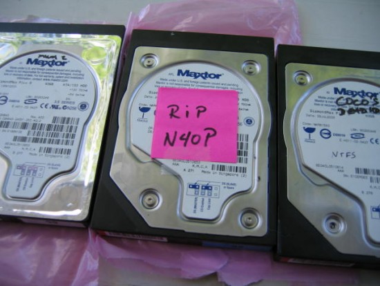

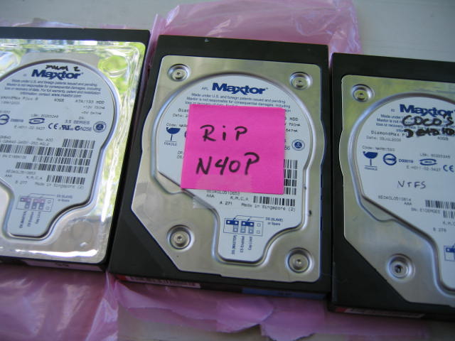

More bad news :cry: ... I plugged it in another computer, bios shows N40P. By reading on this forum it seems I can't do much more except find a pro in Canada (or maybe US) - any other options?
Mhdd is of little help, it says it won't work with this drive. By contrast, mhdd works perfectly with 2nd healthy donor drive...
DC

What an active little thread this turned out to be.
When I wrote about Scott's videos I merely wanted to point out this: none of you experts are going to lose money, simply because people like me are not going to deal with a professional for 50 family pictures and a couple of Word documents that we didn't back up. Now, for valuable data... that's a different story.
That being said, my own little experience with other forums (photography, linux, wordreference, etc.) lead me to believe that some communities like to share their knowledge with interested people. I am not going to quit my day job and start a DR business, but as I clumsily wrote earlier, I am a curious person (maybe due to professional bias) and for that sole reason I tried to salvage my drive and in doing so, I learned about a very interesting topic.
In my last post I asked for options in case I missed something (since I don't honestly think I can read ALL related posts on the subject).
For the time being, I offer my data to Hades.
