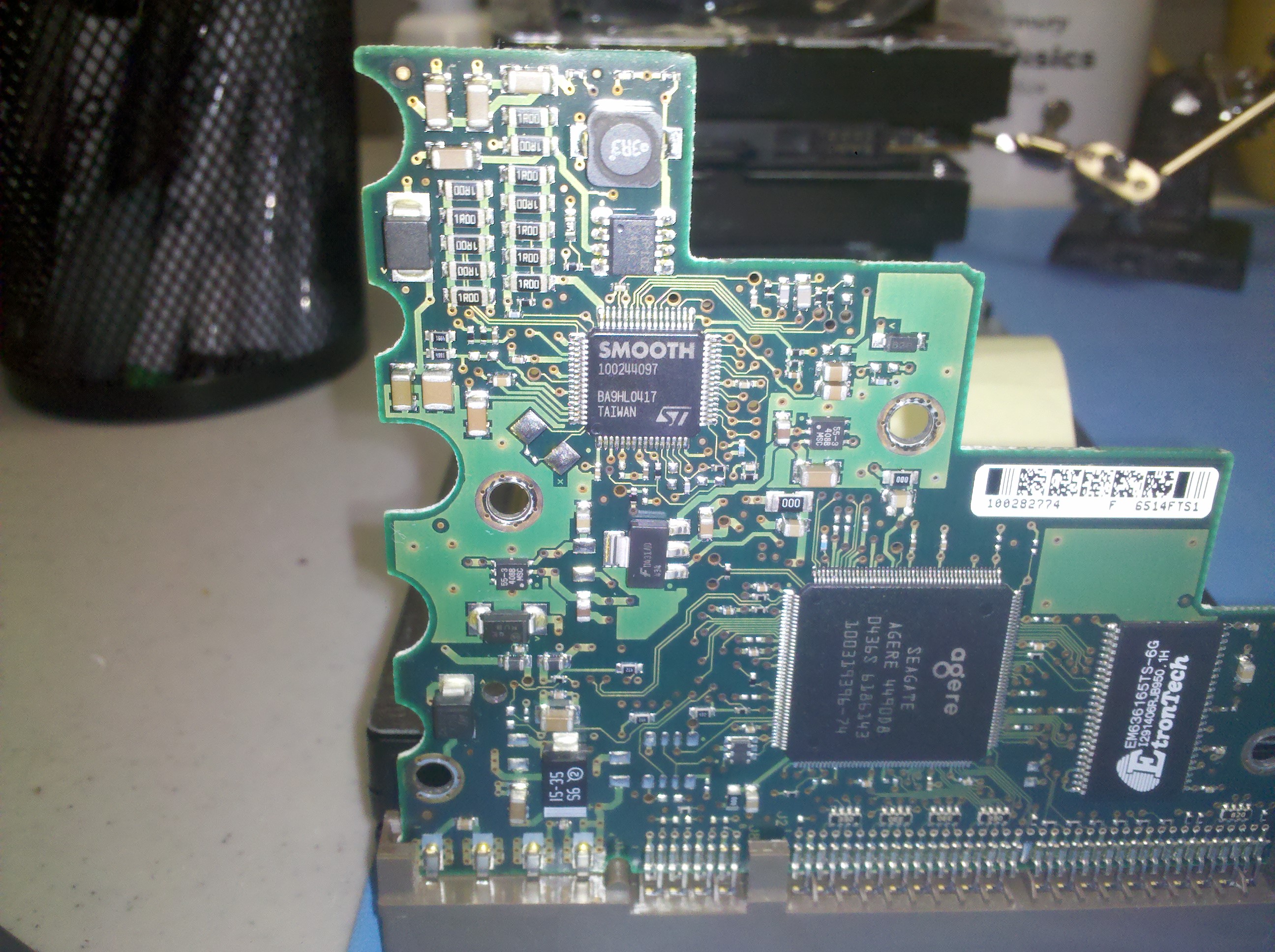

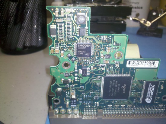

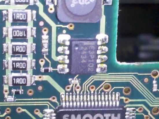

I have a ST380011A that doesn't spin. With a donor board on it, it spins up fine (doesn't ID though). I was wanting to try a ROM swap, but don't see a standard one (starting with "25P") and was curious if it was embedded or not. Please see the picture below and if anyone has any advice, thanks in advance.

Rom is masked into the MCU, better to connect serial port and see the terminal output.

you need to match the main controller chip too. `AGREE` in your case

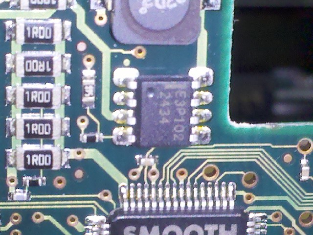

 Post subject: Re: ST380011A ROM
PostPosted: June 8th, 2011, 9:56
Posts: 17230
FYI, that component is a FETKY.
NTMSD3P102R2, ON Semiconductor, marking E3P102, FETKY P–Channel Enhancement–Mode Power MOSFET & Schottky Diode, Dual SO–8, –3A, –20V, 0.085 ohms:
http://www.onsemi.com/pub/Collateral/NTMSD3P102R2-D.PDF
http://www.datasheetcatalog.org/datashe ... 02R2-D.PDF
See my HDD IC database:
http://www.users.on.net/~fzabkar/HDD/HDD_ICs.txt
BTW, I believe the buzzing is referred to as "Spin Buzz". AIUI, the SMOOTH chip is trying to kickstart the motor.
PostPosted: June 8th, 2011, 19:10
Posts: 17230
There is no reason to consider the TVS diodes. If either were shorted, then the board would not power up. FYI, the 5V TVS diode is marked "QE" and is located above the locating hole at the bottom left corner of your second photo. The larger 12V TVS diode is marked "BUX" (?) and is to the left of the same hole.
See my notes:
http://www.users.on.net/~fzabkar/HDD/TVS_diodes.txt
The MCU is always (?) the largest chip. In this case it is the one manufactured by Agere.
The repeating spin buzz would suggest stiction or a seized spindle. It could also be due to a bad motor (open or shorted winding), or bad MOSFET drivers in the SMOOTH chip's output stage. A board swap would eliminate the latter. You should measure the resistances of each of the motor windings. I would expect something in the order of 3 ohms.

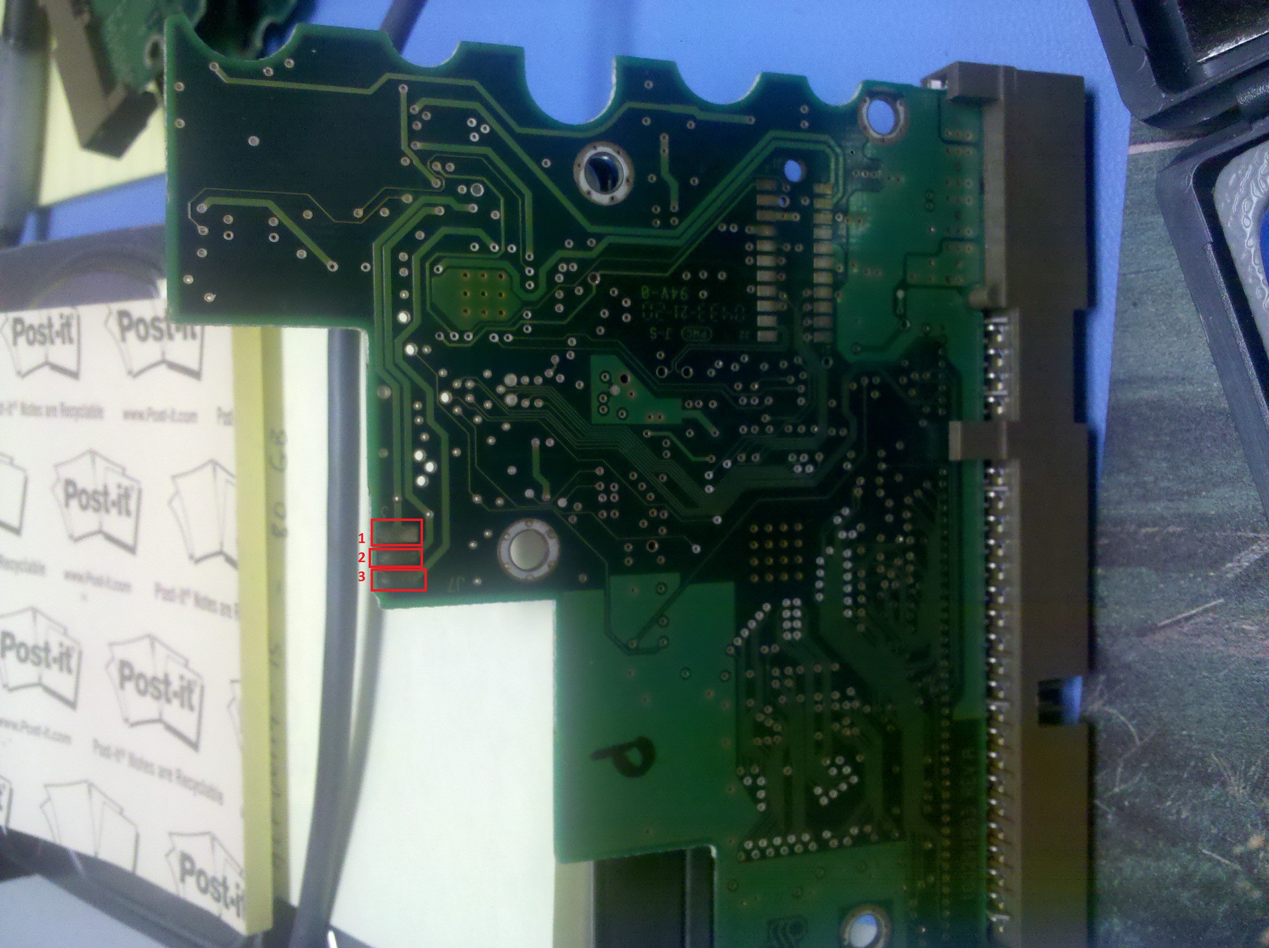

@fzabkar,

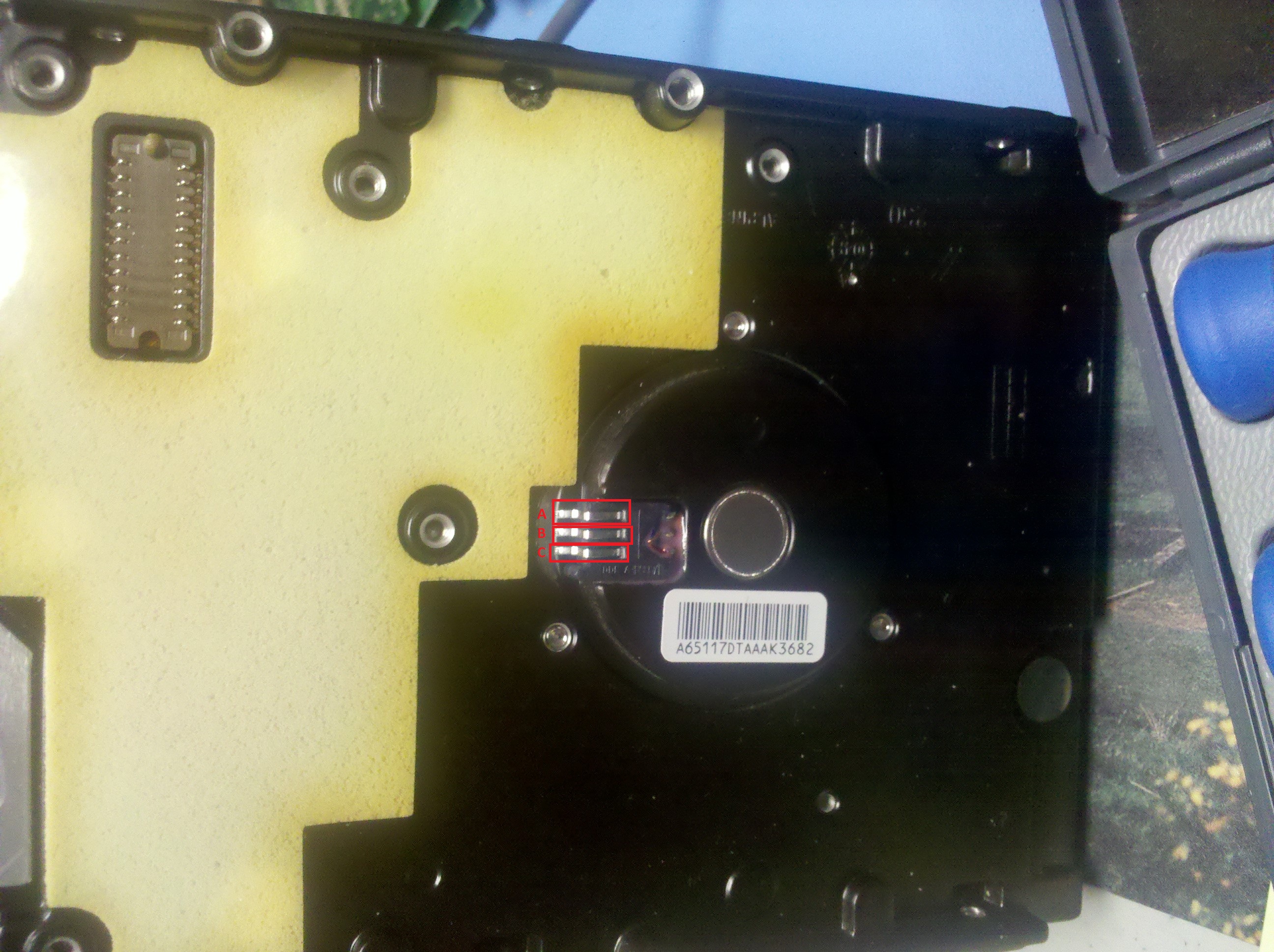

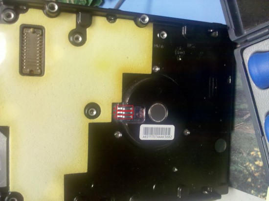

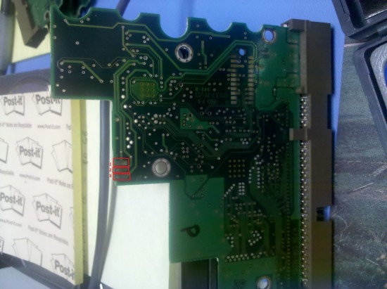

The motor windings (A,B,C in first attached) all come back with 3 ohms across one another (A-B, B-C, A-C). However, I'm not sure what you wanted me to measure when you were suggesting 6 ohms readouts... Are the parts labeled A, B, and C the phases, or are they the commons? Can you please label which parts I am supposed to measure?
Also, on the motor contacts you mentioned, I assume you mean the contacts labeled 1, 2, and 3 in the second attachment? If so, just to clarify, I apply power to the drive then measure the voltage from the ground on the power pinout to the motor contacts individually? Just making sure, as not only am I concerned about blowing any components on the board, but also the ground pinouts are on the component side of the board, and the motor contacts are on the reverse side of the board, and throw in powering on a drive right at that split second makes for a procedure with lots of room for errors (i.e. requiring a few practice tries on parts boards). And measure A/C voltage, or D/C?
PostPosted: June 22nd, 2011, 1:28
Posts: 17230
Your motor measurements are fine. The important thing is that the three readings are identical, and are within the ballpark.
The older motors had three phases (A,B,C) plus a common terminal. Yours does away with the common. My estimate of resistances was based on a motor than was at hand. Its phase-to-phase resistance was about 5.2 ohms. This means that its resistance, per phase, is about 2.6 ohms.
As for your question regarding voltage measurements, I would first try measuring the 1,2,3 terminals with the board disconnected from the drive. Afterwards you could take the same measurements with the board on the drive, but you will need to use other, accessible test points.
I have procured a similar PCB and will upload the motor test points as soon as I can confirm their locations.
Edit: Not yet confirmed, but I believe the following is correct:
http://www.users.on.net/~fzabkar/HDD/ST ... or_TPs.JPG
