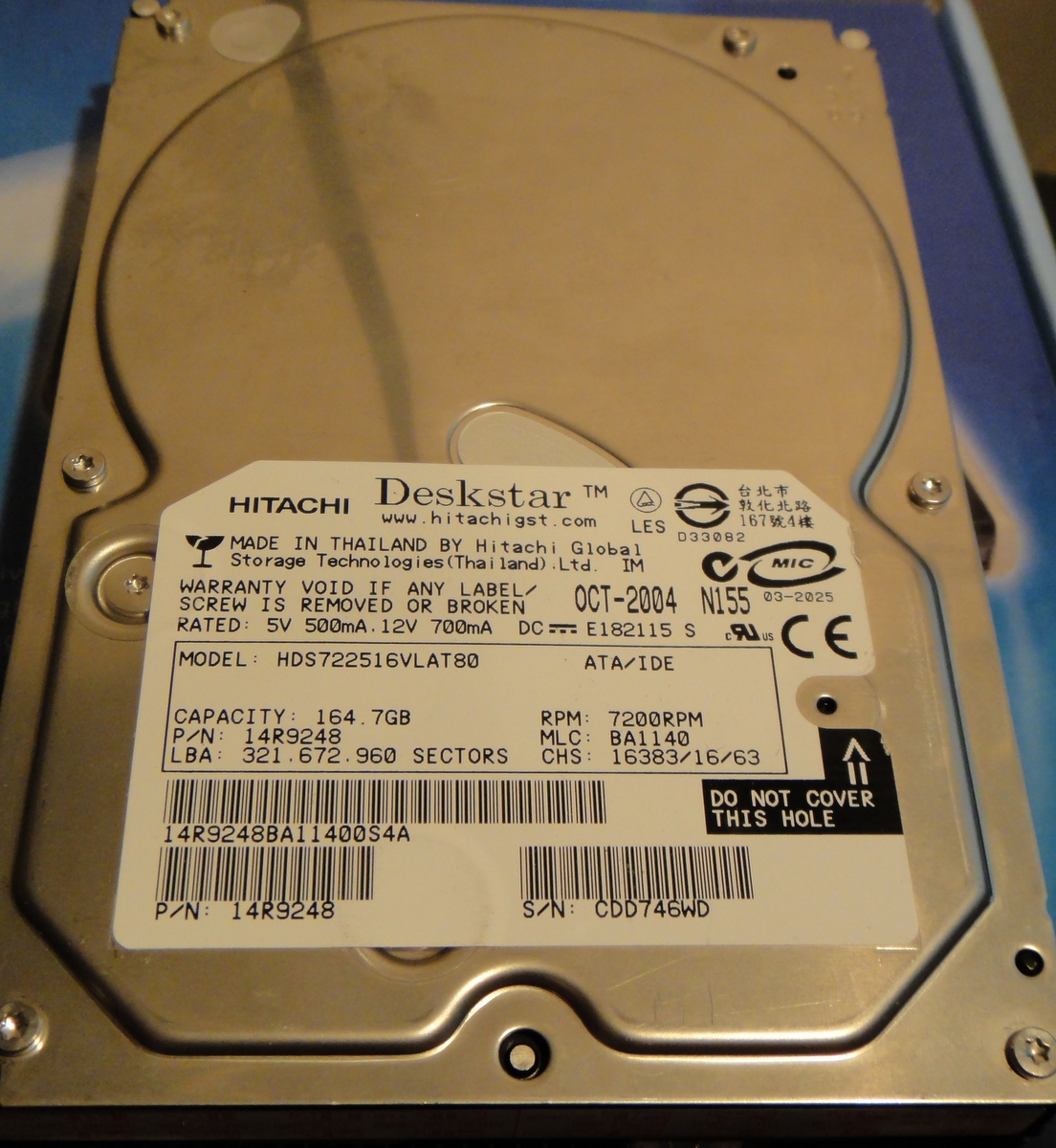

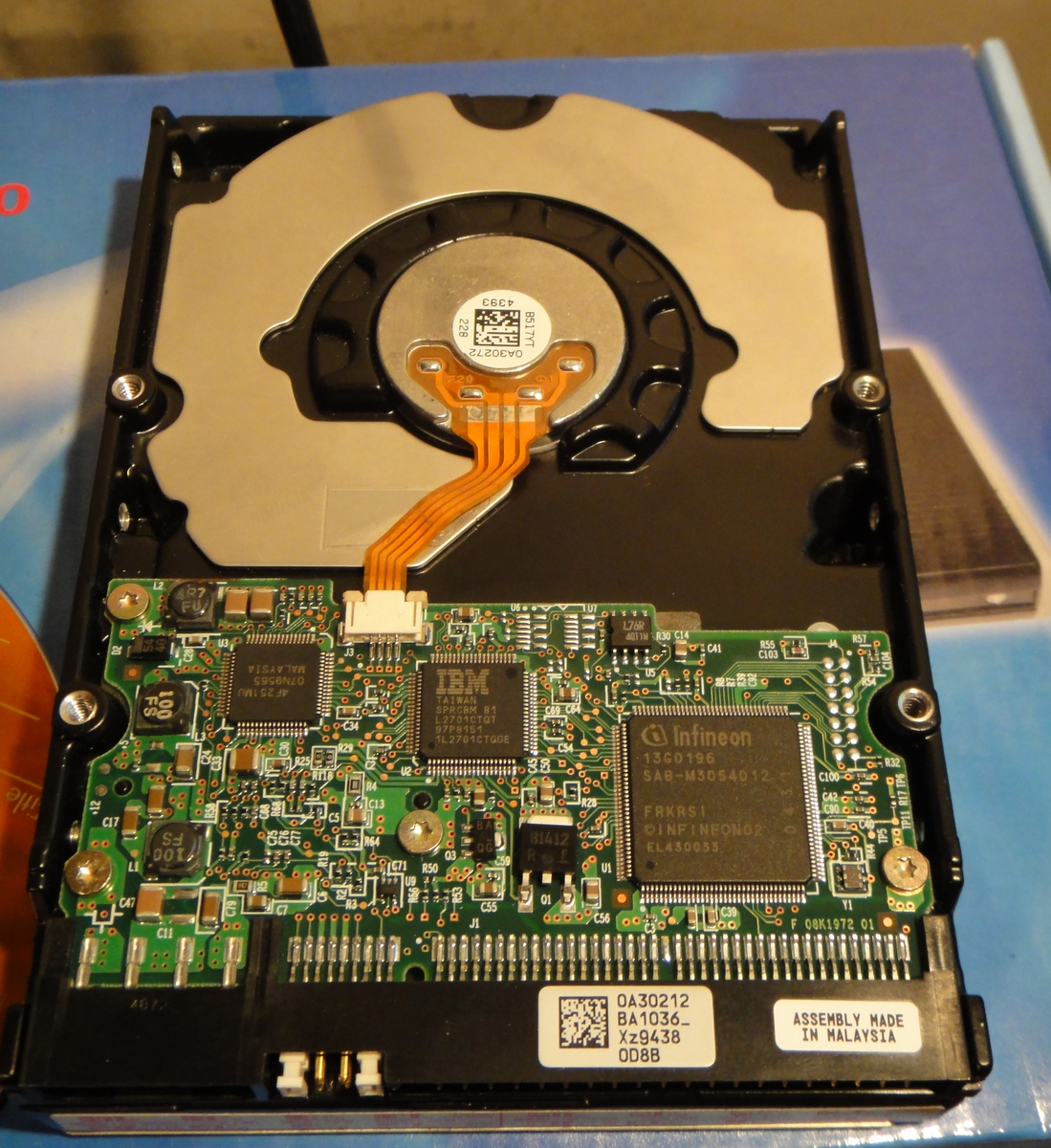

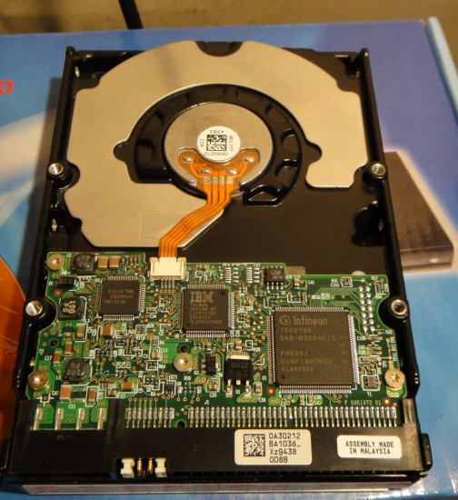

Team, I need your expertise!
Here is the story: I have a 164.7GB IBM/Hitachi Deskstar HDS722516VLAT80 hard drive that has refused to spin-up and work. To my knowledge, the drive has never been dropped and the platter's I believe are in good shape. Ironically it has a few years worth of old backups and a clone of it accidently got repurposed. The drive is NOT detected by the BIOS and does not audibly spin-up when using the original PCB.
My first step was to read ... so I read everything I could find including these 2 posts:
repair-hitachi-pcb-t6975.html
hitachi-deskstar-hds722516vlat80-not-spinning-t10715.html
I also got my hands on another almost identical drive. Same model, same P/N, but different data code (DEC-2003) and a different MLC.
I was way to excited to swap PCBs when I got the almost identical drive that I failed to test if the almost identical drive would be recognized by the BIOS. Regardless, the almost identical drive spins-up and, swapping PCBs, spins-up the failed drive with my data on it. However the same issue: neither drive using the almost identical PCBs, allows the BIOS to detect the drives. To clarify: when put the almost identical PCB back in its original drive it also fails BIOS detection (tried multiple cables/machines). I suspect either this PCB has issues or ... maybe swapping the PCB caused it to fail/corrupt and now it will no longer work in its original drive; does this sound right?
I even went a step further and tried to spin the drive up with the almost identical PCB and use the original PCB to try and read the data/have the BIOS detect it; it did not work! Even when power both PCBs, the drive spun-up but the BIOS did not detect it.
When powering up both PCBs I used a multi-meter and compared all major circuitry I could locate and all voltages matched. Specifically to the first post linked above, all voltages on power circuitry seemed fine. The only temperature difference was on the larger IBM chip in the middle (97P8151) but that could have been because the almost identical PCB was spinning the motor and the failed drive was not spinning the motor.

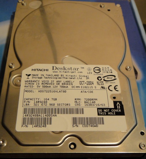

Manufacturer: Hitachi
Interface: IDE
Capacity: 164.7GB
Model: HDS722516VLAT80
P/N: 14R9248
Date: OCT-2004
MLC: BA1140
PCB STICKER:
0A30212 BA1036

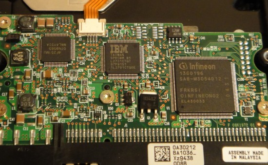

Did you transfer the adaptive info in NVRAM from the original PCB ?

hddgurudale wrote:
@hddguy: No; what is the process? I found this article; de-solder and re-solder?
nvram-chip-used-ibm-hitachi-hdd-and-the-countermeasure-t8262.html
Your donor PCB will be programmed to specifically work with the HDD it originates from. As a result it will not work with any other HDD as is.
there is much information in this forum relating to ROM / NVRAM transfer that will help you.

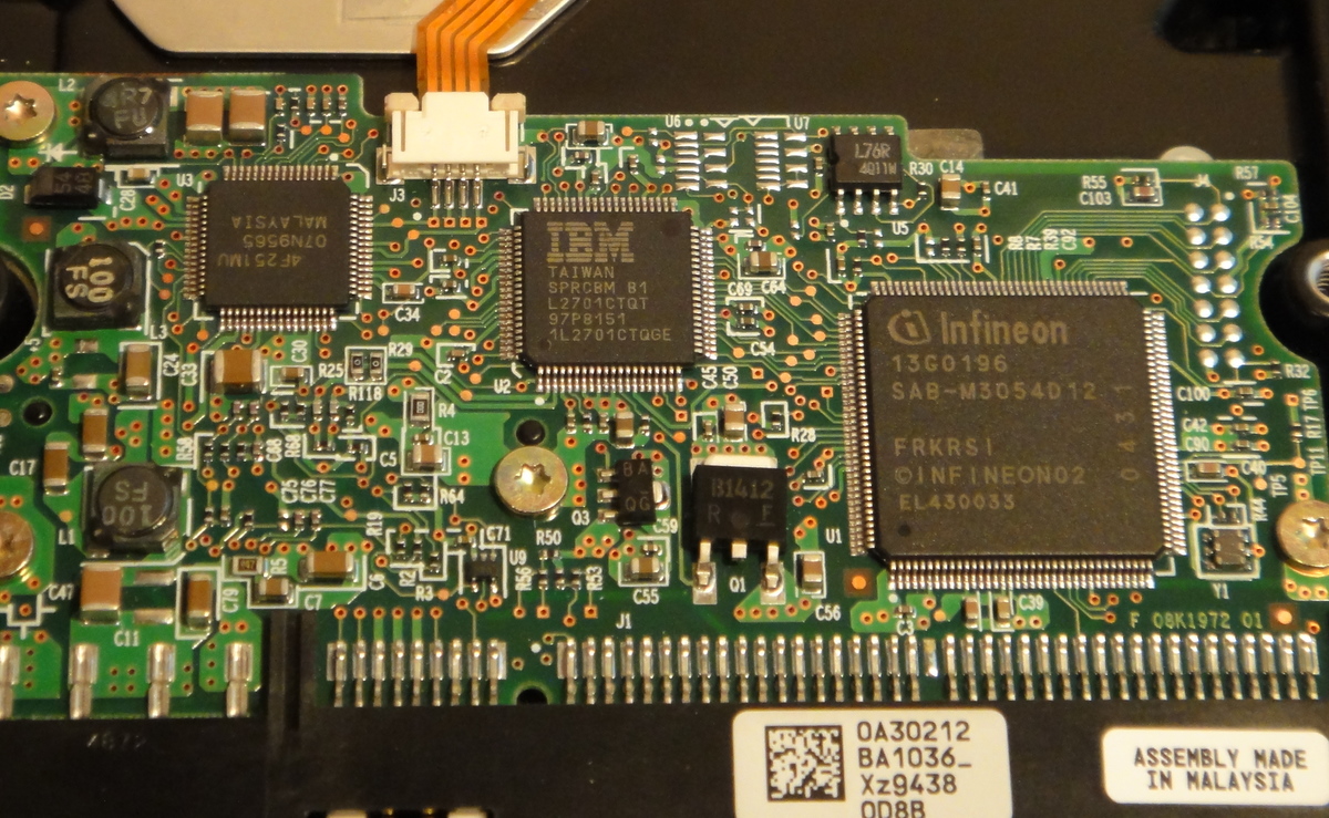

I understand and will try this later today on swapping the NVRAM. Please confirm it is L76R is the NVRAM and this is what needs swapped.

Wow, it was a 'long shot' but it worked! The system booted past the BIOS and into Windows before I knew if the hard drive was detected and it showed up in My Computer! Copied all my data over without issue. Thank you again!
