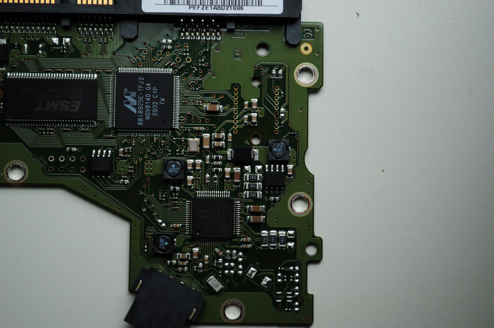

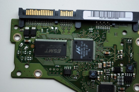

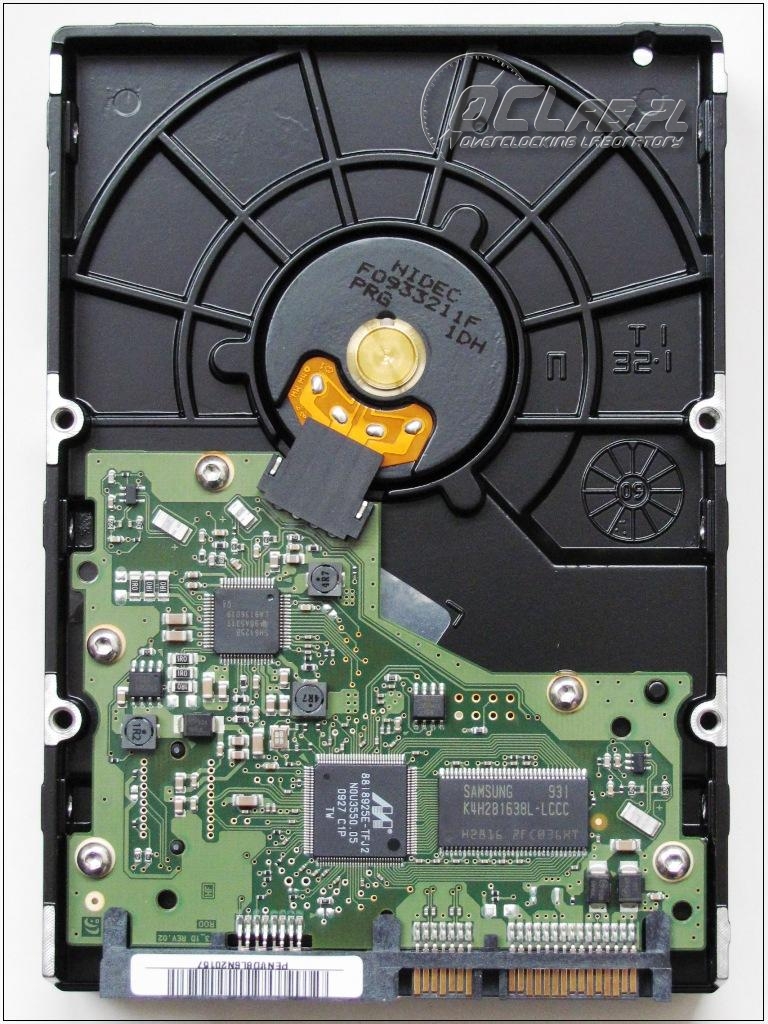

Are there any other components that i can test before i cut the TVS???

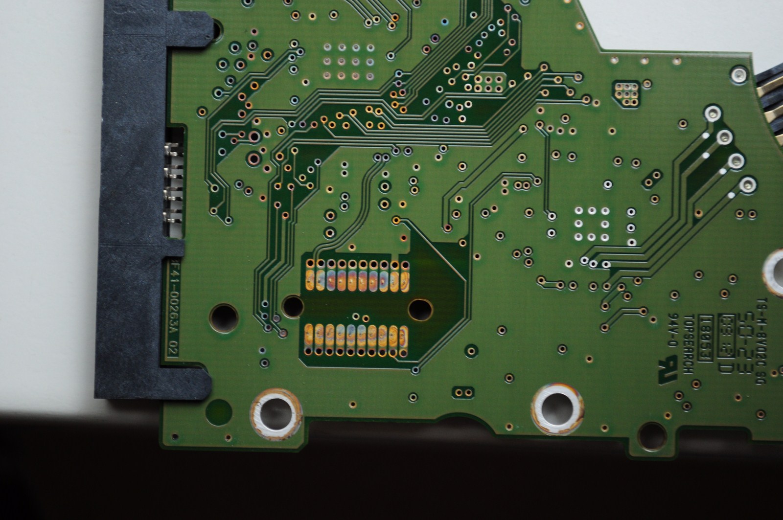

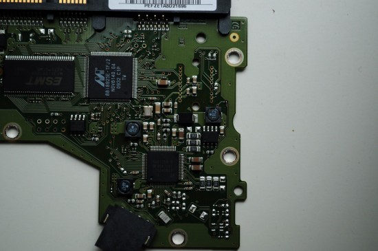

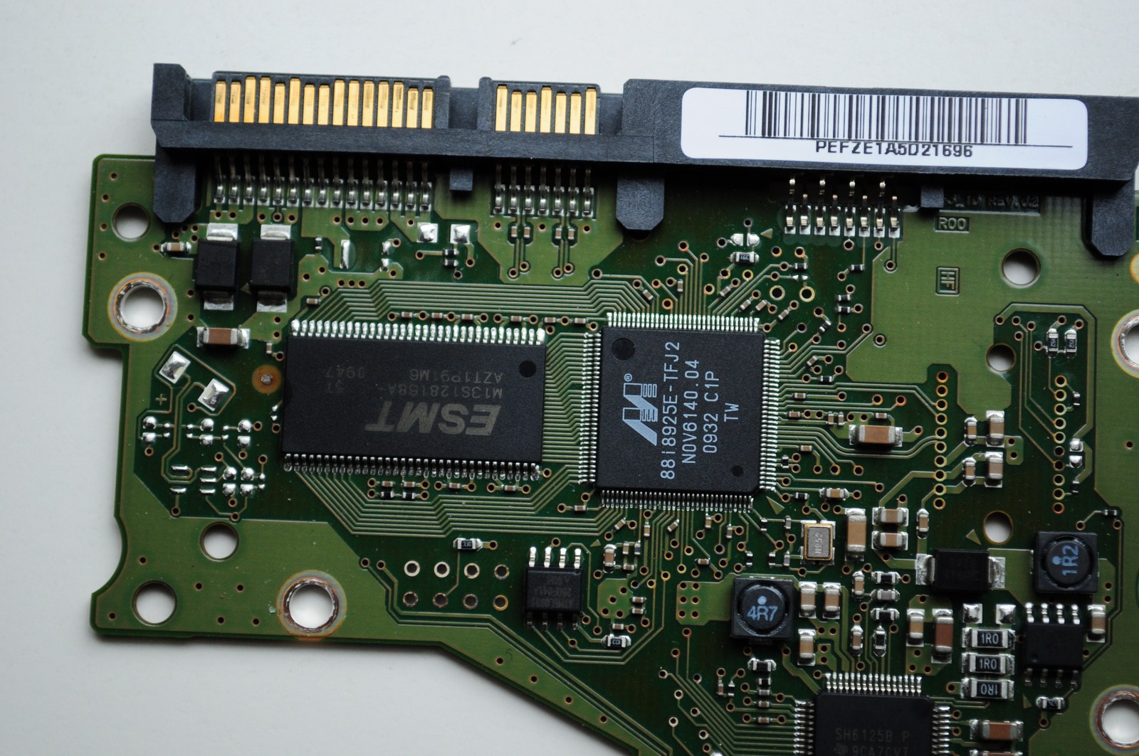

Here's the PCB

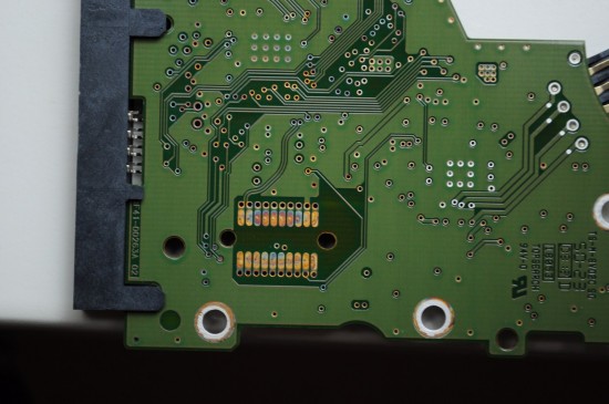

removed PCB to see the other side got some pictures too.
is this normal???

Damn, is there also an 000 ohm resistor on my PCB i can't see it. Or is it the small thing next to the 12V TVS?
 Post subject: Re: Samsung hd502hj
PostPosted: January 14th, 2011, 17:02
Posts: 17230
No, the diode appears to be connected directly to the +12V supply. The small component is a filter capacitor.
That said, if the diode were really shorted, then your PC's PSU would not have been able to power up. You would have seen the fans kick once, then the PSU would have shut down.
Which component did you actually remove? The 12V diode is the one nearest the mounting screw. The 5V TVS diode to the right of it has a small protection device in series with it. That could be a fuse. Measure its resistance.
If you wish to replace the board, then you will need to move the 8-pin Atmel serial flash chip (between SDRAM and Marvell MCU) from patient to donor. This chip stores unique, drive specific information.

how about the backside of the pcb, is that heat marking????
Or is it normal?

The reverse side of the PCB looks OK to me.
