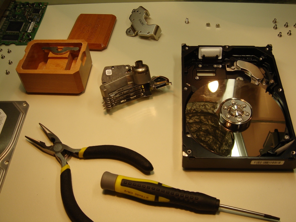

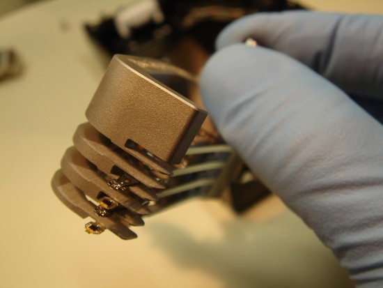

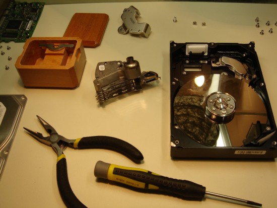

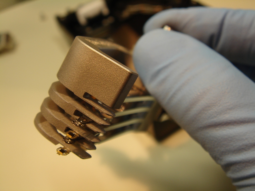

I've given it a trial run on a ST350823A I had in stock and it's a very impressive tool. On my first trial it worked 100%, got the heads out and then back in again without any fuss. After putting the drive back together I copied a 4GB ISO file off it to confirm all was well and it transferred perfectly, haven't got time to image the whole drive but I don't think it's necessary.
That was the Seagate tool I tried, I'll be giving the Samsung one a go on the weekend. Murphy's law says that the next drive I get in for a head swap will either be a 2.5" or a drive that isn't supported by the set of HDDSurgery tools I just got :lol:
