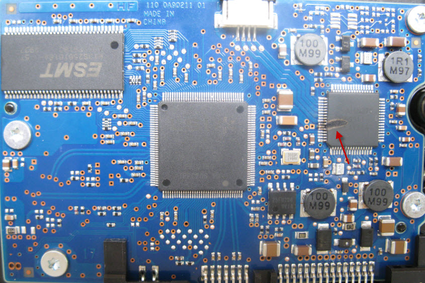

The HDD was pluged to a power supply that had inverted the polarity. This means the PCB recieved +12v in the ground pin. The small square chip with the following two engraved numbers
9J1NO7C
OA56511
show the problem
File comment: Red arrow shows the problem
 Post subject: Re: Need replacement PCB for Hitachi 1 TB
PostPosted: November 21st, 2010, 6:52
You will need a new PCB.
But you will also need to transfer the NVRAM and possibly the ROM chip too (if the donor PCB hasn't got the same version).
PostPosted: November 21st, 2010, 19:02
Posts: 17225
The 8-pin part at the bottom RH corner of the MCU appears to be a Sanyo LE25FW206 EEPROM. You need to transfer this component, or its contents, to your donor PCB. Your local TV/AV repair shop should be able to do this for you.
I believe pcimage is telling you to match the important numbers on the MCU (the largest chip) as well. Note that some numbers will be date codes or batch codes. Those aren't important.
PostPosted: November 24th, 2010, 0:50
Posts: 17225
The LE25FW206 is a flash memory device. The terms ROM, flash, EEPROM, EAROM, NVRAM are used / misused interchangeably, depending on the context.
In your case you definitely need to transfer the Sanyo part. As for the "ROM" chip, I don't know what pcimage is referring to. If the MCU is masked with ROM code that needs to be matched, then you need to compare the numbers on the large LSI chip. However, I suspect that pcimage is in error -- he may be thinking of an additional discrete 8-pin 93xx SPI EEPROM chip that was commonly used in earlier models. Your drive doesn't have such a chip.
The following may be a red herring, but this is what I make of the numbers on the MCU:
LSI --- manufactured by LSI Logic
MUSE-B2B2-NL --- manufacturer's part number
OA71256 --- Hitachi's internal p/n
0930CS --- YYWW date code, ie week 30 of 2009
PPC2759 --- ???
TPPC206 TH --- ??? made in THailand
The last two numbers are similar, but I don't know if they have any important meaning. They may refer to the internal ROM code. You could verify this by comparing two drives with the same factory firmware, or you could ask pcimage to clarify what he means. :?

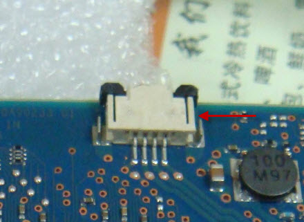

I need help on how to open the connector that goes to the motor so I can change the PCB
Thanks,
File comment: PCB board conection to disk motor
PostPosted: April 19th, 2011, 3:47
Posts: 17225
jorge wrote:
I need help on how to open the connector that goes to the motor so I can change the PCB.
It's a trade secret. :-)
Joking aside, just pull the two locking tabs away from the connector. That will release the flex cable.

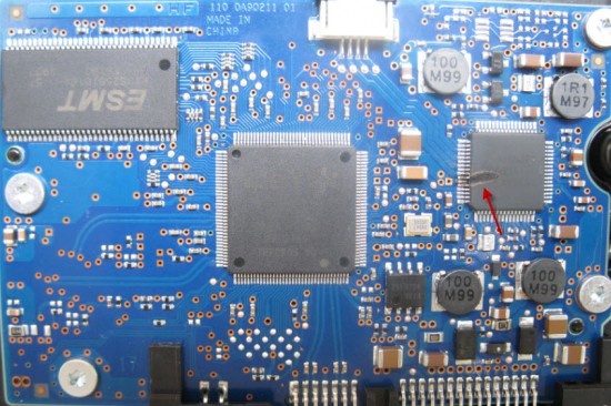

PostPosted: June 24th, 2011, 18:18
Posts: 17225
If you would like to repair the 500GB drive, then find a matching board and transfer the NVRAM chip at U5 to your donor PCB. Maybe you'll be lucky ...
FYI, U5 is located beneath the Samsung SDRAM at the left of this photo:
http://music24.kr/xe/files/attach/image ... 20copy.jpg
That said, I don't know how similar your 500GB and 1TB boards are. The LSI MCU contains some flash code, so you will need to determine if there are differences that will affect the interchangeability of the boards. AIUI, a straight board swap is not always safe on Hitachis because of the potential for NVRAM overwrite.
BTW, does the motor controller (OA56511) get hot even if the board is disconnected from the drive?
PostPosted: June 29th, 2011, 17:57
Joined: June 24th, 2011, 11:58
Location: Republika Srpska
Sorry for the late reply...
Yep, the board on the picture is EXACTLY the same as the one on my 1TB drive, down to a resistor. Same LSI MCU as well. Any chance you have the dump for it?
And NO, the motor controller does NOT get hot when the board is disconnected from the drive, on 500GB one. Actually, when connected, you can hear constant and rhythmic sound of heads trying to find start position (or at least I think so). What does it mean? The chip itself is ok?
