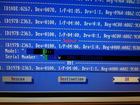

Clicks couple times, looks like its going to ID then...
any ideas
cheers
andy
File comment: seen this?

Did the customer provide any information about symptoms prior to failure? Or dropped or anything like that?
 Post subject: Re: Old Toshiba MK4313MAT 4327MB
PostPosted: July 6th, 2011, 6:26
Posts: 248
said it just failed, Im dubious.
Some minor stiction but it spins up fine now
PostPosted: July 6th, 2011, 6:28
So, it IDs correctly now?
PostPosted: July 6th, 2011, 6:30
Posts: 248
nope, this is as far as it gets just now after spinning up and clicking
PostPosted: July 6th, 2011, 6:32
Posts: 248
p.s ddi wont boot when its plugged in as source. you need to plug it in after it finds destination
PostPosted: July 6th, 2011, 6:33
Damaged head(s)?
PostPosted: July 6th, 2011, 6:36
Posts: 248
possibly yes, just strange ddi screen. very pretty colours, its now pink and green :)
PostPosted: July 6th, 2011, 10:05
Posts: 3235
Location: USA
Hah... have you sent this to the Deepspar guys? I bet they would be interested in seeing it.
Seems like the drive is returning some garbage when IDed. You could probably get some insight as to what is happening by manually examining the ID info it returns.
PostPosted: July 6th, 2011, 10:47
Posts: 248
will send serge a pic :)
PostPosted: July 6th, 2011, 18:07
What does it do when running MHDD? Is it displaying strange characters again?
