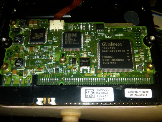

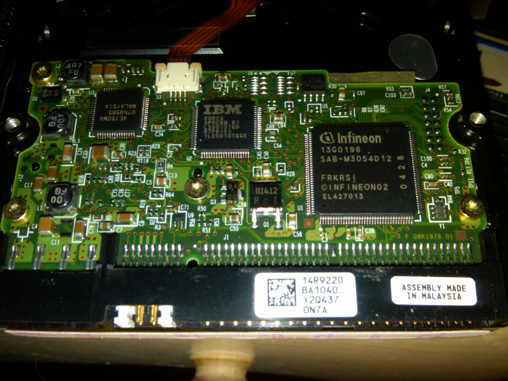

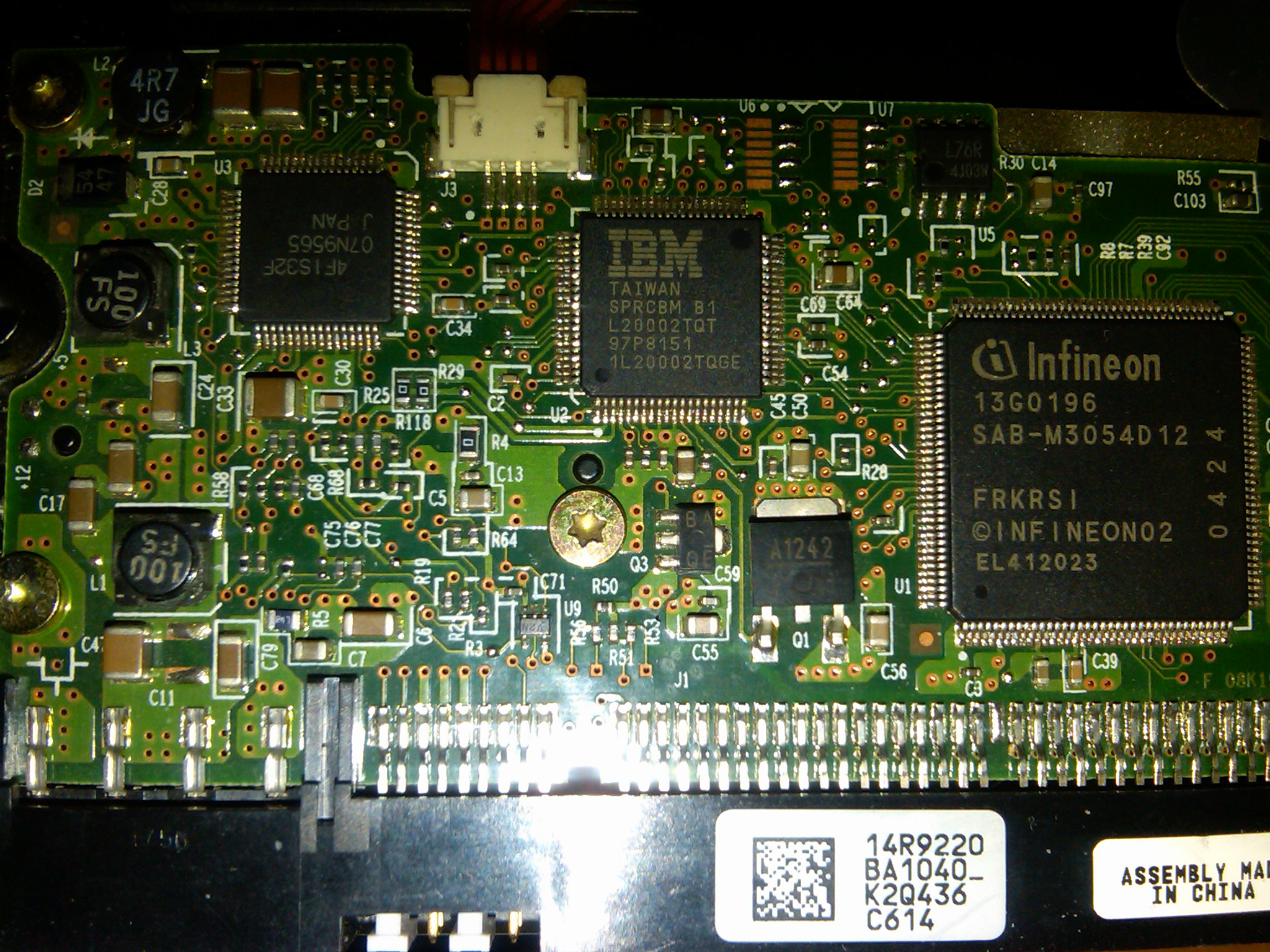

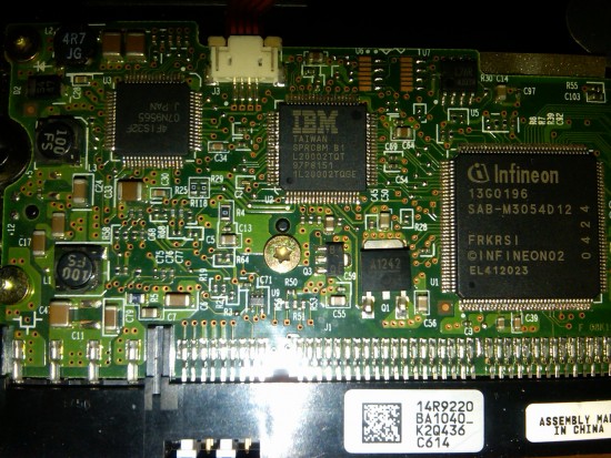

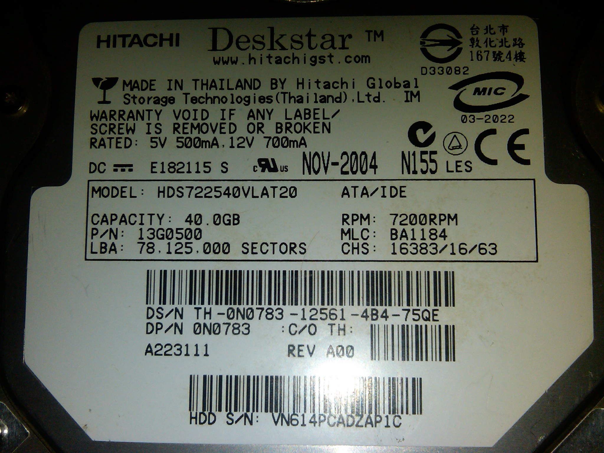

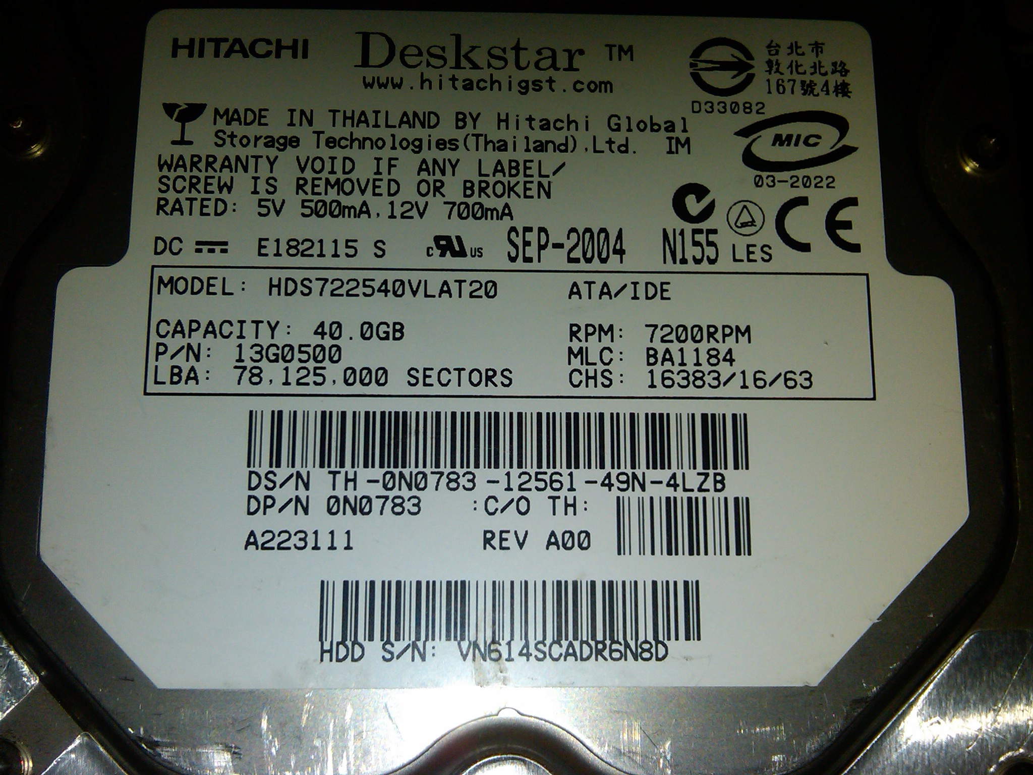

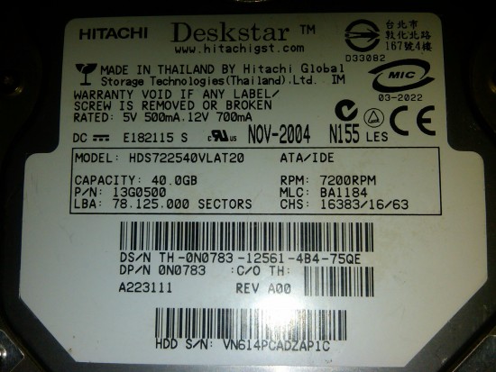

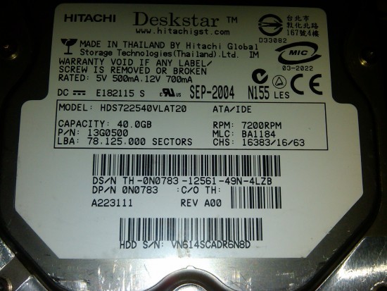

A friend let her son monkey with her computer and what he managed to do is somehow knock one of the surface mounted chips off of the Dell (Hitachi) hard drive. The end result is that the drive no longer spins. I located a very close match to the hard drive on eBay (the month of manufacture was two off, but everything else matched but the s/n) and after testing that the drive worked, moved that controller to the damaged HD. Drive is now spinning, but doesn't recognize the file system. (I'm sure this is no surprise to the gurus on this board.)

Can you take good resolution pictures of the controller boards on the side with the chips and post here.

Sorry for the delay. Had to work out the photo process to post them here. I've given you pics of the drive label (top) and the PCB side (bottom) of both the old and the new (donor) drive.

 Post subject: Re: MHDD Help?
PostPosted: July 7th, 2011, 14:50
What makes you think that a surface mount chip was knocked off? Were there some loose near the computer or something?
I may not see clearly, but I do not see any chip missing? Maybe you can mark it off in Paint application or SnagIt?
Either way, if unable to get the "bad" PCB to work, it seems you will need to solder the U5 chip, NV-RAM, to the donor board, because it has adaptive info for that particular drive.
