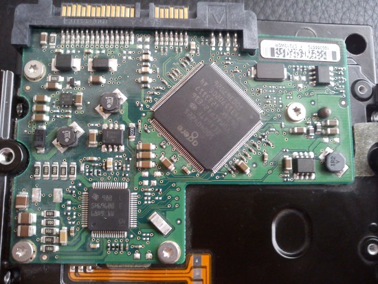

 Post subject: Re: SEAGATE 7200.9 400GB
PostPosted: June 25th, 2011, 5:27
Posts: 17228
You can possibly repair your board at no cost, if the problem is only a shorted TVS diode.
Otherwise you can purchase a PCB for US$40 plus $10 for a "ROM" transfer:
http://www.onepcbsolution.com/st3400633 ... 67049.html
The TVS diodes are the two black components to the left and below the mounting screw in the top right corner of this photo:
http://ep.yimg.com/ca/I/yhst-4446369223 ... 62_2166755
That said, this will still leave you with the original fault.

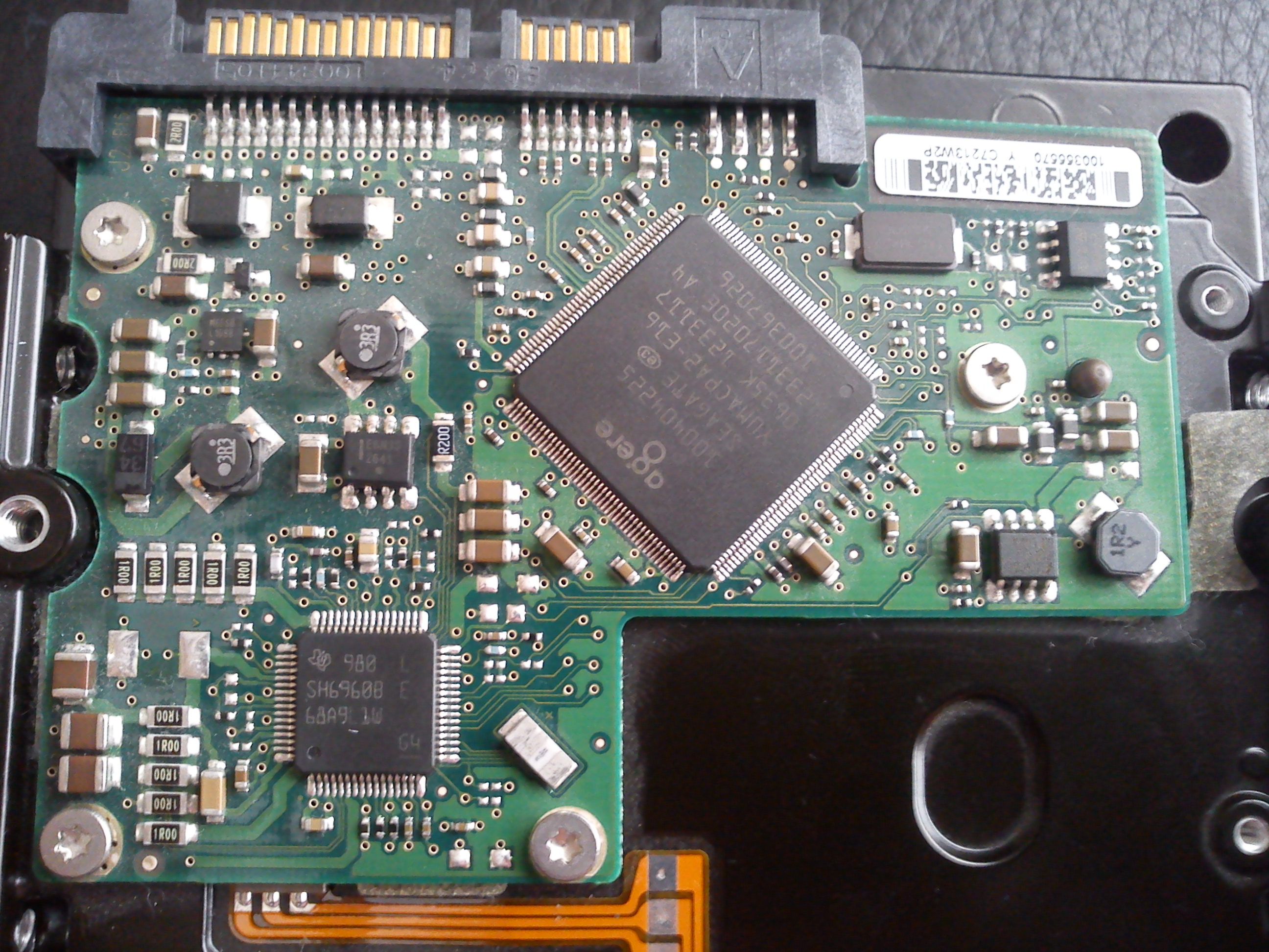

PostPosted: July 1st, 2011, 11:42
Joined: June 16th, 2011, 11:05
Posts: 7
Here is a pic of the pcb
cheers for your help guys :)

You need to check the resistance of the two components in the attached photo clip.
PostPosted: July 1st, 2011, 20:48
Posts: 17228
The TVS diodes usually fail by going short circuit. If either measures close to 0 ohms, then it is shorted. Otherwise its resistance will depend on whatever else is connected to the same supply.

Hi guys how to i do about moving the ROM ???
PostPosted: July 9th, 2011, 22:40
Posts: 17228
I believe the "ROM" is the 8-pin serial flash memory chip in the top right corner of your photo. It should have a "25" in its part number.
Your board supplier should be able to transfer it, or its contents, to your donor PCB. Otherwise, if you are unable to do your own soldering, then ask your local TV repair shop to do it for you.
