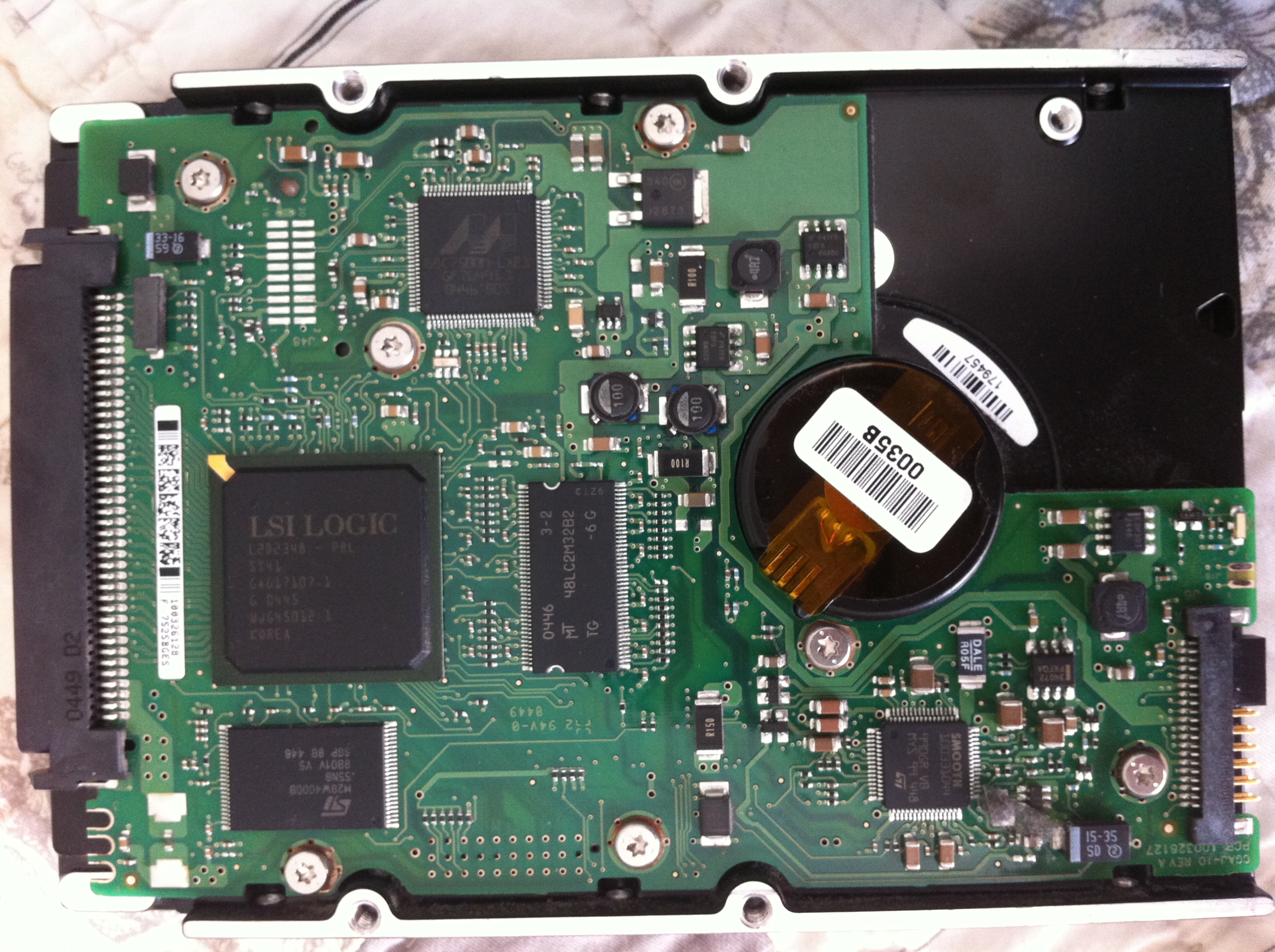

Had no power on a SCSI 246 gig ( seagate ) model st31500341. It has the 80 pin port with no jumpers.
Swapped the rom to donr, and now powers, but no id.
Anyone with the skill to help troubleshoot patient or ... ?
Please pm if possible, it is easier for me.

sure you exchanged the EEPROM ? Any pic?

Positive, m29 large

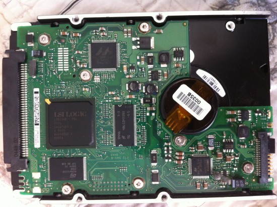

"st31500341" is an incomplete model number, ie it has no interface suffix. Moreover, the "1500" indicates that the drive has a 1.5TB capacity. Furthermore, the YYWW date codes (0446, 0445, 446, 448) on the ICs indicate that the drive was manufactured during late 2004, which is well before such capacities appeared in the marketplace. My Google searches for the PCB # (100326127) turned up a model number of ST336807LC, which is a 36GB drive. There is 146GB Cheetah 10K.7, but I can't find any mention of a 246GB model. I suspect that you in fact have an ST3146707LC.
Now that we have that out of the way, I would start by measuring the voltages in the following photo clips:
http://www.users.on.net/~fzabkar/HDD/ST3146707LC/
You have a good board for comparison purposes, so I would measure its voltages before working on the patient. I presume you have backed up the flash memory.
I can't see the markings (eg FDFSxxxx) on many of the components, so I may be wrong in some of my interpretations. To this end, it would help me if you could provide those numbers.
FYI, the cable pinouts are on pages 76 and 77 of the manual.

You are correct on the model error. I was leaving on vacation and quickly grabbed the wrong mode. The correct model is BD14688278. However, we did check the obvious tvs issues. There is one larger chip (marked with a question mark in your pic) that may be a diode between the two tvs chips that don't provide a reading. We compared the boards, but saw no anomaly.
Because we don't have the adapter for this unusual flash, we could not back it up.
Also, you mentioned, "I can't see the markings (eg FDFSxxxx) on many of the components." Are you referring to the cpu or a particular small chip?

I can only help you with the electronics aspect of your problem.
To this end I need to see the results of your voltage measurements.
The FDFSxxxxx chips are those 8-pin ICs that form part of the DC-DC converters. They would probably be FETKYs. If you can read off their markings, that would help me.
I don't know what you mean by "diode between the two tvs chips". To which photo clip are you referring? Is it this one?
http://www.users.on.net/~fzabkar/HDD/ST ... e_fuse.jpg
The item I have queried as a possible fuse may in fact be an inductor. The component above it is a 33uF 16V capacitor. The two components may form an LC low pass filter. Either way, the fuse/inductor should measure close to 0 ohms. Can you tell me the marking on the diode?
