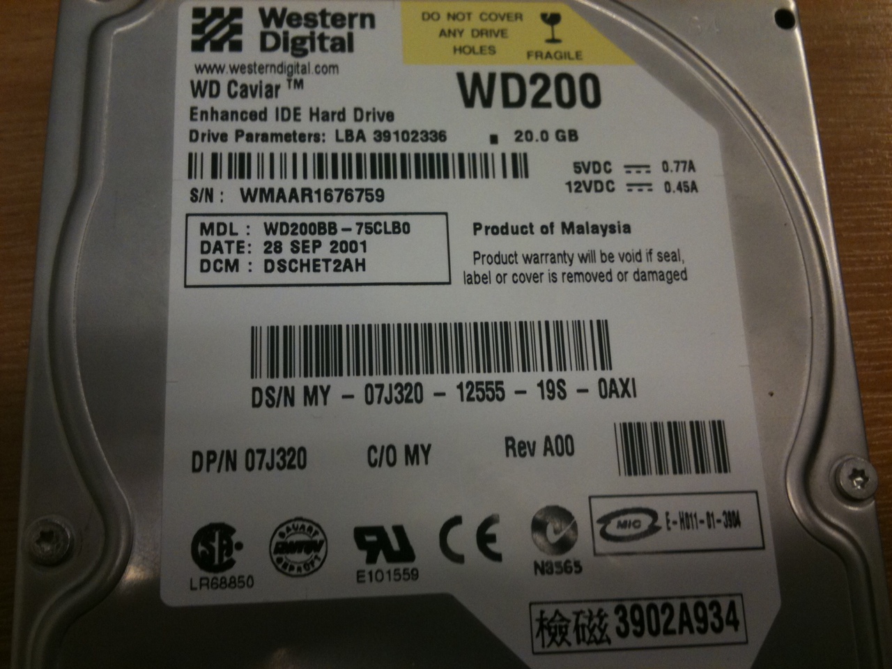

 Post subject: Dead WD200 20GB
PostPosted: July 15th, 2011, 11:27
Posts: 248
Wont fire up, PCB is getting hot
TVS?
ta

 Post subject: Re: Dead WD200 20GB
PostPosted: July 15th, 2011, 12:55
Posts: 872
Location: Dublin
Doubt it. New PCB + U12 swap.
PostPosted: July 15th, 2011, 13:20
Joined: June 8th, 2006, 19:44
Posts: 3144
Location: Atlanta, GA
If the little components BENEATH the motor IC are too hot to touch, then it probably has a bad preamp, too.
The motor IC will get pretty warm normally.
PostPosted: July 15th, 2011, 13:57
What model exactly?
PostPosted: July 16th, 2011, 4:43
Posts: 17211
TVS?
ta
Andy
A shorted TVS diode will shut down the power supply, therefore nothing will get hot.
PostPosted: July 16th, 2011, 5:33
Posts: 248
Helpful, thanks guys

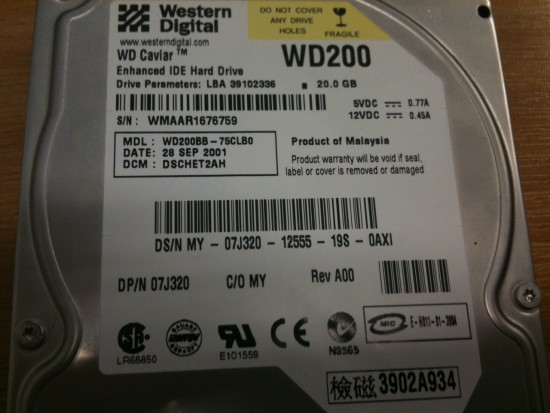

this one sean ;)
andy
PostPosted: August 1st, 2011, 5:01
Posts: 248
The donor I have is Same MDL but the DCM is DSBHET2CH
Would this donor suffice provided the U12 is swapped ?
thanks
PostPosted: August 1st, 2011, 5:13
Joined: August 28th, 2010, 17:03
Posts: 5
Location: New Zealand
You will need to check the PCB part number and see if they match.
PostPosted: August 1st, 2011, 5:15
Posts: 248
thanks
PostPosted: August 1st, 2011, 5:19
Posts: 2984
Yes, this will be ok,
