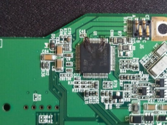

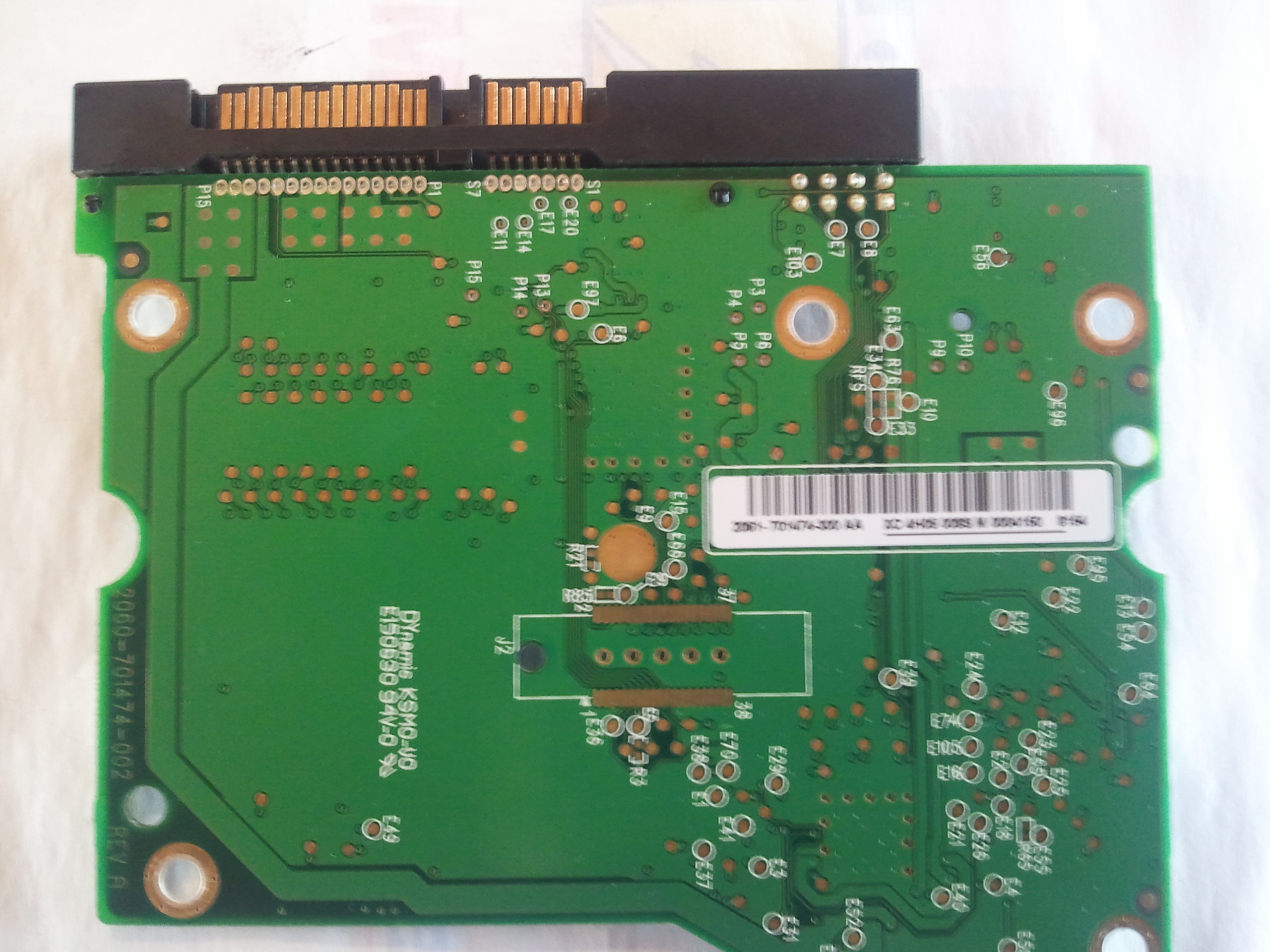

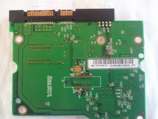

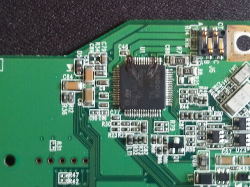

it wnt power up. it kinda clicks onnce when power is connected thats it. ill upload picture of pcb.

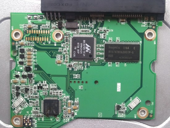

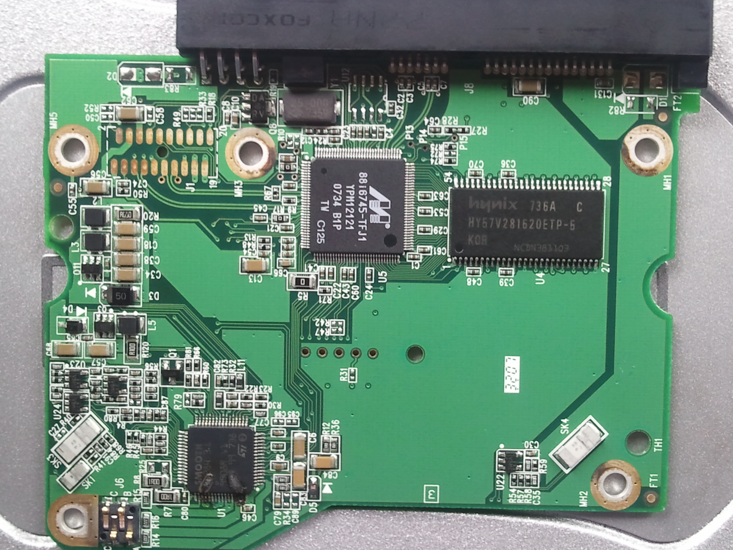

Post a better picture of the component side of the PCB please, one that shows it all.

The motor controller chip (SMOOTH) on the PCB is damaged. You would need a replacement PCB if the the PCB is the only damaged component, ie none of the internals of the drive were damaged, like the preamp for example.
As far as I remember and could be wrong, but I think the 2060-701474-002 board does not have a ROM chip at U12. You need to move the adaptive data when you use a replacement PCB and they are normally found at U12 on an 8-pin ROM chip, but if this PCB does not have a chip at U12 then that adaptive information is stored in the main controller chip, the one with the big 'M' on it. You need professional equipment to move that adaptive data.
If the PCB is the only fault then a decent DR company shouldn't charge you and arm and a leg for that kind of job.

i guess this PCB w/o ROM chip, and ur smooth chip is burned.
you may need a Pro. in Soldering/De-soldering to replace the burned Smooth chip
or
Donor PCB + ROM Programming (match) and hope your done after that

better pic sorry im driving now drives at work

U12 is indeed vacant. Do as suggested, contact Jono-ats, he is in Atlanta.
