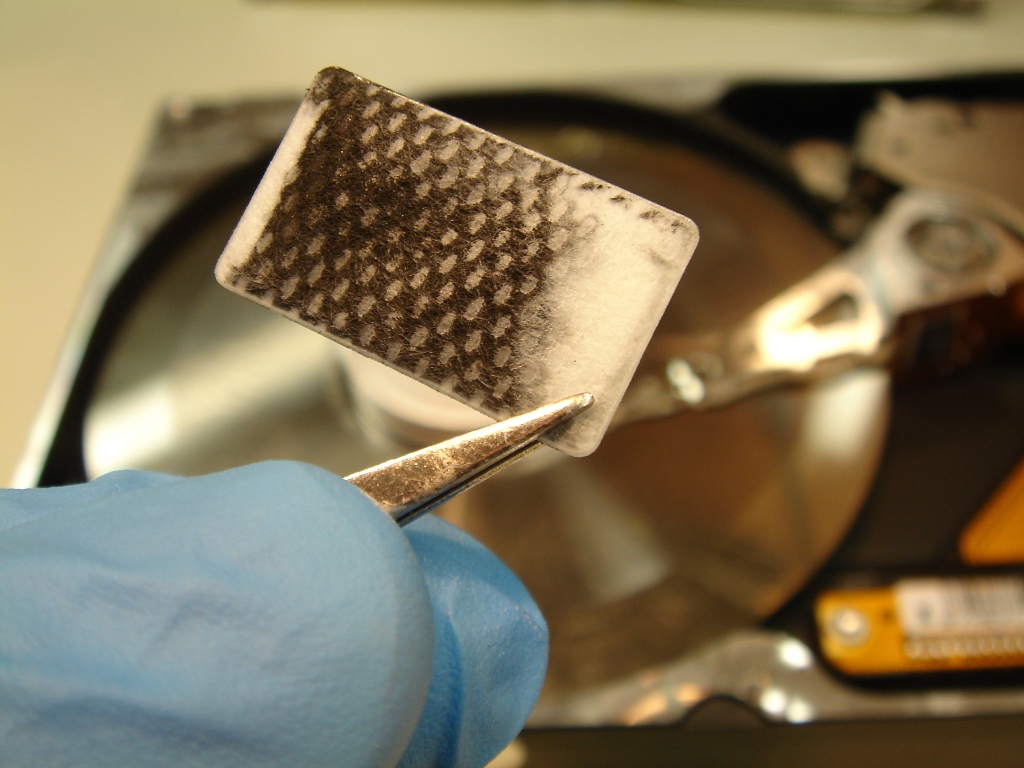

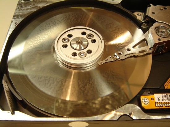

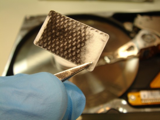

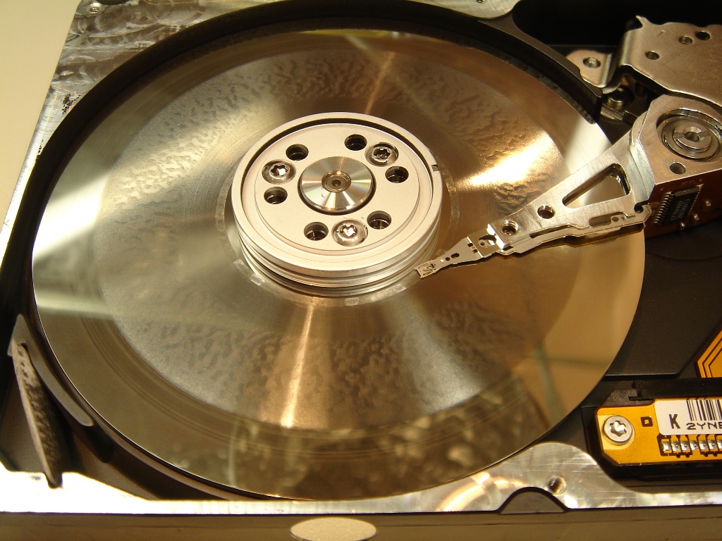

I haven't had many old Maxtors come in. Got a 60GB in today that was sounding really rough as it spun up, heads hitting the limiter.
Turns out the platter is in a very bad way. The filter if full of ex-platter dust. I've not seen a platter in this state before. Heat damage from ongoing head contact?

Common on these models in my experience. Head crash and left powered on for some time.

Thought as much :cry:

Or drive crashed overnight and left unattended...
